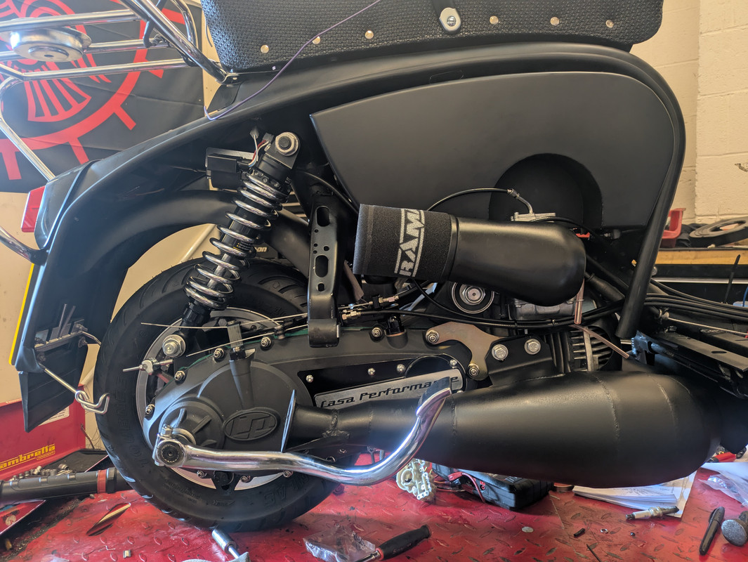

Fat Mamba exhaust, with modified stinger (ID of 30mm) to clear the extras gasses that will be created.
Mikuni TMX 30mm with a modified bell mouth to match the ProPorting elbow.
Re: RB270 Project
Postby dickie » Tue Sep 02, 2025 9:15 pm
I heard those ramair filters are much more restrictive than breathe sweet and casa powerflow.
Ive no personal hard facts. Do you know?
Re: RB270 Project
Postby Solid Air » Tue Sep 02, 2025 9:54 pm
I have used Ramair filters for years and never had any problems with them, haven't used the others so can't compare I'm afraid.

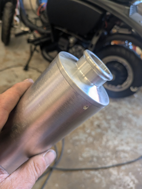

Postby Solid Air » Sun Sep 07, 2025 7:38 pm
The Fat Mamba exhaust is now sorted with its new 30mm ID stinger section. The tail pipe has a bespoke outlet, made by my best mate Viv of Raven Motorcycles, a larger baffle tube has been made, courtesy of Mick Abbey, and the silencer casing just needs finishing off to mount it onto the exhaust.
Sadly we ran out of time as we had to get to Teesside for the BSEC race (where we took second place in race class ;) ) so the carb set-up and dyno will have to be done another day. In the meantime time, the engine has been started with a temporary standard tailpipe, and sounds great! I am going to get the bodywork fitted so that the dyno session will be the last thing to do before Small Hours is finished.

Postby dickie » Mon Sep 08, 2025 10:03 pm
Great thinking to not just buy a regular pipe. I wonder how much louder a 30mm silencer will be?
Re: RB270 Project
Postby Solid Air » Tue Sep 09, 2025 11:45 am
Not modifying the stinger on any exhaust for this engine would be asking for trouble, with the gas build up and the extra heat made from that. Going by the information available 30mm ID should do the job, fingers crossed. Time will tell regarding the noise level.

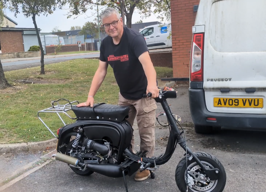

Postby Solid Air » Tue Oct 21, 2025 1:22 pm
The engine build is now complete, I just need to finish the rest of the jobs done to finish the job :D
Dyno day up at Raven Motorcycles near Darlington yesterday, and very productive it was too. Once it's all built, I will get a few running-in miles done then head back up north for fine tuning and step-testing.
At peak power, between 6,500-7,000 revs, the numbers are 26 bhp and 21ft/lb of torque.
It would have been possible to have tuned the barrel to get the numbers a lot higher, but it was a grunty touring engine that I was after. It has been built for a purpose, and to my requirements. I also wanted to be able to use a bigger than standard crank to reduce the risk of twisting. The Casa Case allows this and we have actually used a 70x120 item, this gives the higher cc while still only using a 70mm piston. The bore and stroke are intentionally square and the state of tune has been kept purposely low for our requirements. This will all hopefully give me a good level of reliability too.
Cheers, Mark
