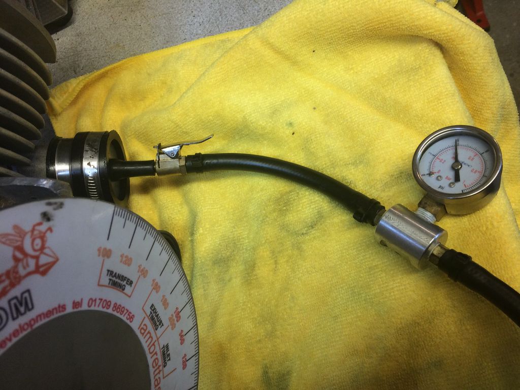

Pressure test from Saturday.
If you do use a pressure test kit (leak test kit) always position the piston towards BDC.

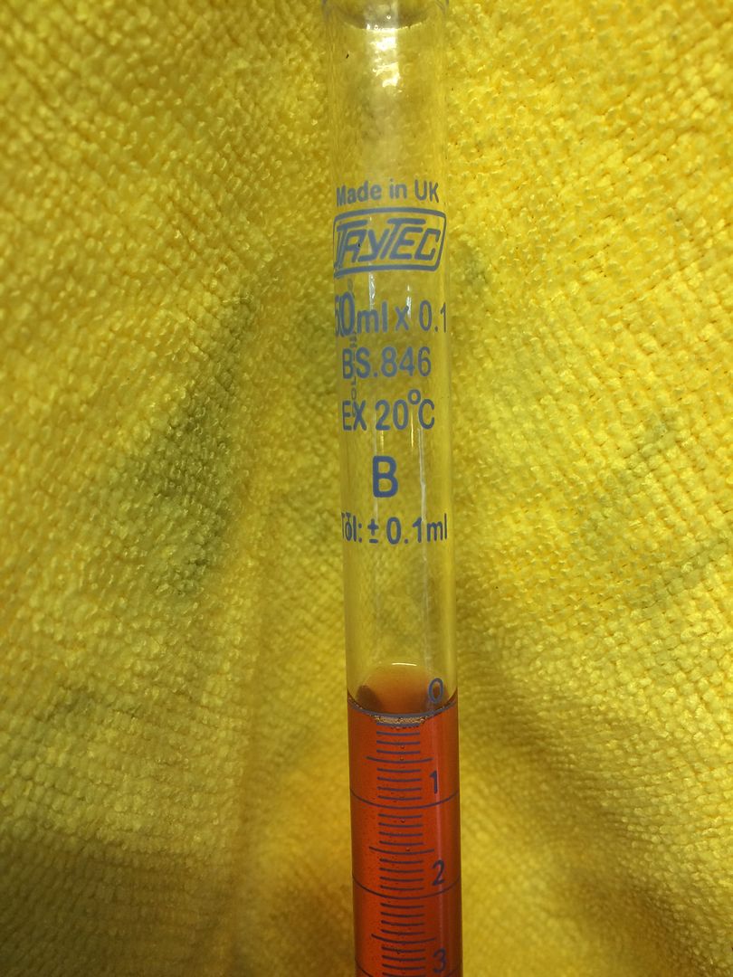

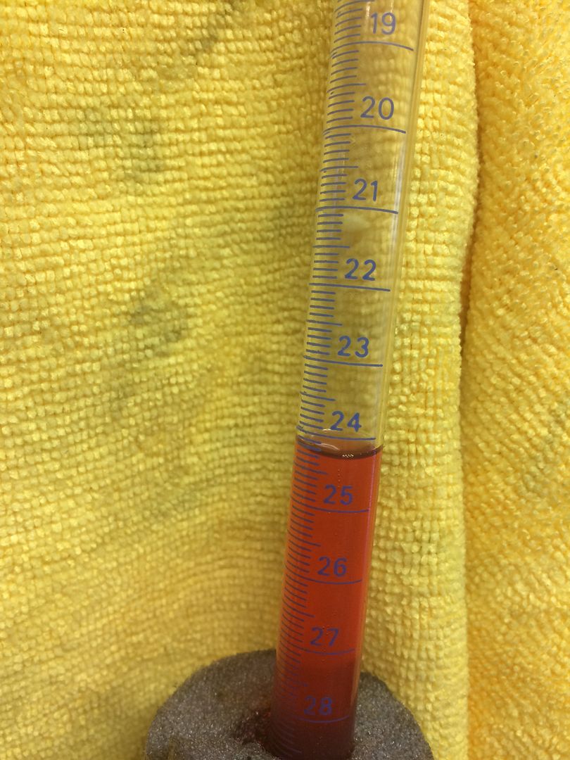

I buretted the head, with the top end assembled and oil petrol 60/40 fed in through the spark plug hole piston at TDC.
This is a very accurate way to check the trapped volume and from that work out the compression ratio.
A volume of 24.2cc gives a slightly higher compression ratio than I had hoped for.

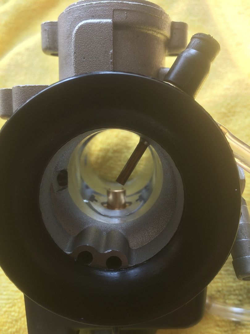

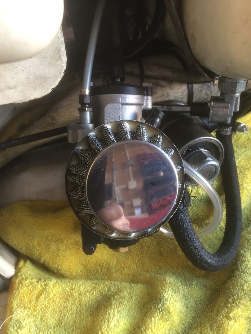

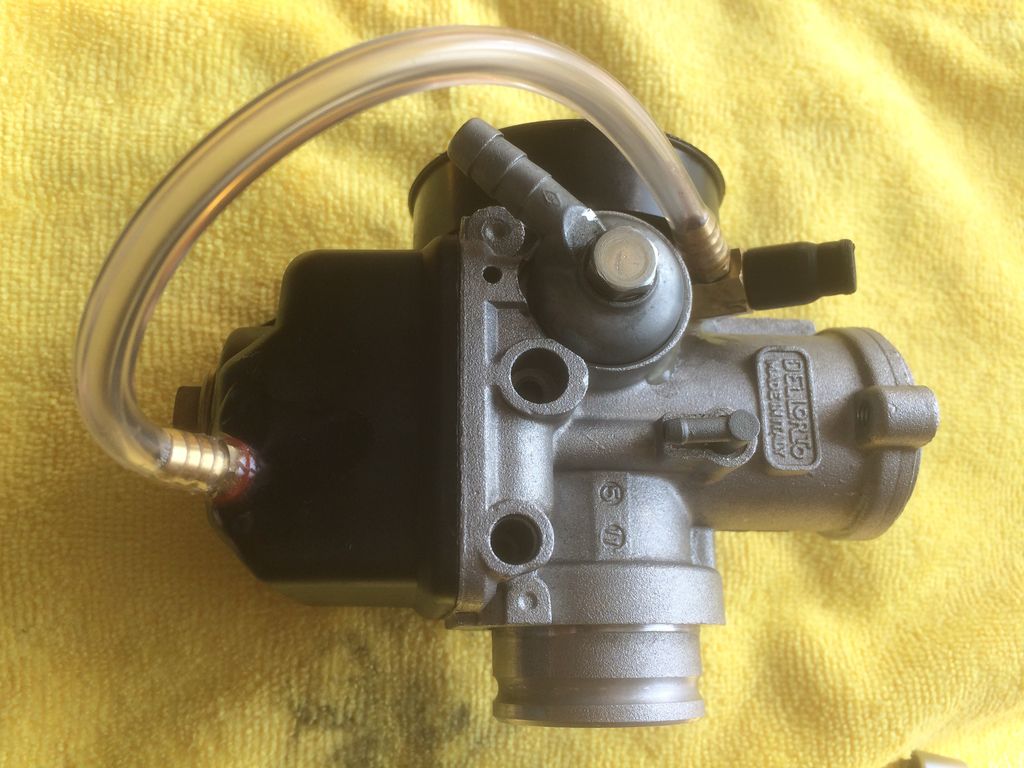

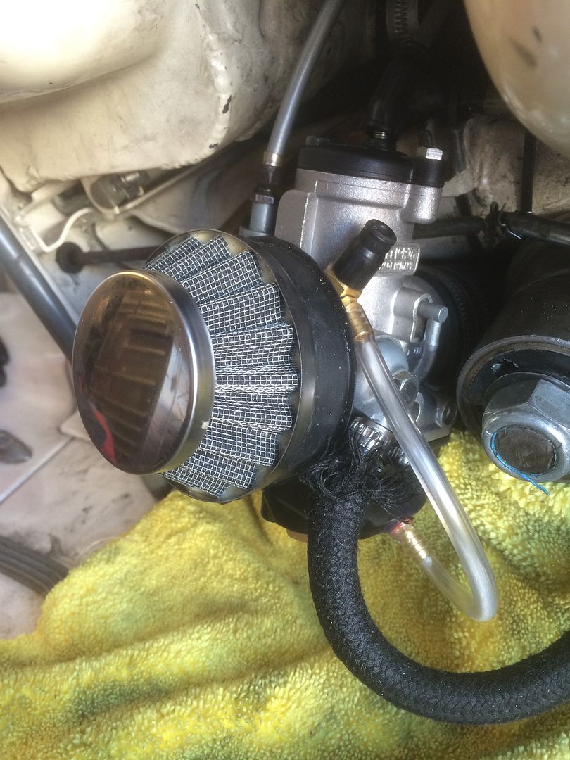

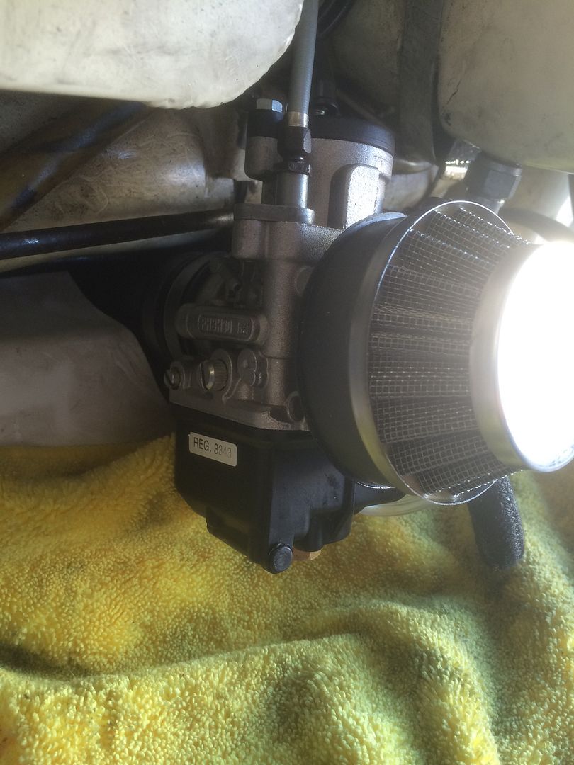

Yesterday I had a power-jet kit fitted to the Dellorto PHBH30, what's needed now Is to dial in the jetting a little, I've left the power jet tube long so it sits mid of the carb inlet, I'm hoping it gets drawn on earlier, this is so that when I'm closing the throttle coming off power there should be more enrichment as the air speed over the tube should be greater than it would if it was shorter and higher up in the airstream.
Here's a few pics, sorry I never took any photos as the power jet assembly was being assembled and fitted.
A couple of pics showing how it sits on the scooter.
Big thanks go to Davet from this forum as it was him who built up the power jet kit and helped me fit it to the carb.
If anyone is interested in the Air filter that's on the carb, I can't really say much about it other than its very small and it fits onto the plastic bell-mouth and seems to be fairly free breathing, I will give some feedback later after I've done a few more miles.
This air filter may just fit under the panel on some Lambretta's, but it's going to be very very close.
Mark.
:oops: Oops!!! Though I had include this photo already. Showing the position and length of the power jet tube.
Better late than never

That air filter is very compact. If it flows well, that is quite a ‘find’ that hopefully can be shared….With a shortened manifold (to the maximum!) it may just clear the panel.
Is the power jet anything different to the norm, i.e Mikuni?
It appears to be just reliant on venturi vacuum, which is fine, rather than solenoid activated, which tend to vibrate to bits on a Lambretta engine.
It will be good to see how this all progresses.

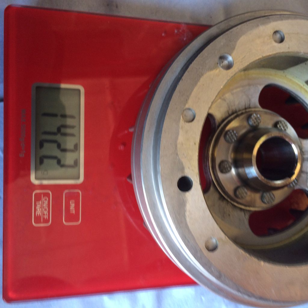

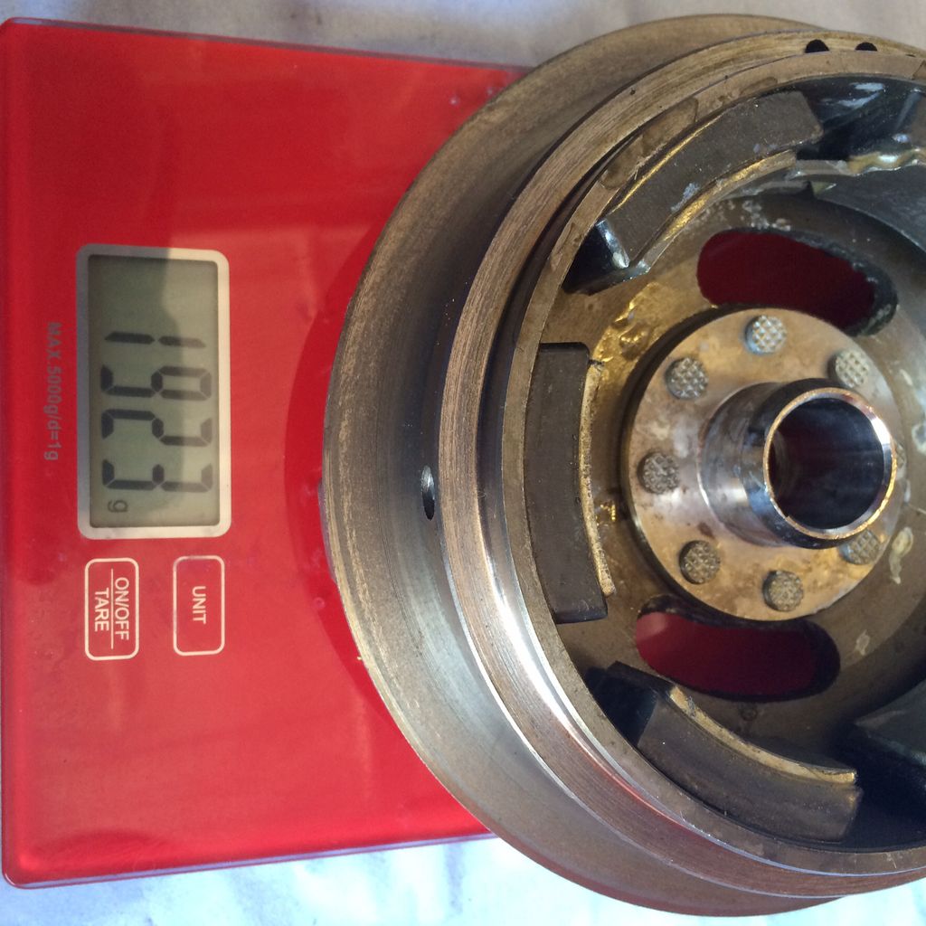

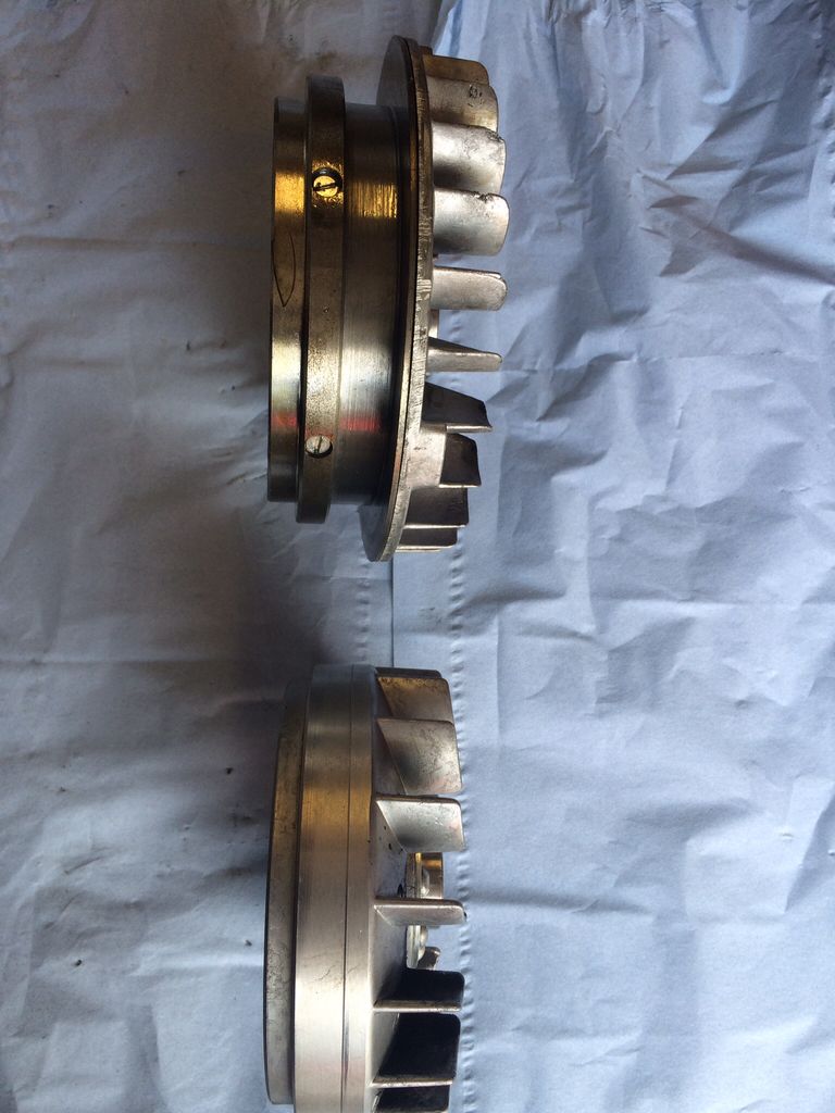

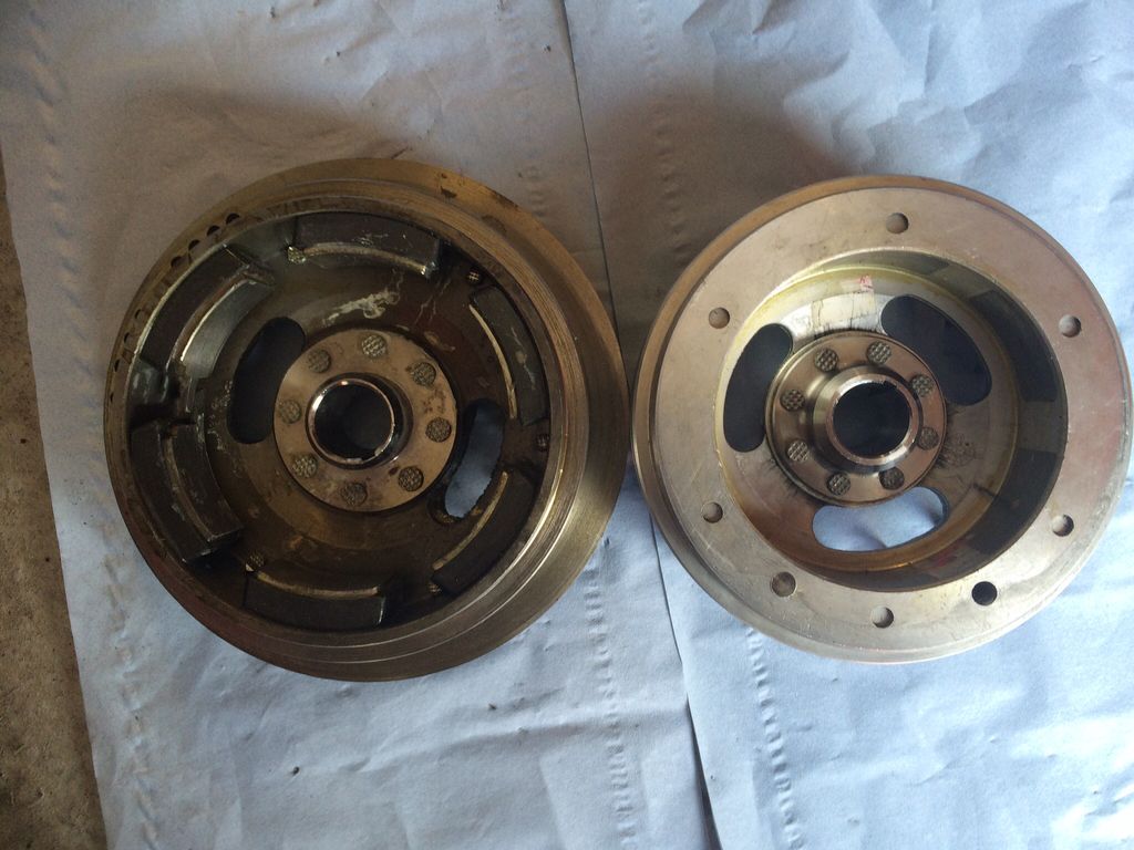

I changed the flywheel from the AF light alloy flywheel to a machined mid weight SIL flywheel.
Here's a couple of pictures to help show the difference between them.
The larger and heavier (mid-weight machined) SIL flywheel weighs in at 1923g compared with the smaller lighter alloy AF flywheel at 1422g
There's only around 500g difference, that's about 1Lb in old money but I can instantly feel the difference between the two.
The heavier SIL has helped with the bottom end power delivery in first gear that's as I release the clutch and move off from a standstill. Now there's much more initial response and the tickover is much more even and slower than before there's also more engine breaking as I change down between gears.
But all that's come at the cost of midrange power delivery, before it was much more responsive as it came onto the pipe, but overall the Avanti seems to be an easier ride with the mid-weight flywheel.
A standard SIL flywheel weighs in at around 2500g or 2.5 kilos that's close to 6 Lb.
