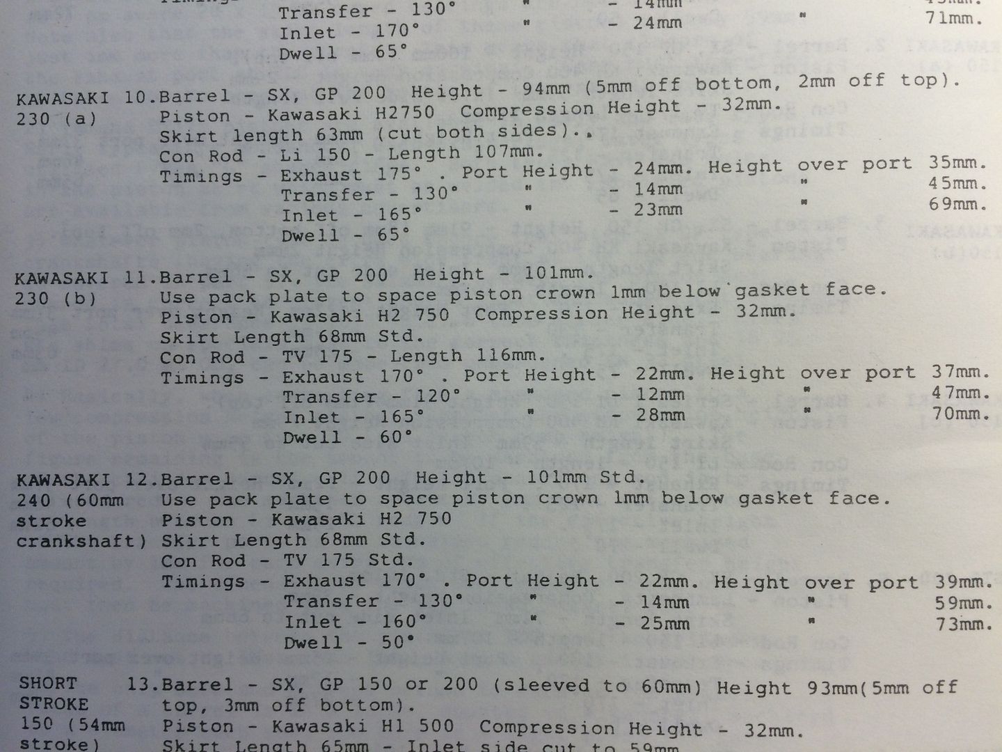

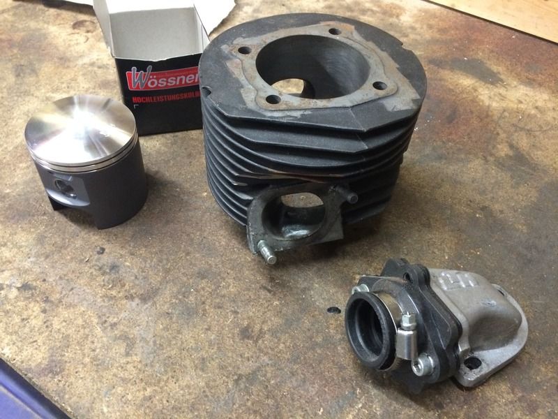

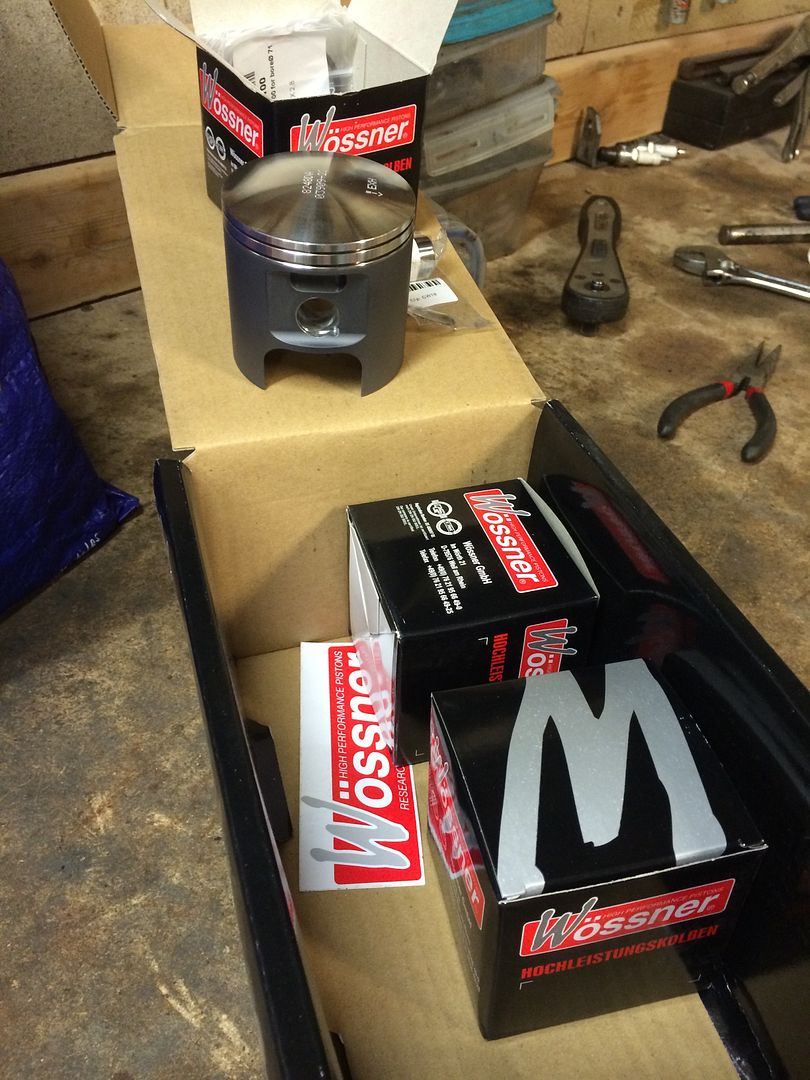

Just to bring this back up, received my Wossner pistons ready for my Kwak conversion.
Barrel taken out to 71mm to suit
As my barrel been shortened to 94mm for the 230 conversion a la Dave Websters book, I need to mock up the top end with crank to set transfers and work out what size packer I ideally require for 247cc with 62/116 rod. Thankfully Adam has a motor sat waiting to mock up with for starters. It'll only really be a starting point as this top end will be going on a SIL 200 casing which could obviously differ from Adams casing. Can't remember if previously put this pic up...

What is the compression and the skirt height of the Wossner piston?
I think that it won't be 'easy' to fit a 62/116 on a shortened 94mm barrel,
did the 230 conversion use a standard crank?

Bit of progress on mine this week. Finally managed to arrange a time that was convenient for both of us (it's taken a year!) to pop over to Adam W's house armed with barrel, piston kit, reed valve and assorted packers to suss out port timings for my EBay unknown shortened to 94mm barrel. He has an empty case and 62/116 crank to hand, coupled with his 'little black book' and knowledge we set about it.
The upshot after a couple of hours tinkering with various combinations of packers and base gaskets, with no need for further Dremel work is...
62/116 crank
8.5 maybe 9mm base packer required. Dependant on building up on my Injun case.
Transfers 128'
Exhaust 185'
Inlet 200' power ported arc on skirt.
Piston crown is exposed at TDC by about a mil but were going to look at that when I build up on my cases. Maybe make that up with a gasket, or my preferred method would be to recess the head and then set the compression/squish etc.
Pretty chuffed so far that the barrel is very useable in its current state. Build pics to follow...
