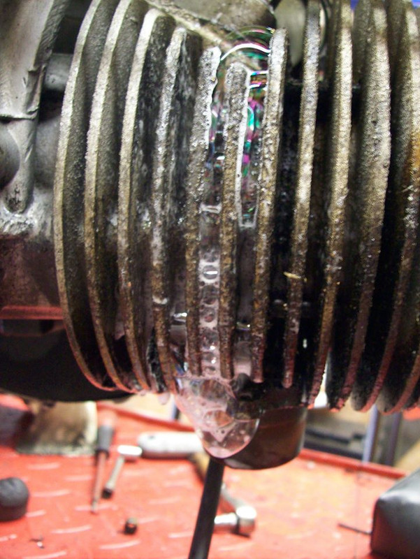

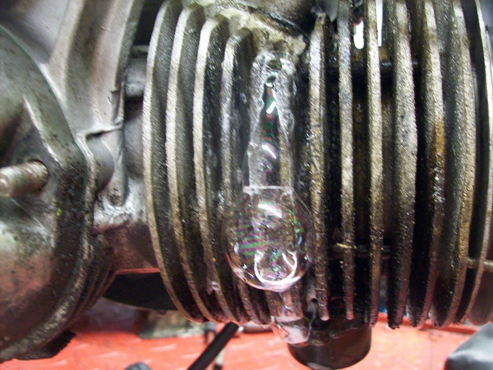

Postby Psychedelicropcircle » Sun Feb 02, 2020 5:27 pm
how do you go about fixing this? This started out life as a 186 imola, I managed to kill it so bad it was bored out to a 195 ceramic lined & im building this only to find an airleak in the barrel wall! bought in 2010 so I doubt it was here before its rebore! bad casting?

Shouldn't the ceramic coating be air tight?

Looking at it isn't it where the transfer ports are?

Yes, that is on the transfer wall: the ceramic treatment would not have touched it.
I would just put some Araldite over it. My barrel is full of such fixes.

If it's transfer wall, why not just drill the hole bigger, tap to something like M3 & Loctite a good screw in place? I'd use A4 stainless & finish both sides flush for an almost invinsible repair.

JB Weld it, done loads, this is more common than you think, but good chemical metal, such as JB weld will sort it,

Thanks for input lads, I’ll give the JB weld a go, stripped out the reed block twice thought I was going mad! Wasn’t until I located a breeze whilst trying to locate the hiss :o

JB Weld sorted this out! :shock:

yes ive had one the same, remove cylinder and mark the hole in the transfer port in the inside and then clean with solvent then use some jb weld to seal the hole, problem solved

had the same on my imola tiny casting hole in the transfer ,used yambond , 5 euro's done and still all good
