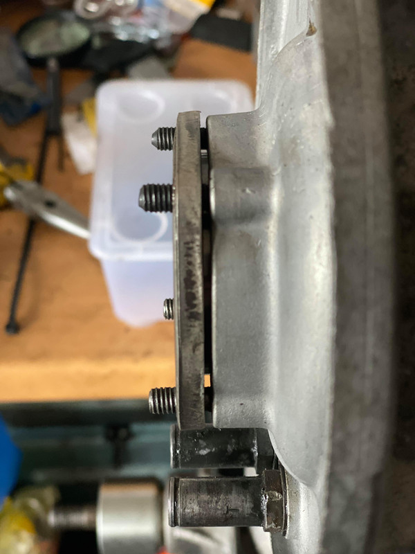

Postby Bilko » Thu Mar 25, 2021 11:15 am
For fear of looking a nob (which some will say I already am).
When I fit the bearing, the AF plate that goes on still leaves a gap? Is this right?
Bilko
Posts: 379
Re: AF Bearing fitment
Postby Simon_T » Thu Mar 25, 2021 2:26 pm
if you tighten that down the studs will probably bend, I may be corrected though,
I have fitted the new mb recessed plate
Simon_T
Posts: 105
Joined: Thu May 29, 2014 11:17 pm
Location: Sutton Coldfield
Postby Bilko » Thu Mar 25, 2021 2:41 pm
Simon_T wrote:if you tighten that down the studs will probably bend, I may be corrected though,
It doesn't look good. I've tried this on two different casings. 1 Italian, 1 Indian. The MB recess plates aren't any deeper than the one it's supposed to have.
Bilko
Posts: 379
Postby missing lynx » Thu Mar 25, 2021 4:10 pm
That doesn't look right I would contact AF they are good with their customer service will help you resolve the problem
missing lynx
Posts: 891
Postby hullygully » Fri Mar 26, 2021 3:07 pm
that is correct if you've used their recessed plate. 8-)
