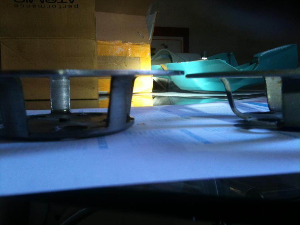

Postby Norrie Bodge » Tue Mar 10, 2015 2:21 pm
its a Readspeed 5plate clutch kit & all plates thickness including top plate = 19mm
heres the Atomic on the left compared to std pressure plate

Postby berniek » Tue Mar 10, 2015 3:09 pm
Norrie - looking at your pic I am unsure as to what you mean when you say "its too proud"
your top cork is well within the crown wheel with no danger of it popping, your top steel plate looks ok to me, the top plate does not need to be within the confines of the crown wheel. I would think that as long as you are getting seperation on the compressor then your set up looks ok?

Postby Norrie Bodge » Tue Mar 10, 2015 4:27 pm
I cannot get the side casing on with the atomic one fitted m8
The depth difference of the atomic 1 is say 5mm deeper than std

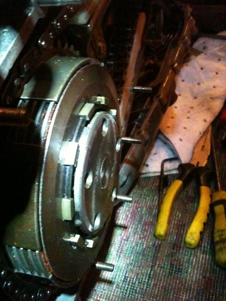

Re: Clutch - deep rear sprockets
Postby Norrie Bodge » Tue Mar 10, 2015 8:18 pm
It's not the kickstart m8
With the Atomic mate, when I try fitting the side casing
The clutch brass is rocking on the Atomic clutch pressure plate
With it being 5mm deeper! I Must need a machine crownwheel m8?
When I say proud... Look at 1st pic m8
How the Atomic pressure plate is protruding so when side casing is fitted its tight against brass pusher

Postby dscscotty » Tue Mar 10, 2015 10:25 pm
Use thicker steels/top plate it'll draw it down, the 5 plate does not have enough over all depth, (you can fit 5 standard thickness plates in an atomic clutch) and is allowing the pressure plate to protrude.
