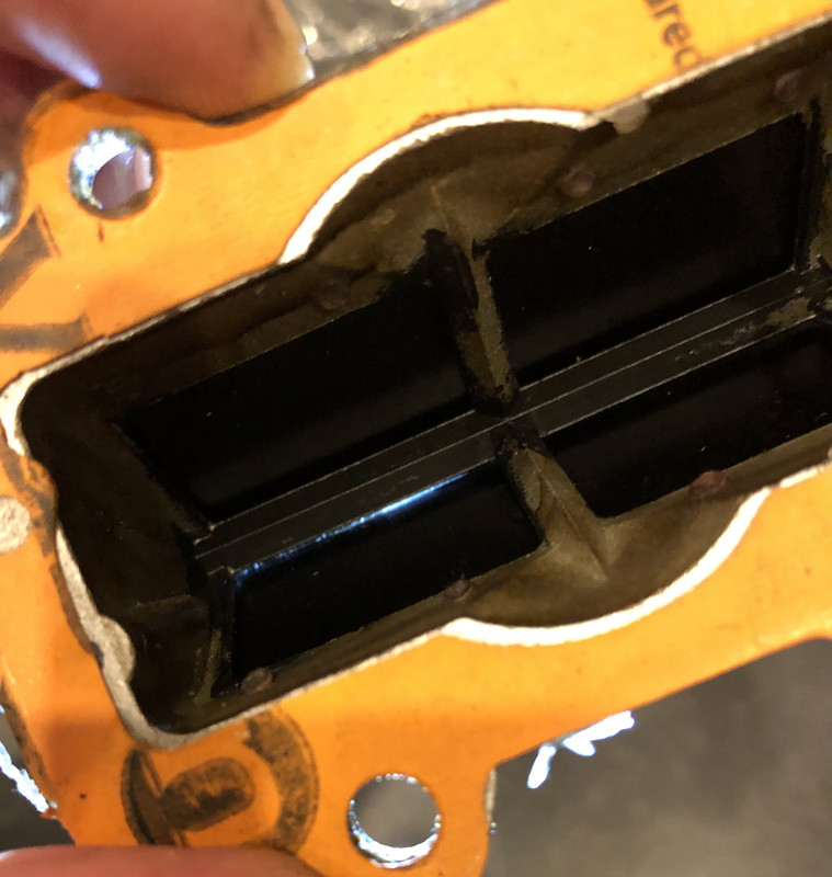

Well they are not cracked or broken but they are looking tired.
I have put a torch behind it so you can just see that there is a noticeable gap on one side. Would the symptoms I mentioned in the opening post be solely as a result of this?

The 186 uses a reed valve from a very high revving kart engine and is not really suited for use in a lambretta. Consequently, they are known for breaking the top reed petals.
The recommended solution is to "double up" on the top petals.

Fast n Furious wrote:The 186 uses a reed valve from a very high revving kart engine and is not really suited for use in a lambretta. Consequently, they are known for breaking the top reed petals.
I did double up on the top ones. It’s the bottom that has bent outwards. I’ll double up both sides when I replace them.

My eyesight must be going
I had doubled up on both sides. However, I have discovered today that there is a right way and a wrong way to fit the reeds. There is a cut out in one corner and these must be placed in opposing corners of the Reed block.
Edit: the cutout must be to the left on both sides. Perhaps this should be referred to when you buy Granturismo kits. I have never seen it in writing anywhere and I have had my GT186 for the best part of ten years.
