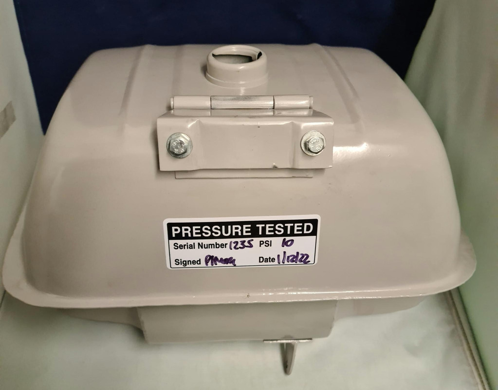

The lad has bought one of the below type from Chiselspeed told they fit series 1/2/3 I’ve not fitted it yet but I’ll let you know when I do
Re: Mid Range fuel tanks Series 2
Postby Norrie Bodge » Mon Mar 13, 2023 7:26 pm
Toddy wrote:The lad has bought one of the below type from Chiselspeed told they fit series 1/2/3 I’ve not fitted it yet but I’ll let you know when I do
Fitted one on a mates Italian S2 no issues m8, & put rubber washers on all fixings
