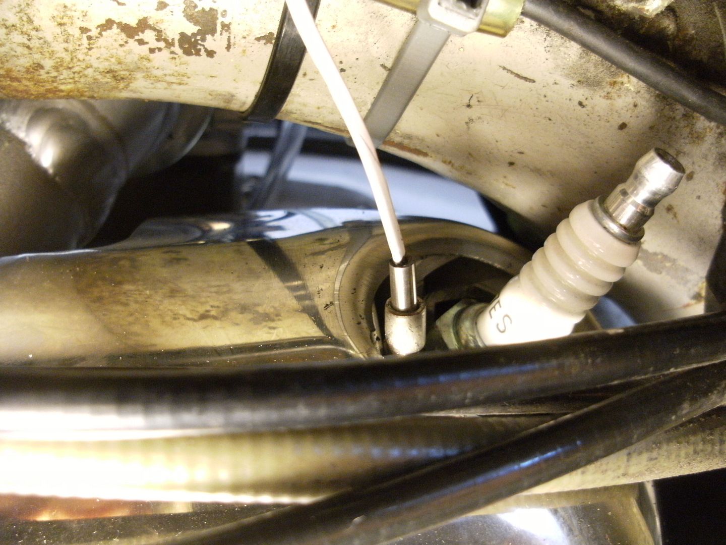

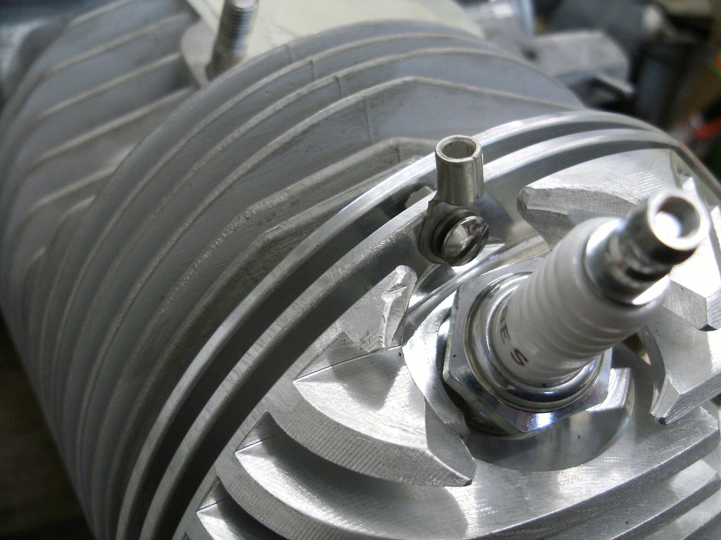

i'm using this bracket:
connected to my RT 1000
probe checked with a boiling kettle and was reading slightly over, i've ammended the base setting on Centigrade scale as i'm an old git :D

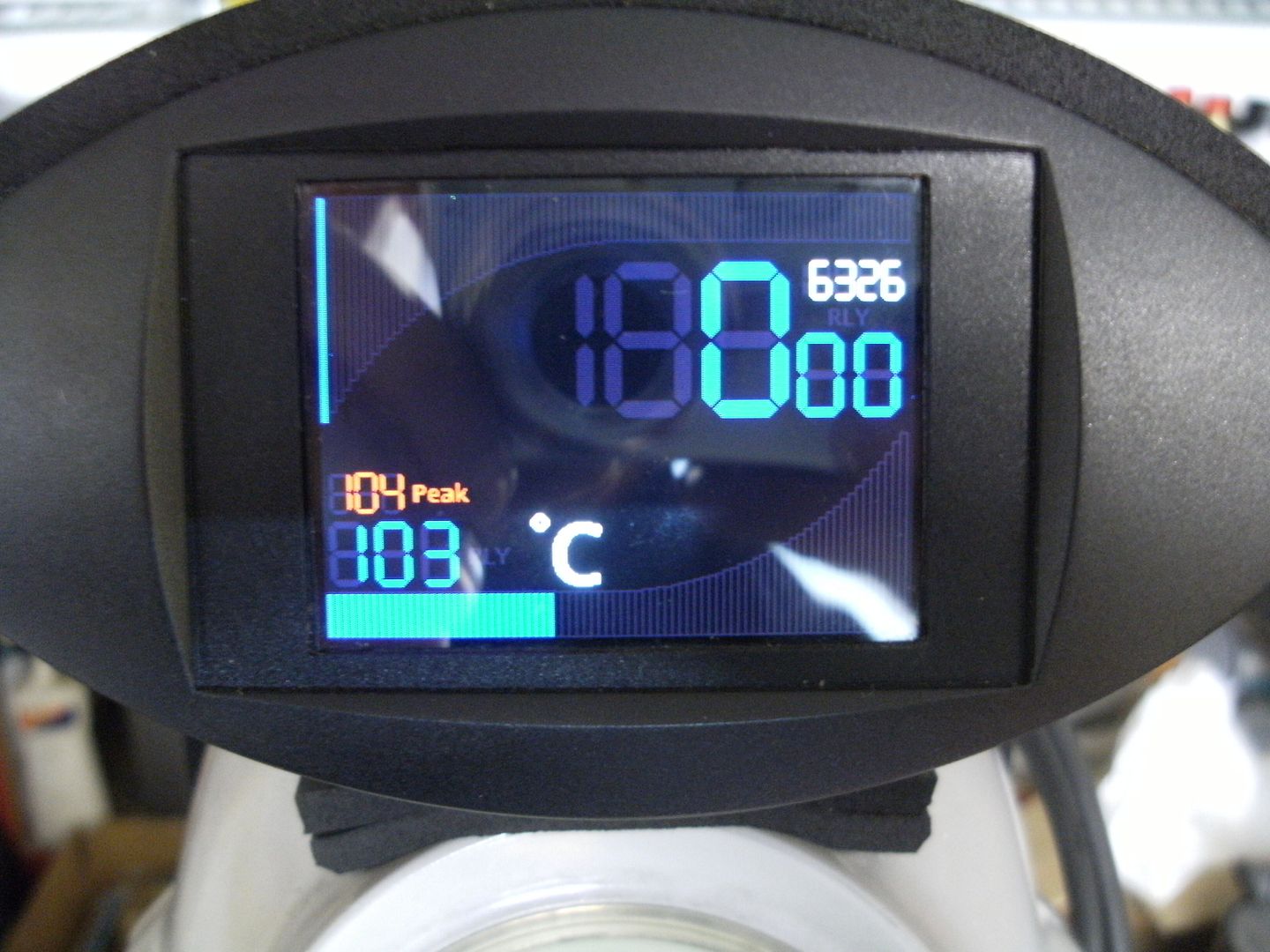

Postby peejay » Fri Oct 24, 2014 6:12 pm
hi peeps
done 100 miles now mainly at 35-40mph and peaked at 45.
max revs 4.500.
head temp is 104-110 and peaked at 115 C

Postby berniek » Fri Oct 24, 2014 8:10 pm
Difficult to say Peejay, Depends on so many things especially when bolted to the fin of the cyl head. Always best I think when you bolt one to an engine that you know is solid and set up well, you just benchmark it at different revs and away you go, using your known safe reading as a gauge. More difficult on a completely new engine with unknown set up as the position you bolt it on could vary reading by 15 degree, so you cannot use others settings as safe. I've bolted them to cyl head on a number of different TS set ups. flat knacker on the motorway at 7000 - 7500 rpm plus for an hour running at 170 degrees c is not untypical on my motors. in traffic at 60 mph it drops to less than 130, and around town not normally over 115. I've holed piston at 180 deg. I would generally think something untoward is happening if over 170 or so
They will always rise slightly as you cut the engine, basically the head is a heat sink and the lack of air and lubrication makes it rise for short while
