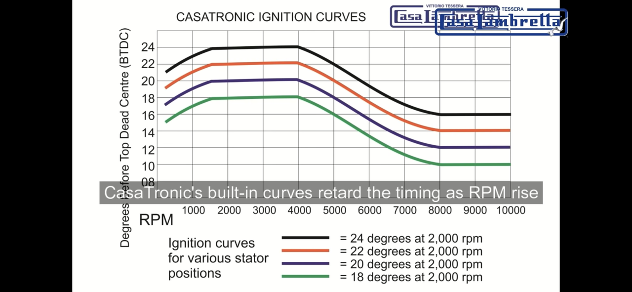

Saw your comment on the Vape thread - wow Scootopia themselves do not know the ignition curve of their own ignition.
Bit of a long shot after a quick google myself the scootopia ignition looks similar to the old style IDE Casatronic system
Big assumption time..
There is a ignition curve for the IDE casatronic to be found online, which maybe the same as the Scootopia ignition curve
It’s within a Rimini fitting instruction video. You have to screen print the graph when it appears within the video
I’ve just done this myself
If you want the screen print yourself PM me

Now I'm on a PC and can post an image onto the forum, which others may benefit
Here is the previous version Casatronic IDE ignition curve, which maybe the same curve as the Scootopia IDE style ignition.
