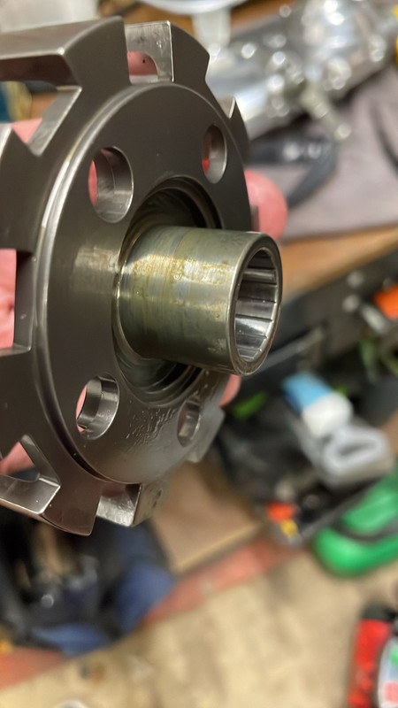

Engine has done around 250 miles since rebuild, 5 plate clutch in an RT230, a brass clutch bush was fitted with the spiral oil groove
The chain was originally setup with 6mm of up and down movement using a push up tensioner
I was surprised to find a large wobble on the chain ring due to a heavily worn brass clutch bush - this has caused me to question if brass is the correct material in this application and ask what others think/have found?
Personally I'll strictly keep to bronze bushes from now on.
Brass versus Bronze using Google
"Brass, in general, has a poor wear resistance in comparison to bronze."
My clutch spider - you can see a kind off oil/brass grinding 'slurry' on the bearing surface that I found stripping out the clutch

On my last rebuild, I ordered a bronze bush. On arrival, it had smashed into about ten different pieces. They are quite brittle. I ended up putting a brass one in but I have noticed that you do need to regularly replace them as, like you have seen, you get excessive play on the rear sprocket pretty quickly.

I find that all these spiral grooved, shiney replacement bushes are made of brass and are just not upto the job. Maybe someone else knows different? They are often the only option available from some of our so called reputable suppliers. :o
The bush is a non standard size making options limited.
I use the proper sintered bronze ones from Scooter restorations. Never had an issue with them.
