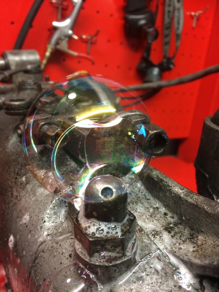

Pressure tested and it was leaking so a few squirts of soapy water and it looks like the drive side oil seal is just about to fail, Next pull the front sprocket off and check again.
It's 99% certain to be the drive-side oilseal.
The bubbles you can see are caused by air leaking past the drive seal and escaping out of the breather in the side case, soapy water easily shows the leak.

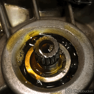

30mins later and leak tested with drive sprocket assembly removed, pressure tested with oil sitting in the bearing tracks the leak is obvious.

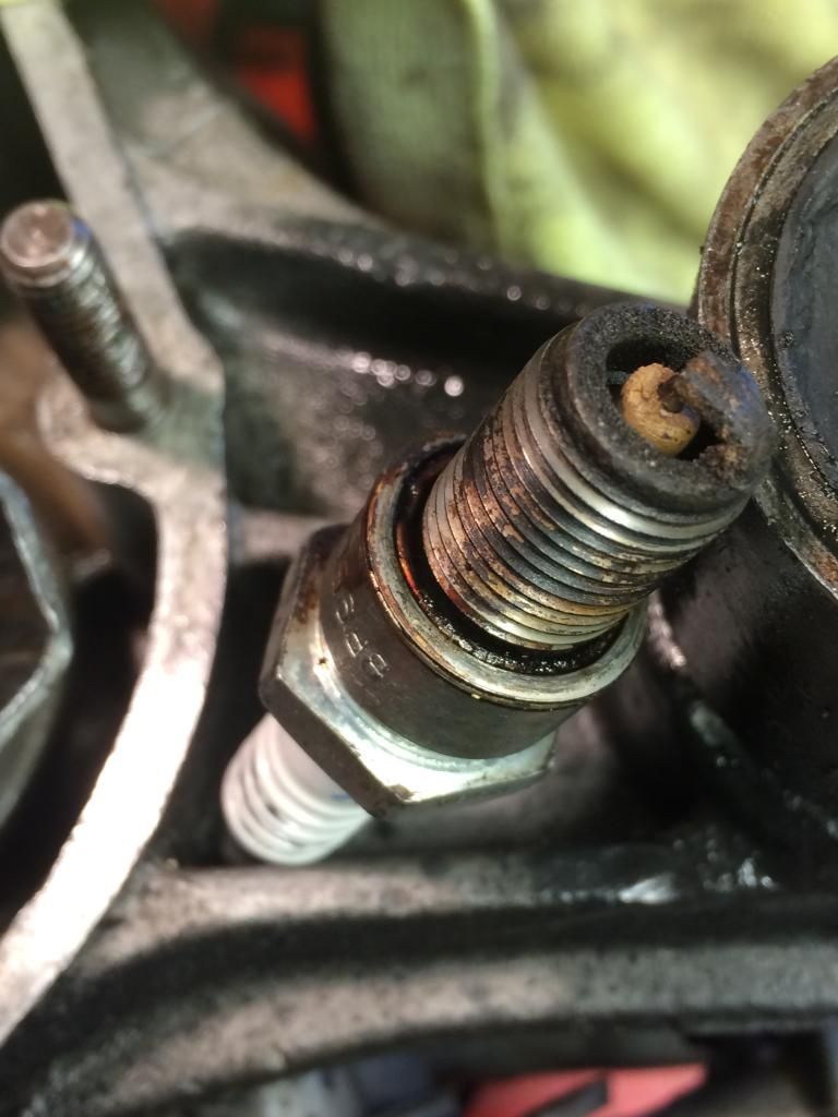

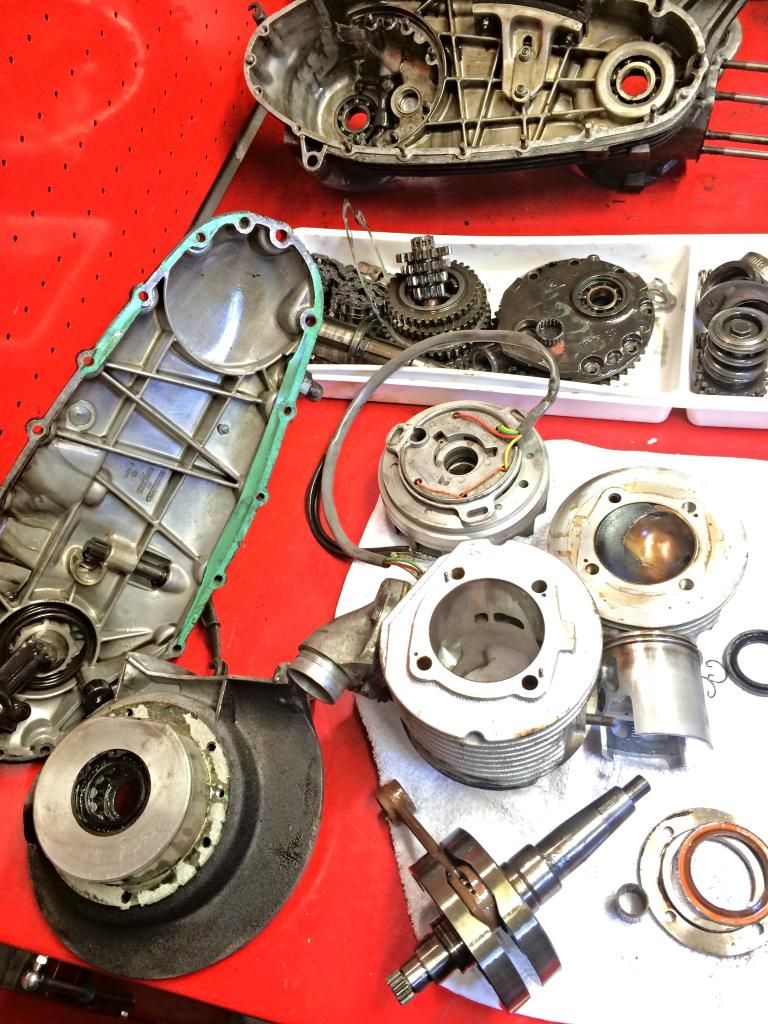

I took the engine out to change the gearing and service the engine but when I removed the Spark plug I wasn't happy with the deposits, I suspected the drive-side oilseal was on its way.
a couple of hours later.
The drive side oilseal is as hard as a rock it's got no flexibility, most likely caused by the petrol.

Scooter Paul wrote:Captain, fantastic pictures. I think this is the first time I've seen moving pictures that weren't YouTube type links.
Paul
All the photos and the short moving pic were done with an iPhone thought the short video was a clearer way to show what was happening.
I think I cought it just before it went completely, most likely the drive seal is more flexible once the engine warms up so it seals, but from cold it's likely burning a little of the gear oil till it gets warmed up and becomes flexible.

as an afterthought, did you suss out what the debri on the spark plug was, im assuming not piston damage?

Donnie wrote:as an afterthought, did you suss out what the debri on the spark plug was, im assuming not piston damage?
The barrel and piston look in mint condition with no visible damage,
There is very little blow bye past the piston rings with hone marks still visible in the Nikasil bore.
To me it looks like the engine has just leaned off a little through the extra air drawn in from the gearbox side of the crankcase.
Then theres the heavier discoloured carbon deposits almost fouling the plug deep inside the insulator most likely caused through burning the Mineral oil as its drawn in from the crankcase.
When the engine was first jetted it was running slightly rich and It had a cleaner burn to the plug with just a light chocolate to mid brown-tan colour along the porcelain insulator. But no where near as heavily Coated as it is now.

Might sound stupid but did you squirt the soapy liquid direct into the breather hole?
Simon

SimonC wrote:Captain,
Simon
No I just sprayed it around the breather with a fine spray of soap and water, it bubbles up if there's any air coming out through any escape route.
diluted with 4 parts water to 1 part washing up liquid.
I checked all of the gasket joints first with a spray, then the breather.
