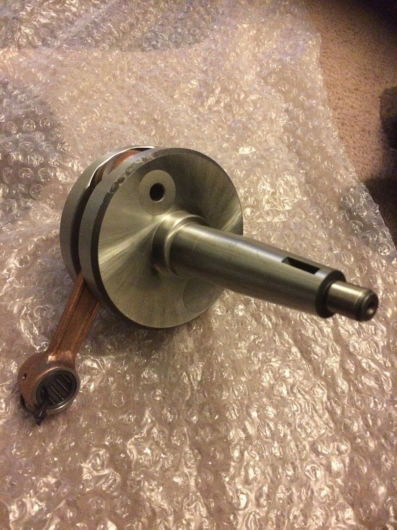

Jamjo, this is a 60 mm x 107 mm rodded JB supplied crankshaft, this is going into a new engine build soon.
