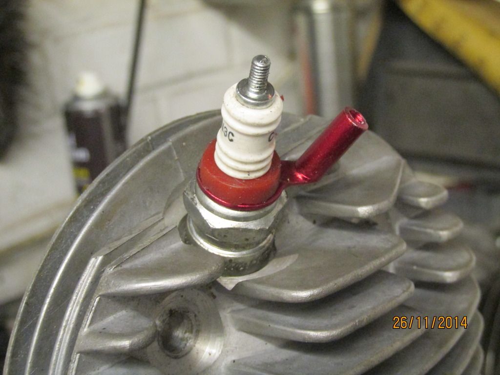

Postby dscscotty » Thu Jul 23, 2015 5:32 pm
Or on top of it!
Re: SIP heat sensor
Postby amb » Thu Jul 23, 2015 6:21 pm
Scotty , by any chance could you put any images up of the sensor you put on the top of the plug , iknow it was in jetset but thats long gone :oops:

Postby dscscotty » Sat Jul 25, 2015 7:10 pm
This has been my preferred method of attaching sensors, long before the advent of more recent technical gadgets we used this method, which give good readings via the plug. Having fitted both beneath the plug and on top there is very little if any difference in the temp readings it also picks up change in temp very quickly. I have encountered issues with sensors fitted under the plug such as the rings splitting and causing air leaks, your not guaranteed a good seal imo.
Here's a pic as requested:
Re: SIP heat sensor
Postby gp200ts1 » Sat Jul 25, 2015 7:44 pm
What pipe do you use to hold it as everything I have tried is either too big or too tight to fit over the plug?

Postby Tractorman » Sun Jul 26, 2015 9:08 am
If you take a plug, not that they will have plenty anyway, to a motorcycle shop you will find some petrol pipe that fits well. dscscotty you're right about it picking up temp changes quickly.

Postby Warrick » Sun Jul 26, 2015 11:47 am
I went to halsfords got given some 8mm fuel pipe.. It's a pig to get on the 1st time just pop it in boiling water and use a screwdriver to get it on.. Once it been on there a while it's easy to get on and off. Better to be tight fit. If it's lose it can read 10-20f less than it should. I've just replaced my 1st attempt it was getting lose coming on and off. Cut mine abit slimmer than the picture so the cap fitted well.
The fun starts when you try and find out what a healthy temperture is. There would seem to be a lot of difference in readings people get. I think this is down to how well it's fitted and the kit.
I think between 130 to 180f on top of the plug seems about right pending on the kit. Eden gets 347f under the plug
Good luck they work well
