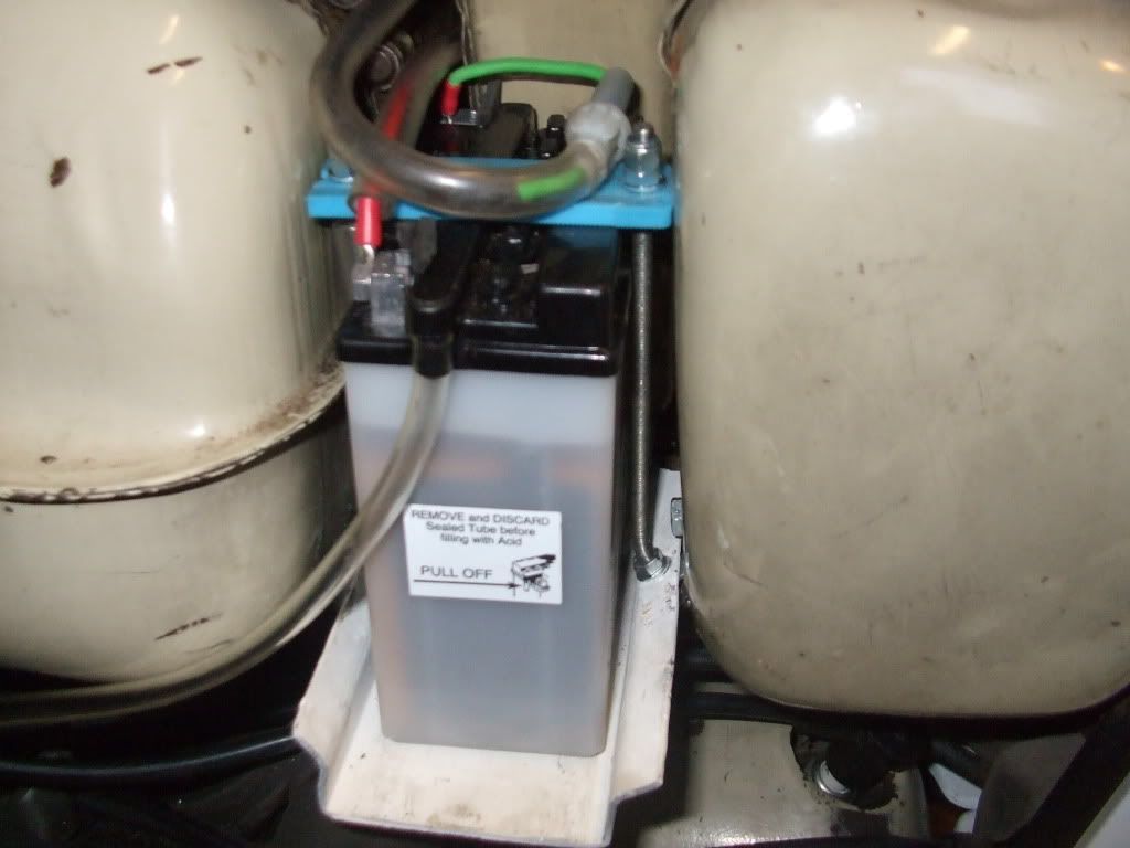

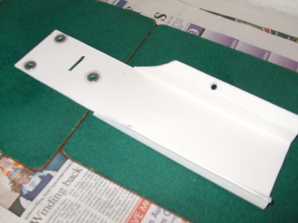

I would say battery .You can bolt a plate under the air box if you have no battery tray (if you still have air box)
And use the thread to fix bracket to tool box
Image.
The battery is 5 amp/hr.
If you have a battery the lights still work if you have to push your machine home in the dark :lol:
Grandpa
