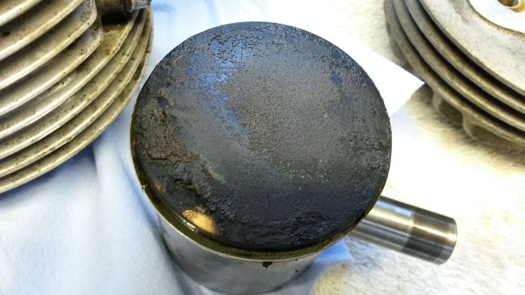

li 150 series 1 full restoration 2 years ago
fitted a 186 mugello, 26 phbh delorto, ram air filter, new gp crank, ancillotti exhaust, 12v varitronic ignition, ngk b9eg plug.
the squish was set at 1.2 mm
synthesis 2 oil at 2%
had it set up on the dyno and checked 18 months later
have done 5300 faultless miles mostly 2 up. always starts first kick
i noticed the exhust got louder and so did club members
there were no signs of any blowing so i took the exhaust off, iv ordered a new one to see if it made any difference

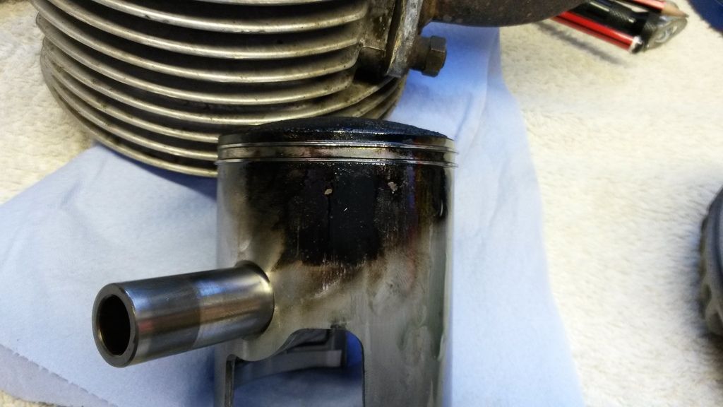

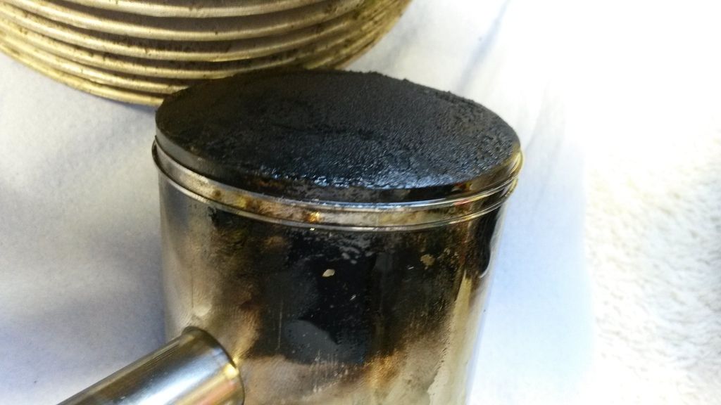

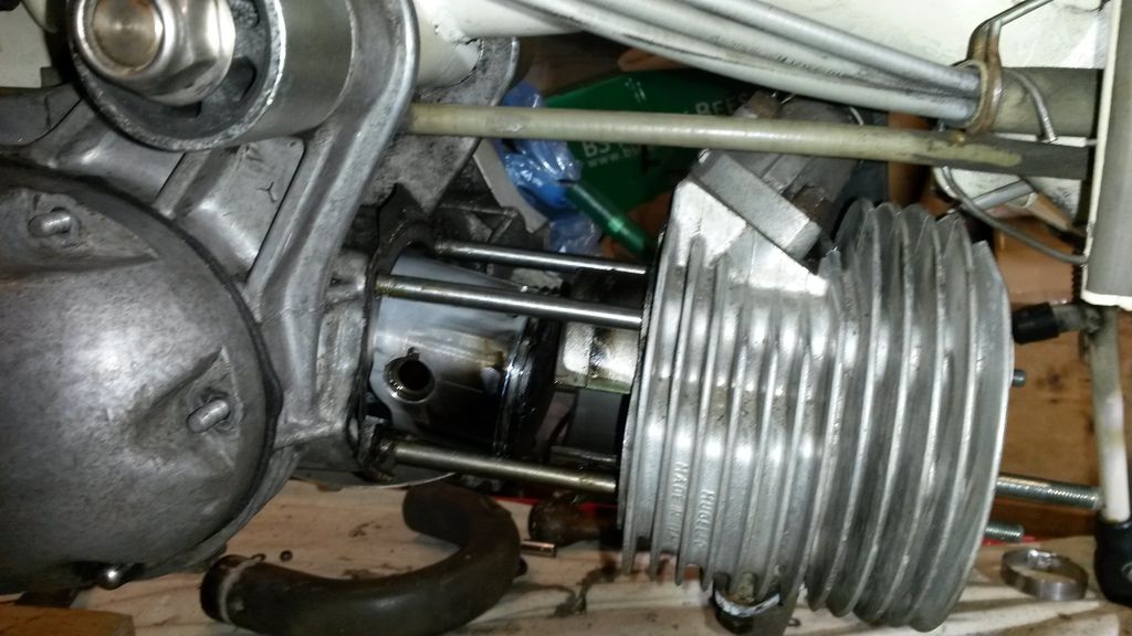

looked like there may have been a small leak from the base gasket so we checked it with an air test and it held up
i decided to take the top end off and fit new base gasket and this is what we found.

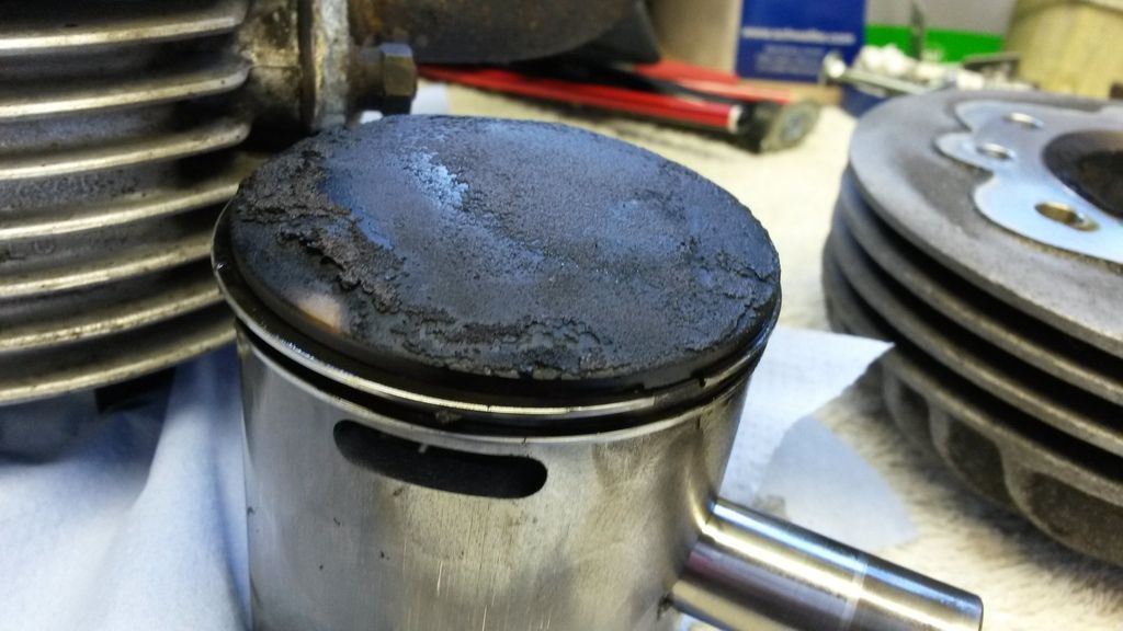

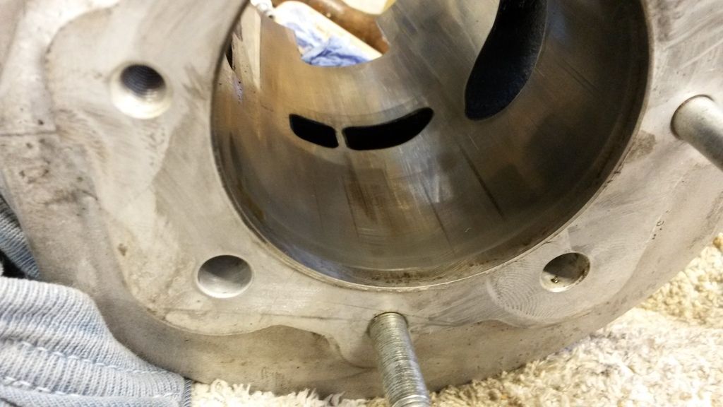

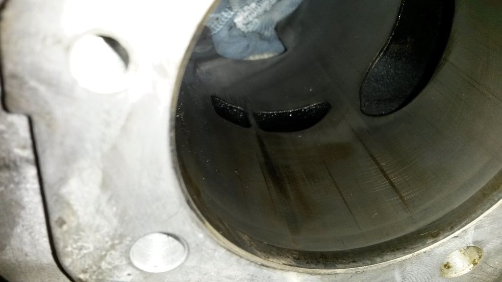

the barrel looks worse than it is. there is no score in it its just marked.

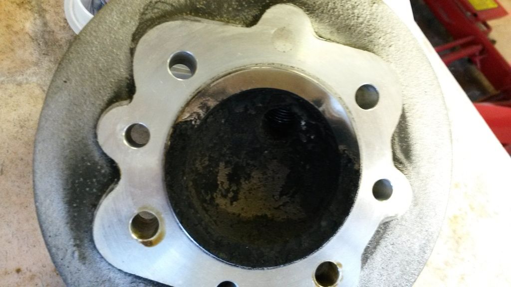

it looks like the build up of carbon on the piston has been hitting the head.
i have ordered new rings and piston.
any ideas why carbon has built up so quick?
would this make it louder?
also the plug looks much too light, would carbon build up make it run hot?
any ideas please

At 2% it's not your oil mix that's causing the carbon build up but maybe the barrel wear? With this much carbon has the drive side oil seal been leaking? I had a base gasket leak on a Mugello 186 but this was more down to poor seal on the transfer port surfaces at the crankcase due to porting modifications. I holed a piston. It was cured with an alloy base gasket from MB which gives a much better seal due to larger contact area.

It looks like worn rings have caused the problem.Check the gap.I run a Casa 210 top end on my series 2 and the rings needed changing after 1300 miles.

It's burning gear oil which has then gummed and worn the rings. Gear oil isn't a lubricant in the top end which explains the running hot and the louder exhaust will be down to the baffles being gummed up.

If the seals are all ok it looks as though the rings have stuck (or very badly worn) and it's just a gradual build up.
Another option may be a too retarded timing or not giving it enough rev's often enough.......

There’s nothing wrong with your oil, apart from it may be doing too good a job. Synthesis is as good a racing two stroke oil as the likes of us can buy. BTW. The big end is the first moving component to be subjected to the fresh rush of petroil into the crankcase.
What can be seen from the images is classic blow-by which may be bore to piston clearance as well as rings. What are the bore clearance & ring gaps?
As for the crown of the piston, presuming that you don’t suffer from a limp right wrist, there is a lot of carbon there. What is the underside of the piston like? That’s a good place to look as an indicator of correct fuelling.
Other than you are using too cold a plug (as others have said), it would be interesting to know your carburettor & ignition settings.

Running 2% quality oil is fine and will give adequate lubrication to the heart of the engine. Incoming fuel goes down first intk crank area. People run with more oil for peace of mind but in my opinion that's an unnecessary expense and that isn't the reason for this failure or a discussion for debate on this thread.

tried the new piston in the barrel and it wouldn't go in even with out the rings on it!!
cleaned up the old piston and rings which came up like new. the rings were not stuck in the piston.
the under side of the crown of the piston was a very light brown.
i checked some measurements, the piston to bore clearance was a tight 4 thou. ring gap was 24 thou.
the timing is set at 21 degrees with a strobe.
put it all back together and set the squish at 1.2 mm. i put the new exhaust on and put a b8es plug in.
started it up and it sounds like it did when new. rode about 5 miles and it runs beautiful and feels sharper :D
i think the problem with all the carbon was that the b9 plug was too cool, it was recommended with the varitronic ignition. also i probably dont rev it enough to clear it.
i dont do motorways but varied riding coast to coast, the derby 150, club rides and rallies
i am going to use it as it is for now and probably check it in about 1000 miles.

Big ring gap.

As I suspected, I think your bore to piston clearance is way too much. Please check with an expert on alloy/nicasil barrels, but I would have thought 0.002" was the maximum for a 200 (Ø 66 mm) so with your set up, I'd be aiming for 0.0015" maximum. As CHRIS in MARGATE has pointed out, your ring gap is too much as well.
Sorry if I'm p*ss*ng on your chips!
I must confess to having never used a 'standard' piston in a Mugello though I have used the barrels.
The pistons should be graded to give the correct clearance. I suspect they are & that is something you could do well to find out because it sounds as though you need a grade between what is in your engine now & the one you tried that won’t fit!
Whatever you decide to do, Good Luck!

There is no lip or wear marks to the bore the fine honing is visible. i think its just the rings that have worn.
