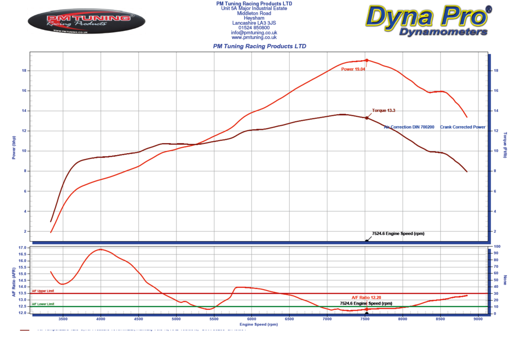

Postby jonw » Thu Nov 10, 2016 2:10 pm
Don't know whether this is relevant but here's my standard GT 186, 30PHBH (open), PM25EV expansion and Varitronic...
