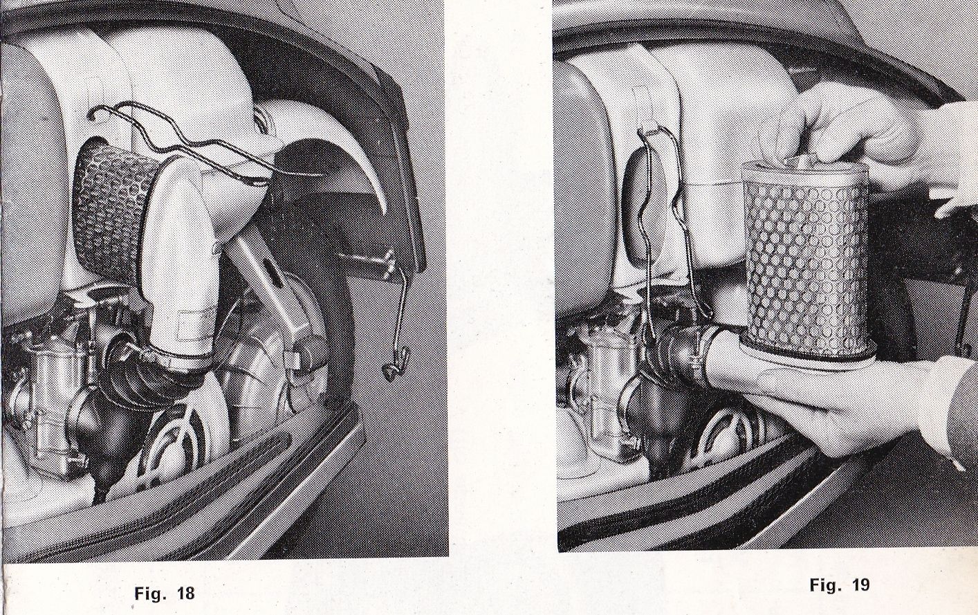

Postby Chadley » Wed Oct 21, 2015 10:58 pm
I've never been able to find a supplier of these. I believe the very early GPs had them fitted and some early GP fan cowls include a bracket to secure the drain pipe - mine does but it wasn't supplied with a drain valve type hose.
I get a bit of spit-back in the hose elbow and I've always suspected this to be the cause of occasional poor hot starting.
Here's a picture of one in the Innocenti GP150 owner's manual:

Postby Andie » Thu Oct 22, 2015 10:58 am
^^ I always wondered what that bracket was on my flywheel cowling
