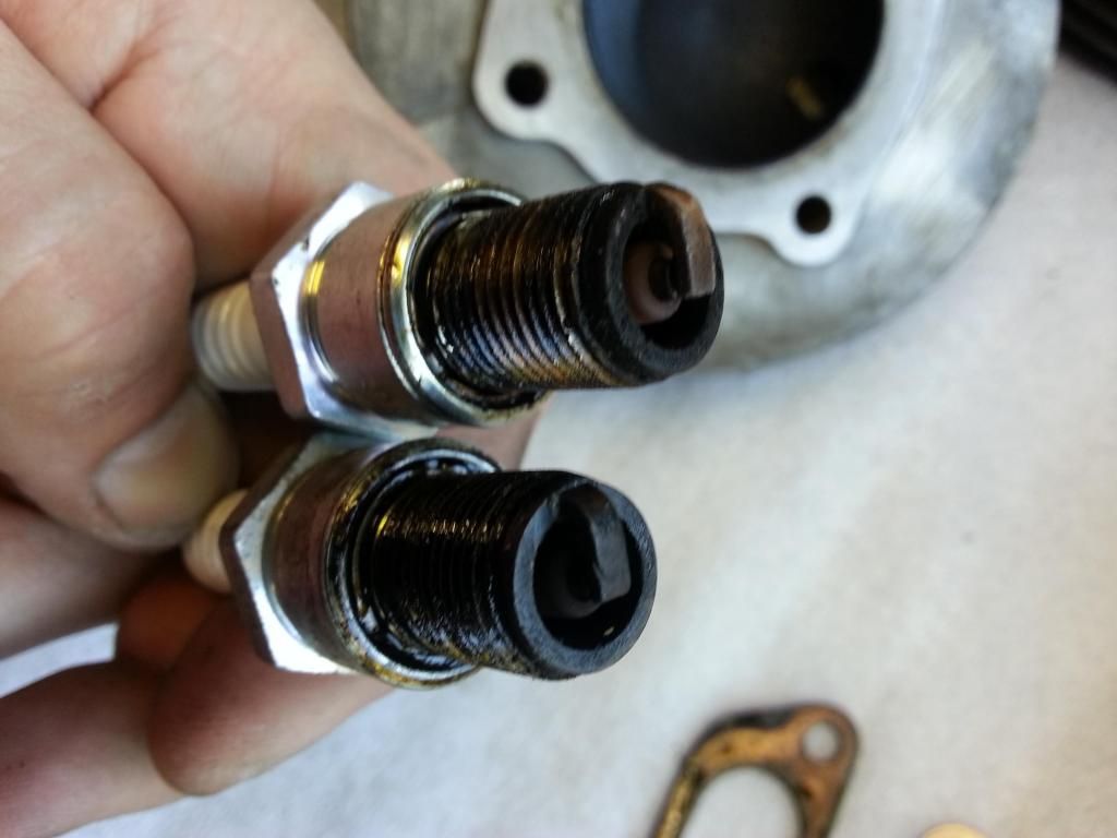

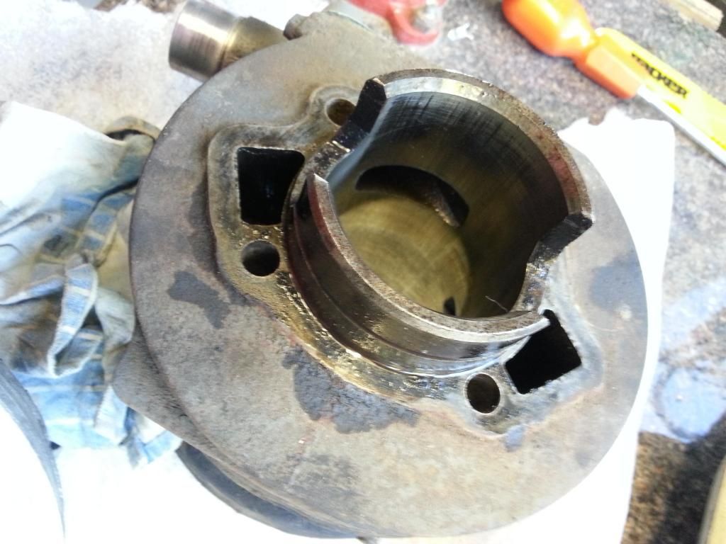

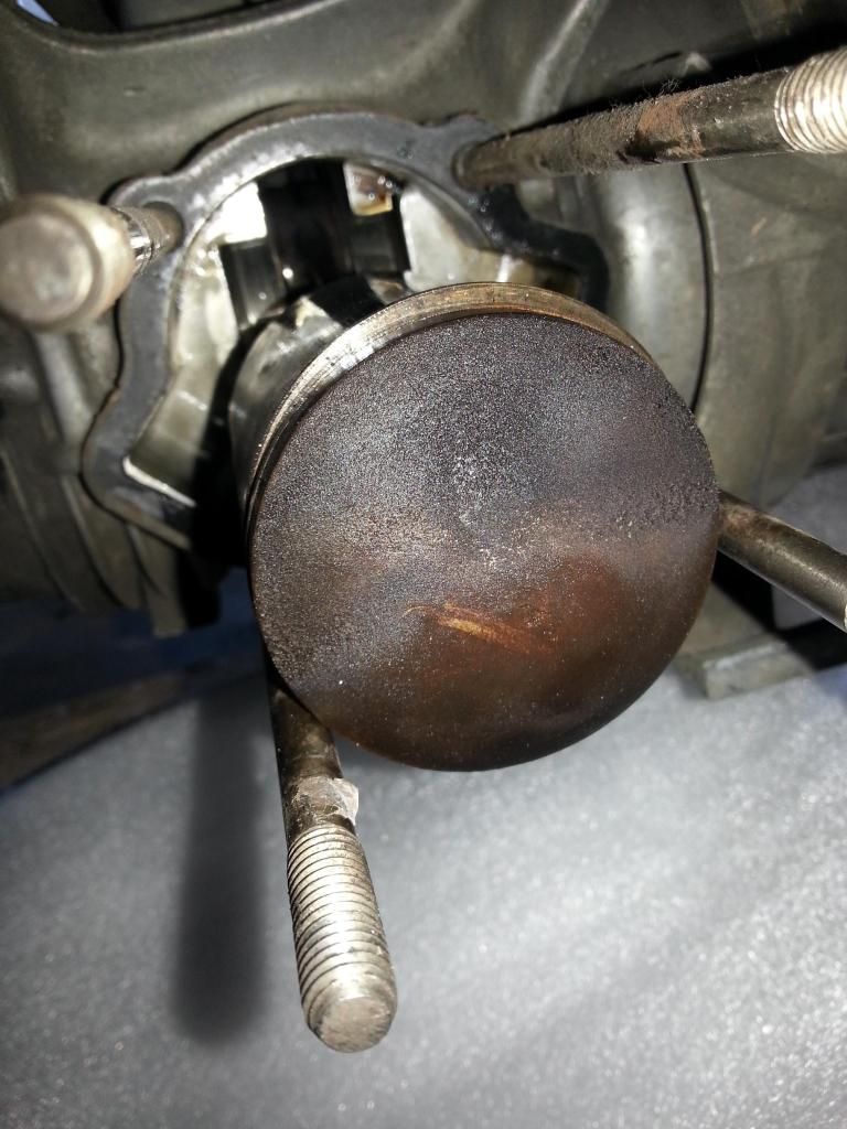

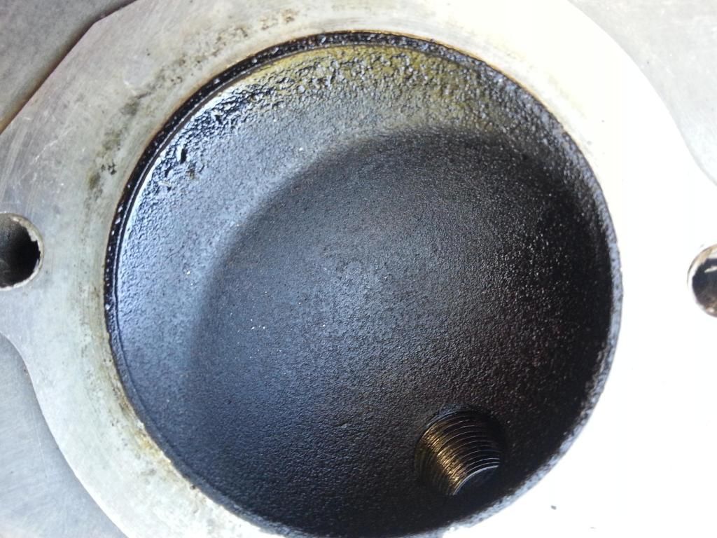

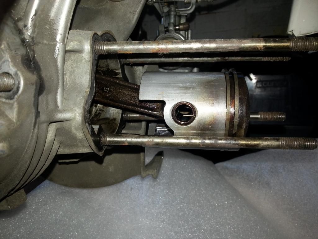

So, I have taken the top end off to have a look.... and need some opinions. No ring pegs missing and to me it looks ok but would like opinions on build up on piston crown and head. I'm thinking drive side oil seal? It's not noticably more smokey, wondering if the squeal/screech was the retaining plate screws.
Don't know if that, and the pics gives enough detail but what do you think? Now thinking just bite the bullet and get the engine off the scoot and on the workbench. This being my first year taking my scooter out and about on a small number of rallies I am still hoping to make Shipston but I am up against it now. I will be Mr Pissed Off from Piss Street, Pisstown, Pissedoffshire if I miss it!!!
The engine was ticking over for 10 mins or so before I stripped it to get some heat in the exhaust to make it easier to get off.
Thanks for looking.
Top plug is the one I took out on way home, bottom is new one but as I mentioned engine was ticking over for a bit before I took it to bits.

Nigel. 3% of what fully or semi. The carbon build up would be ok in my opinion. Hard to tell from the pics but have you got brown staining behind the rings or any sighns of a nip. Sounds from your story like a nip. Check the carb rubber for splits. Carb and exhaust studs are tight. It could have run lean and nipped up. When you left it and it fired up again. The innertube leak test would have helped. Im still looking for the 5mph I lost 2 years ago. In my case the extra bag of spuds im carrying may be the fault but not with you...

Like Monty, I also though 'nip up' but the engine internals look healthy in my opinion and the plug colour (first plug) looks good. The 'squeal' that you mentioned is intriguing though and makes me wonder if the problem could be flywheel/ignition related? Points do need regular maintenance and adjustment to counter the wear on the cam follower, worth looking at if they haven't been looked at since the rebuild. I've had the center dust cover come loose as well as the fan cowling and both resulted in squealing noises

If the bore and piston look ok. Check your rings and go down the flywheel route. The circlip on the pin looks like a wire one? I would only expect a modern piston to use those. Most standard pistons have flat bottom circlip slots and the old type ears with holes clips. They can jump out. Worth a look while its in bits.

Just had a look, on piston there is an area that catches your fingernail as you feel around it (visible too), also corresponding on cylinder. Looking up the cylinder from bottom it's around 4 o'clock. Also corresponding on piston ring. Would running the engine with this cause the extra vibes I swear I can feel in my backside? And power loss. I thought the learning curve was beginning to level out!
Carb rubber fine. Yes wire clips. I think it is an ASSO piston, I'm sure it's written on it if I remember correctly, it would've been on old rebuild thread.
So guess looking at next oversize.

One of the beauties of a cast barrel is they take abuse. Dont be to eager to rebore. The buggers take too long to run in. Basically your piston has transfered some aluminium onto the steel wall. Clean it off with some wet and dry. Do the same with the piston. Check the rings are free in the slots cleaning out any carbon. Check the ring gap in the bore and if ok go again. A new set of rings at worst. Dont be afraid of having a good go on the piston as long as the nip area is away from the rings and use some corser wet and dry to cross hatch it all the textra space and scratches will hold oil.

^ Flippin' brilliant!! I had just logged on to post that very question. I will have a go at it, will get new rings as top one also has damage where its been rubbing against the transferred material.

Looking back at the piston pic the damage is obscured by the barrel stud.

Hard to tell by the photos but the blackening inside your casing could be gear oil , also the piston and head look to be pitted and coated as well. Check your conrod for any notchiness and that there is no up and down play. There is also something on the piston crown, I can't quite make out?

Piston crown and head have cleaned up ok, the mark on piston is where I'd scraped some of the build up off, if we're looking at the same thing.
On looking at everything again I reckon poor cylinder to case seal, poor u-bend to cylinder seal. New piston rings have a gap of .26mm, old ones had .65 and counting :oops:
Had a go at cylinder and piston to remove nip up damage and will reassemble as soon as. (sealing everything properly!)
