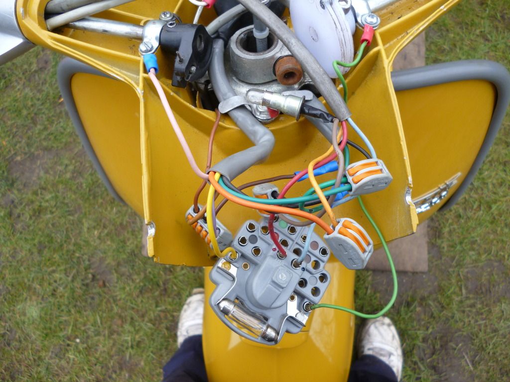

The wago connectors are working really well, they lock very tight. As usual I took a belt and brace approach and tinned all the cables with solder to prevent the cable oxidising before installing the wagos.
I just remade some connections for the stator that I didn't get round to tinning last night, the joints from the stator to the Wassel regulator, they were still clamped very tight even though I did not solder them at the time.
Wago lever connectors are a good bit of kit, but obviously not to original spec, if that's your thing. And they can be opened and closed over and over again without affecting their functionality.

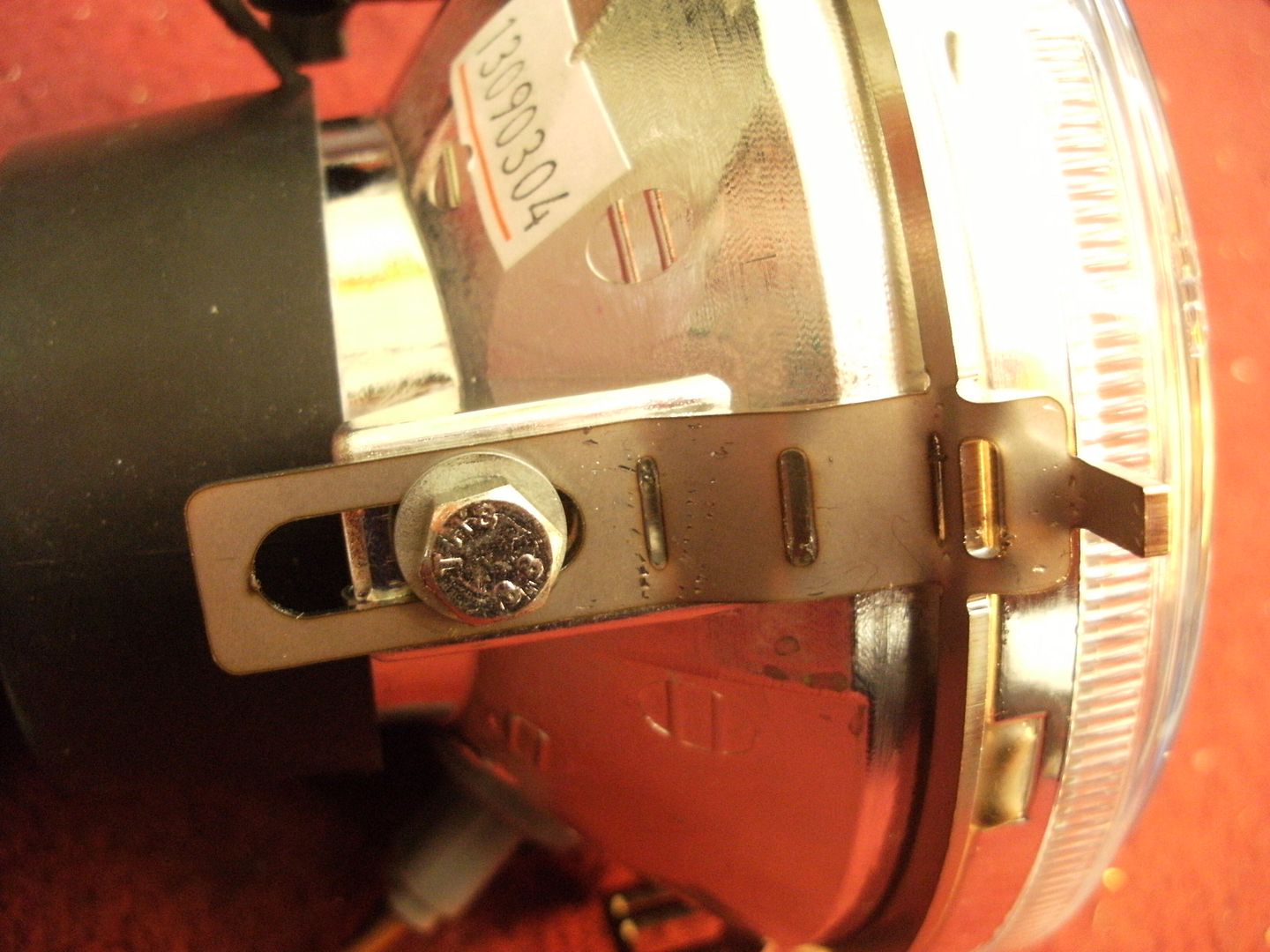

Monty, the Jet fitting is slightly different as it uses the side mounting and bottom mounting screw and TBH is a pain in the arse fiddly job. I also bought one for my LiS which appears to fit a lot easier, I'm not ready to fit it to the LiS yet but I'll see if I can get some pics sorted tomorrow 8-)

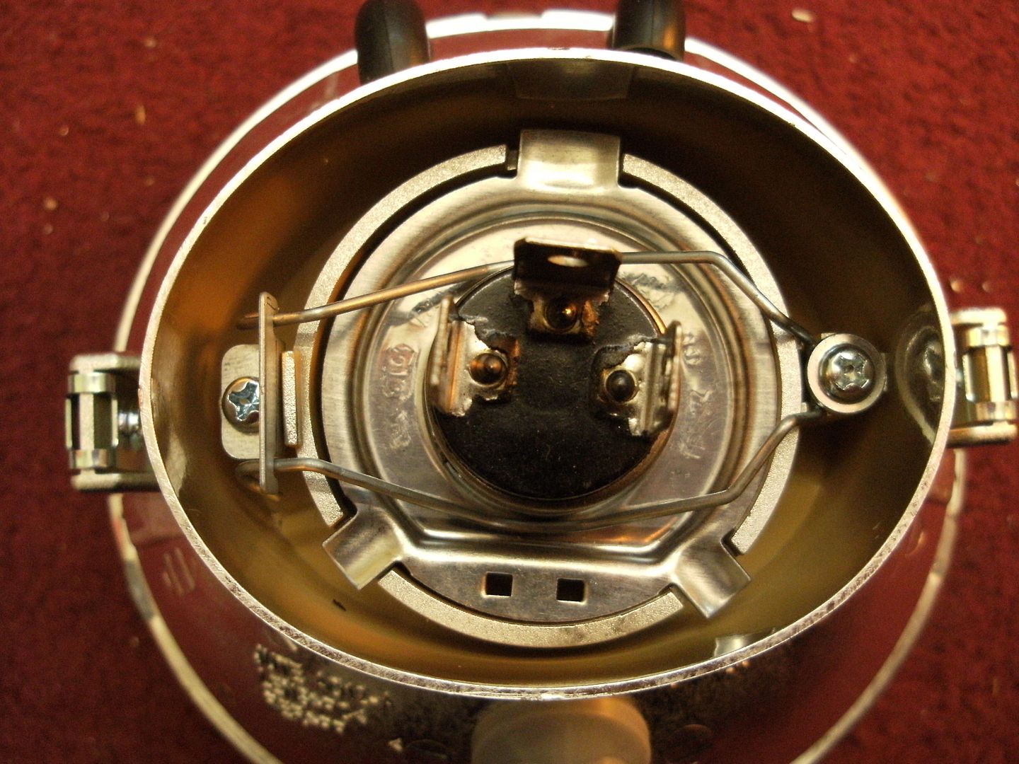

Agreed about the 3 screws on the Jet headlight... a real pain.....

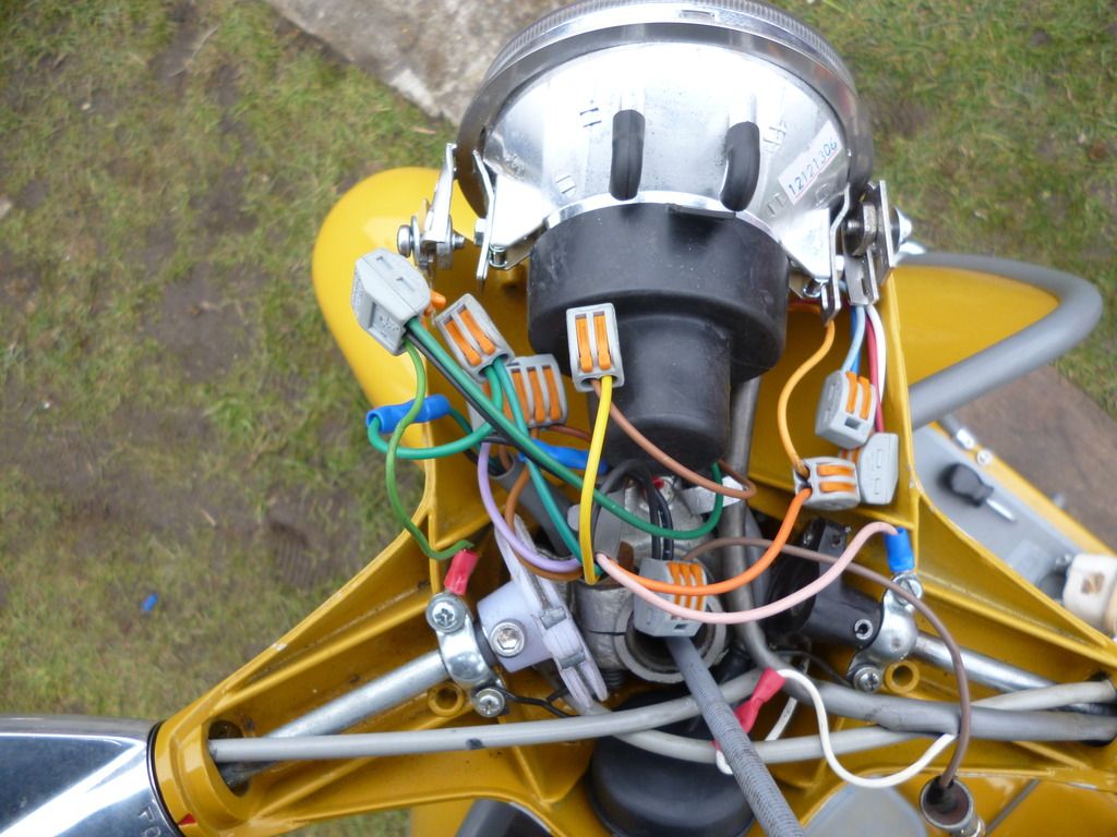

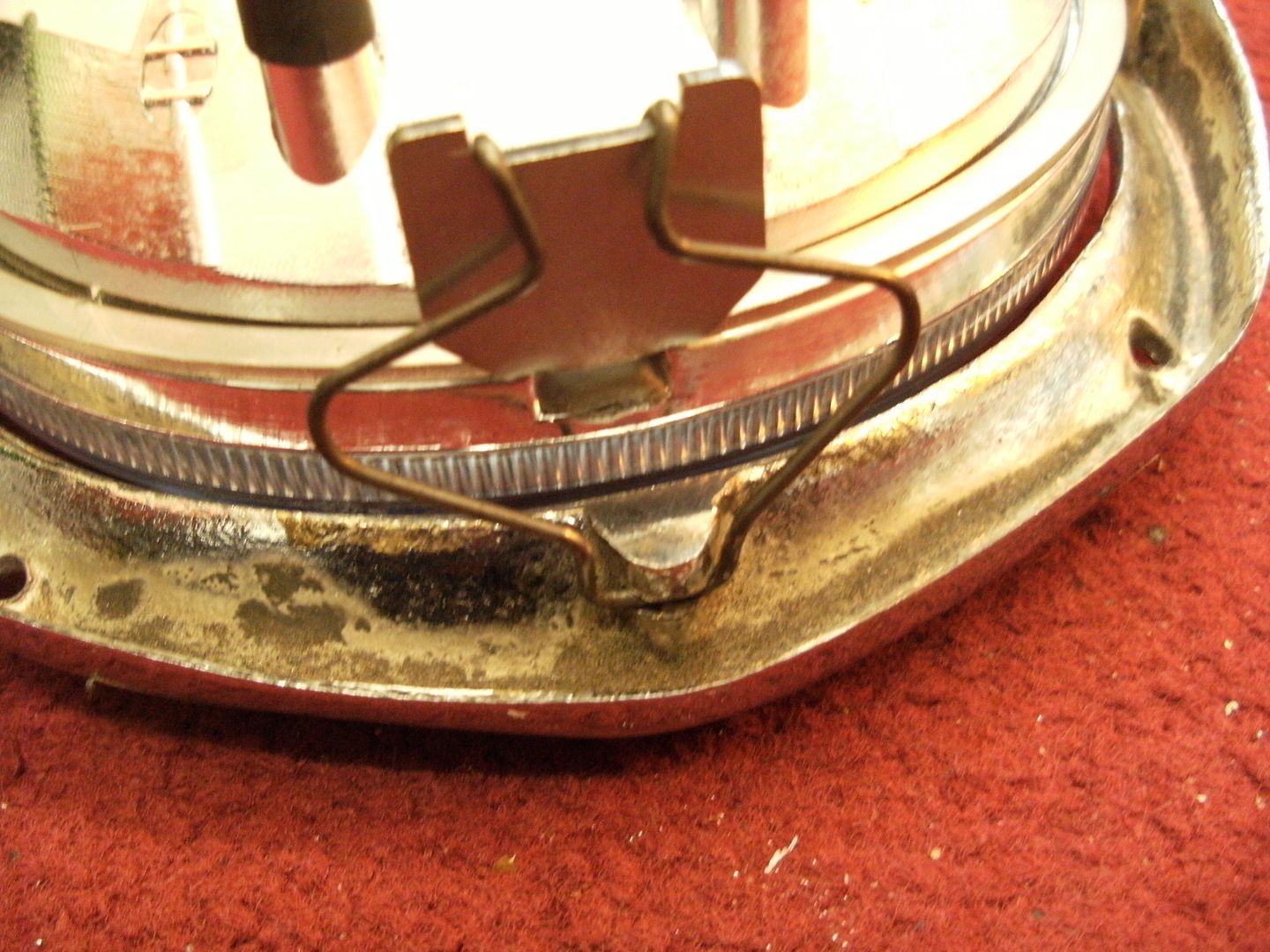

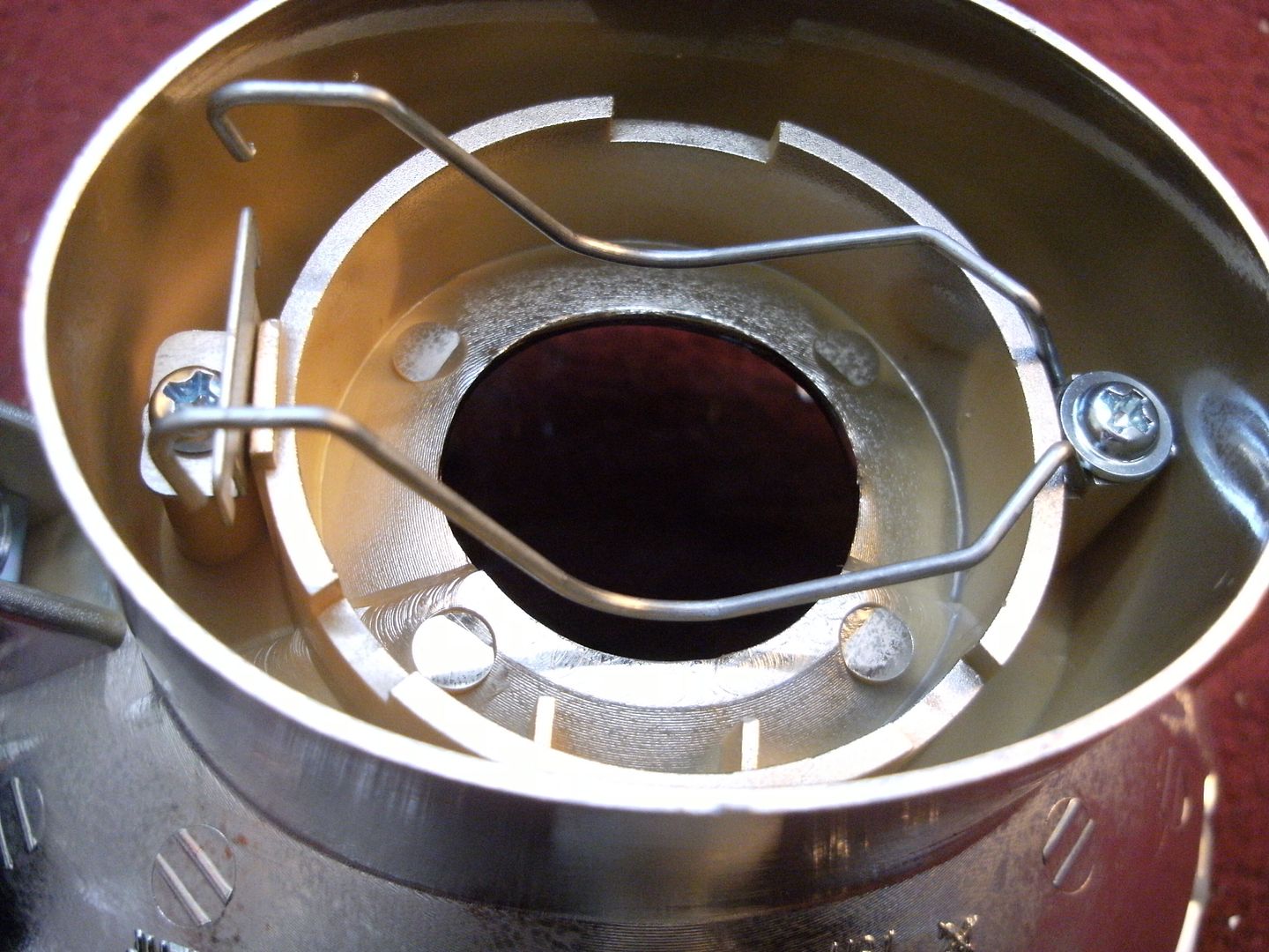

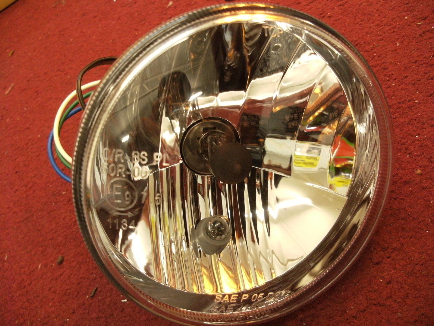

however, the light is really good and worth the effort... I also fitted one to my 150 special with the standard rim fitting...much easier...anyway, here are some pix of my wired up Jet....

Wago connectors is the way to go ! I'm on to it.

Postby MK Monty » Sat Mar 14, 2015 10:07 am
Great Lamydave. The pictures explain it all. I was looking at how to modify the ring to fit the existing rim. I presume you fit the JB then use the rim as front trim. Great. Got some wago's on the way they look a good job.

Re: Jockey Boxtenstop Headlight
Postby lammydave » Sat Mar 14, 2015 12:37 pm
MK Monty wrote:Great Lamydave. The pictures explain it all. I was looking at how to modify the ring to fit the existing rim. I presume you fit the JB then use the rim as front trim. Great. Got some wago's on the way they look a good job.
Yup... rim goes on last and keeps it all in place, make sure you push the headlight back as far as it'll go or it protrudes from the rim and looks daft...
great conversion though and the beam is a major improvement....

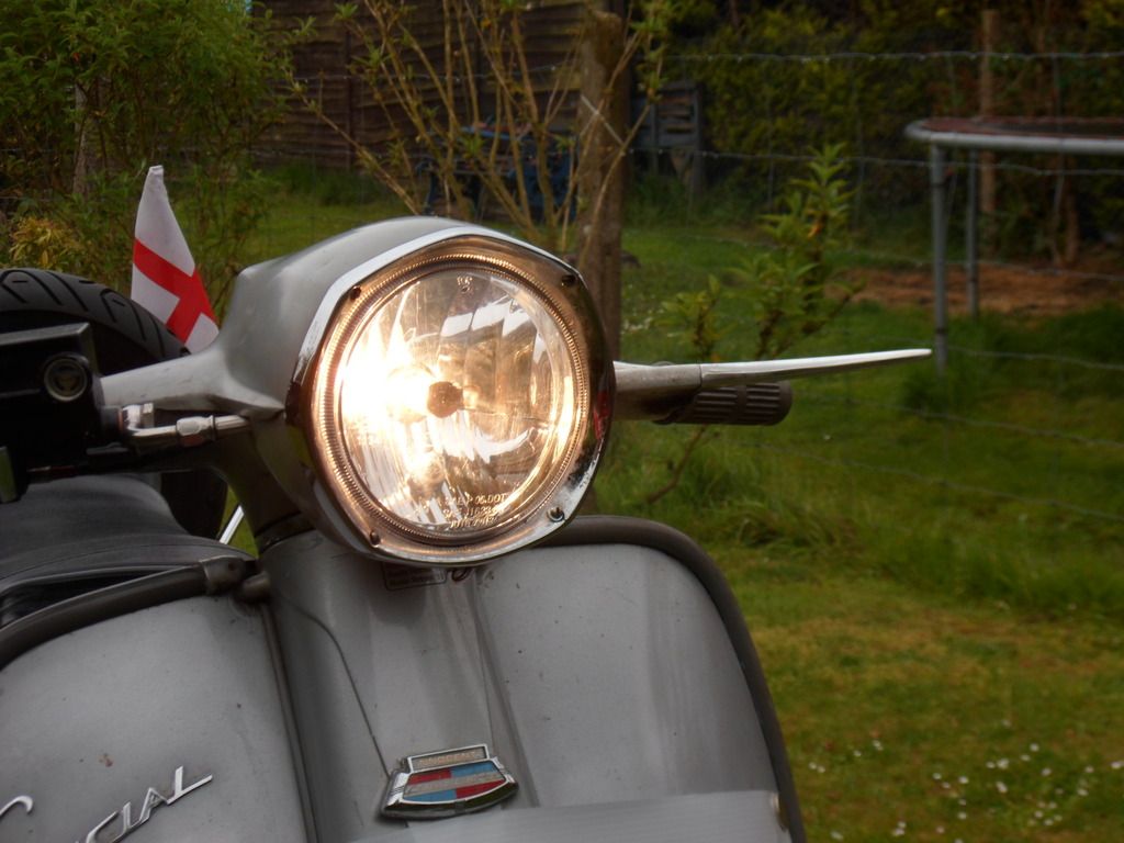

The pacemaker doesn't look too bad with one on either....
and she took me to Brittany and back last year...

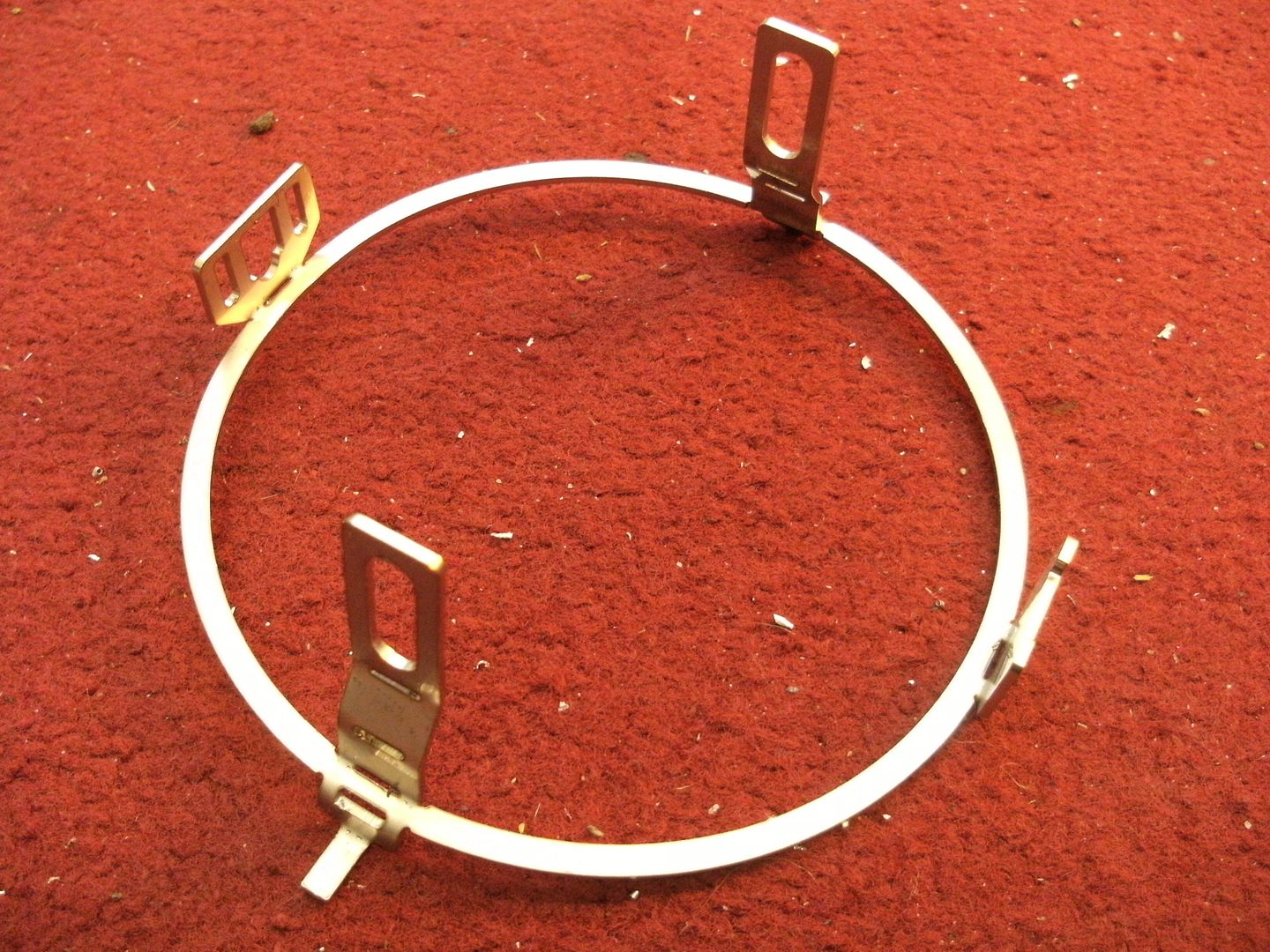

Postby MK Monty » Sat Mar 14, 2015 4:04 pm
Dave
The 2nd Pic showing the JB fitted, did the unit come with the fittings that go out to the sides of the head set or is that something you have made. When I did my series 1 all I got was the lasercut ring with the tabs that went back to the side of the lamp. Thats why I was struggling getting my head around fitting it to a special headset
Postby coaster » Sun Mar 15, 2015 2:19 am
MK Monty wrote:Dave

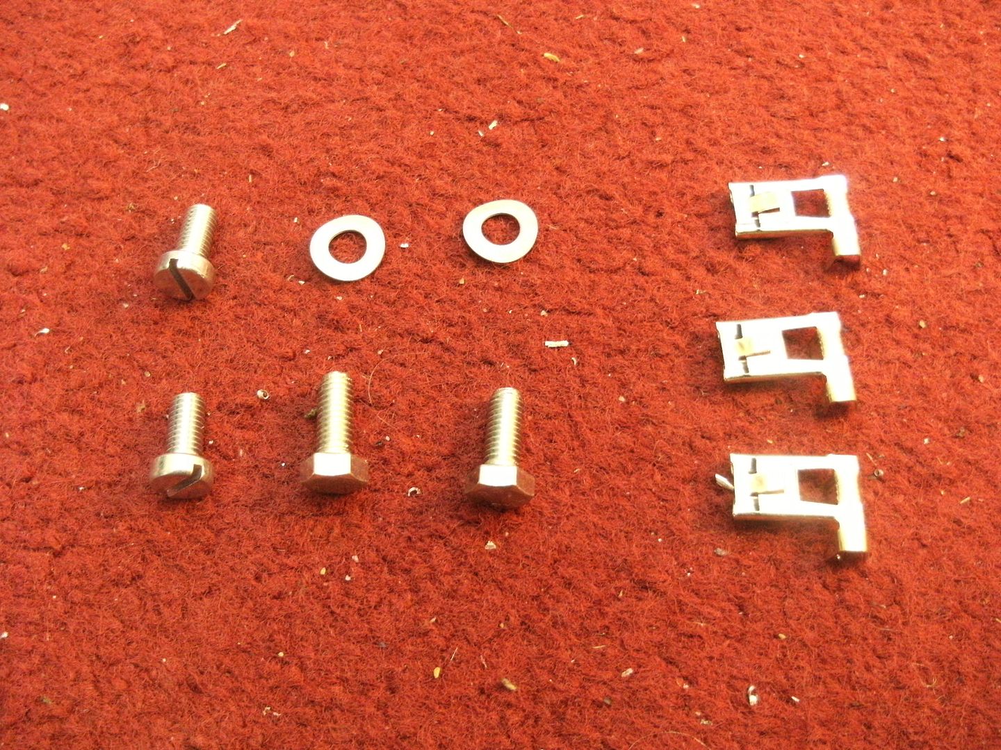

Monty, the laser cut rim for the Special/SX/TV is slightly different and doesn't have those outer arms for securing to the bolt holes in the sides (also on at the bottom). I didn't have those as my Jet previously had a Special type reflector. A set of 3 10mm screws, captive nuts, spacers and washers was nearly £20 from SIP :shock: Once the rim is fitted to the reflector, it assembles into the chrome rim exactly the same as the standard fitting using the spring at the top and adjustment screw at the bottom. As mentioned, I have another one ready to go in my LiS so I'll tale some pics of that in the morning.

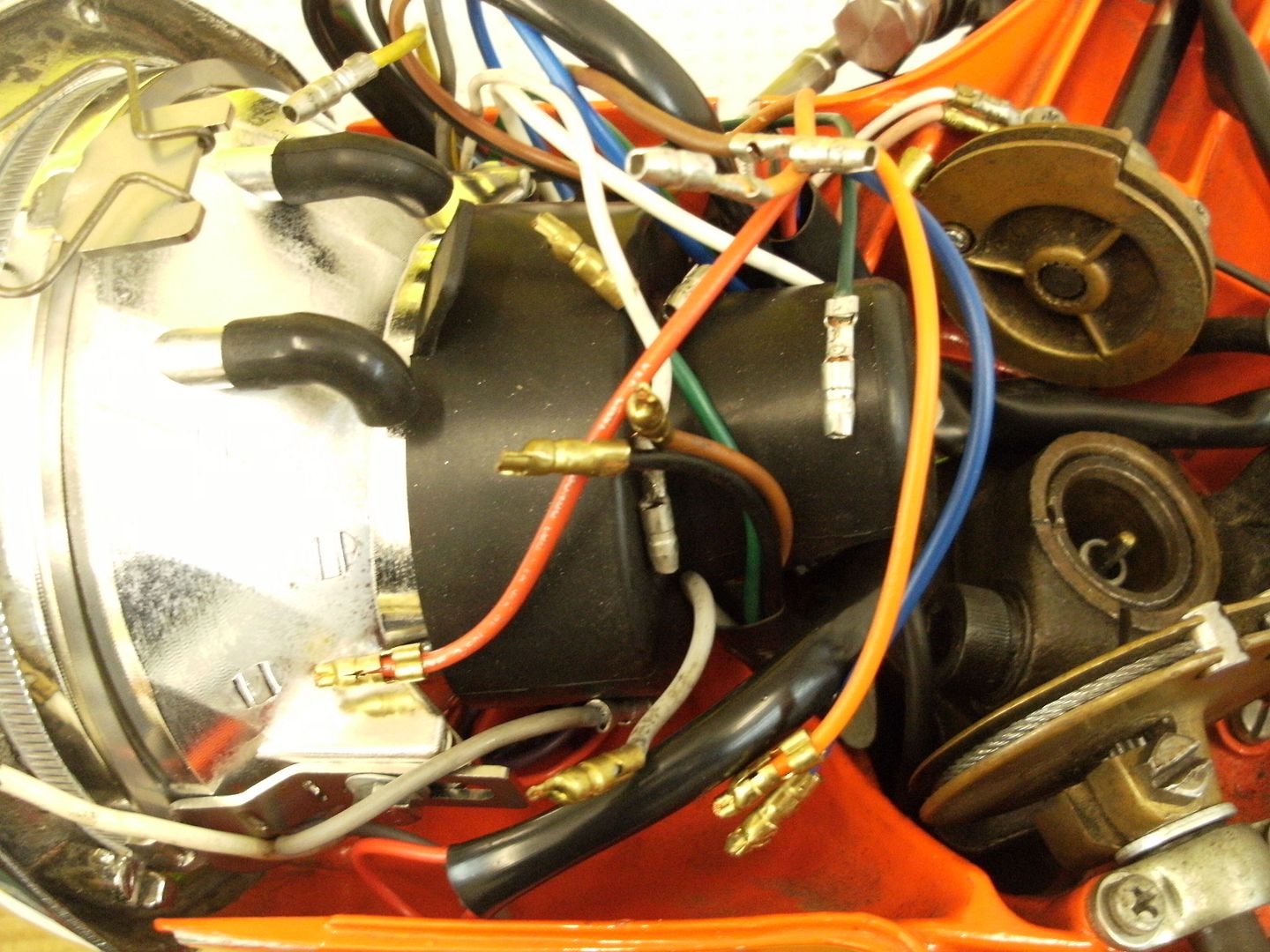

fitted this kit to my Pacemaker last year
the swivel points for the headlight adjustment were too long
it is very cosy in there now and you do have to loose the original connector block
bit fiddly to install but worth the grief
this is on a standard 12v electronic set up.
before
after
not ridden in anger in the dark yet but certainly shines a long way up the road outside my house :)

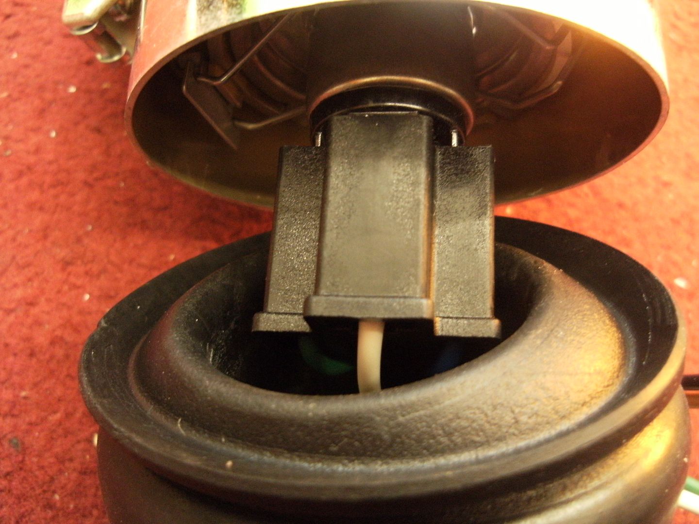

Here's some pictures of what you get and how I mounted the ballast after extending the wires, excuse the screw terminal block, I couldn't think of a better way that would allow easy removal:
