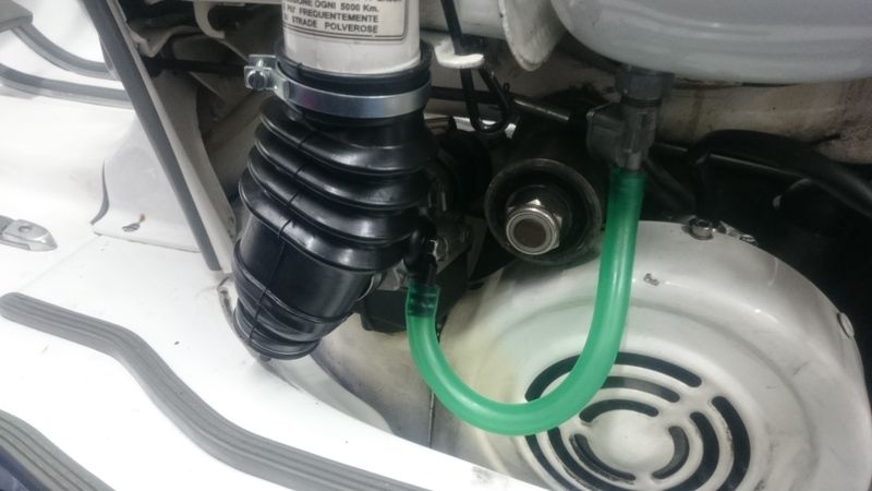

Checked the carb everything looked ok, noticed the fuel in the fuel pipe was bubbling with a big air gap. Switched it over to res,off and on no difference.
Hi Kris,
Do you have a kink in fuel pipe when sitting on machine.
Have you shone a bright light into the tank (LED torch) and looked inside especially where tap filter pokes through for any debris that might be clogging the filter.

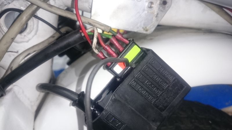

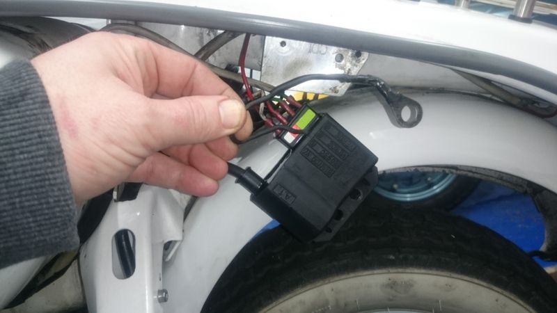

With a full day spare, I decided to start looking at the fault on the TV.
I've removed the CDI and noticed a loose earth wire not attached, could this be a problem?
So the wire to be removed is the top green wire is that correct?
Finally is the fuel hose too long to push fuel into the carb?

Fuel pipe is fine. Gravity fed and fluids always find their level.

Your CDI should be earthed to the frame. The white wire provides an earth via the stator base plate. You should also have a braided earth between engine and the frame.
Re: Running issues tv175
Postby Kristof Lammy pie » Sun Mar 13, 2016 12:22 pm
Right so I don't think I've got any earth's apart from CDI to base plate.
Kristof Lammy pie

I've disconnected the green switch wire so I'm going to try that out now.
Kristof Lammy pie
Posts: 298
Postby Kristof Lammy pie » Sun Mar 13, 2016 2:15 pm
Ignition wire disconnected and it runs fine! :D
So hopefully that's that sorted.
