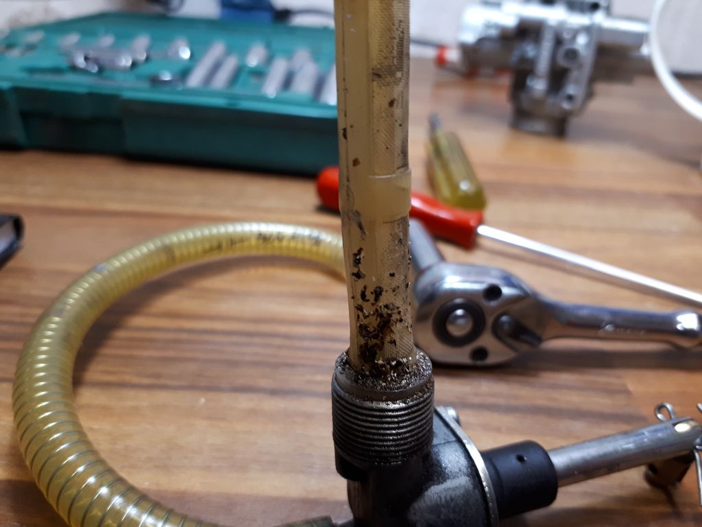

This isn't very pretty but surely it wouldn't affect running? Or would it?
Re: My lambretta doesn't work - any ideas?
Postby MickYork » Tue Apr 25, 2017 8:16 pm
certainly won't do it any good ..........are they metal filings ?
What's the filter on the carb' look like ?
MickYork
Posts: 1477
Postby Warkton Tornado No.1 » Tue Apr 25, 2017 8:32 pm
dickie wrote:This isn't very pretty but surely it wouldn't affect running? Or would it?
You could spread that on your chips! I think you should check carb filter (as suggested) & run any fuel through your tank & keep filtering it through a paint filter (that fits into a funnel) until you've cleared any cr@p out of the tank & fuel lines then strip the tank again to clean the tap. It's amazing what can get through...

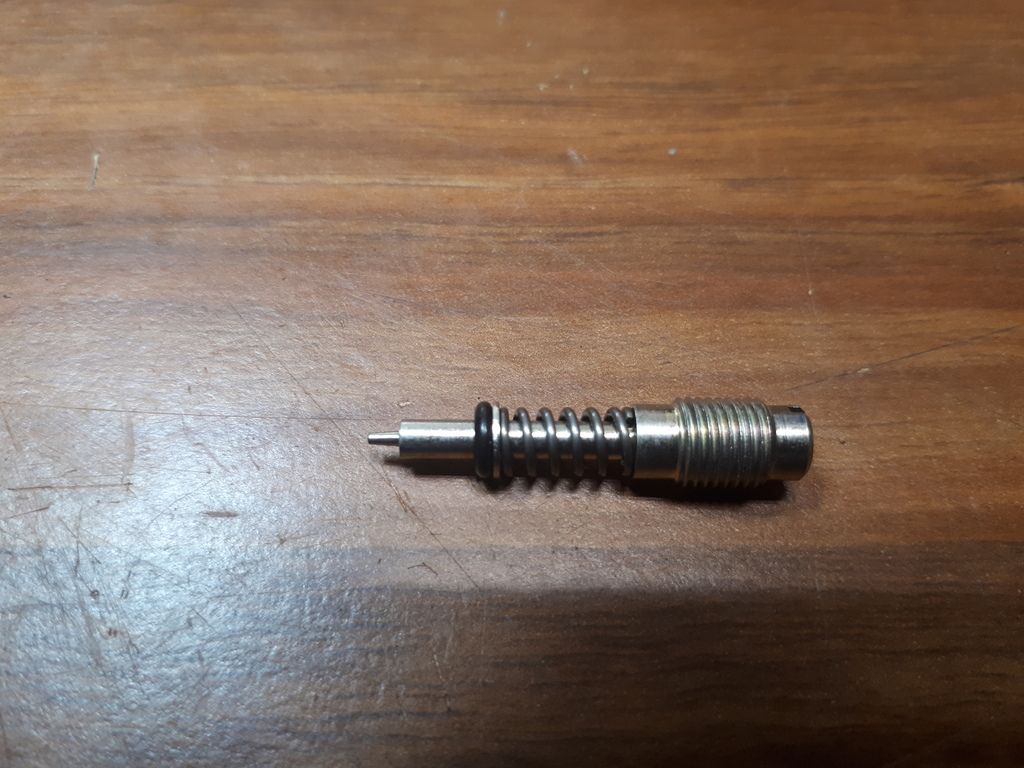

But I did discover this....
First pic is how it should be...
Second pic is what I found....
I must add that it has run happily like this for a year. Unless it somehow happened during the dyno session. Also I tried another carb; did I get muddled and put my carb straight back on?
It's the mixture screw in case you didn't realise. Can't try it tonight though. Unhappy family.
Postby Warkton Tornado No.1 » Tue Apr 25, 2017 8:46 pm
:idea: Fingers crossed for you, but that looks a likely cause...
