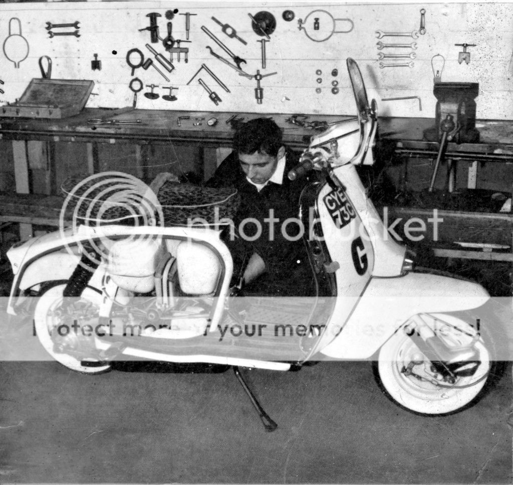

In '68 I had the Lambretta Official workshop manual, the one with the killer GT Series 3 on the front.
I always wanted this TV to be like that scooter, and I feel I'm well on the way now.
A school mate in '66 had an older brother into Lambrettas and he had one exactly like that pictured, I remember it so well.

The picture is the one that inspires, Sticks book has a similar one, but the books looks like a ridden scooter.
Got to have a fly screen, but I like the registration 'plate' on the leg shield, adds a period touch to the TV
