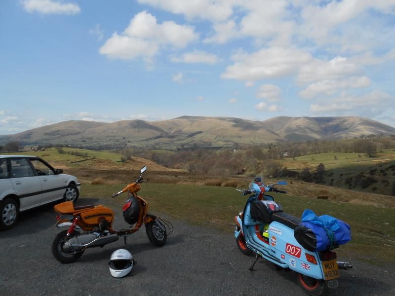

Postby Angry Bloke » Wed Aug 13, 2014 7:33 pm
^ Can't take the credit for this Martin - you guessed it the multi talented Mr Sadd 8-)

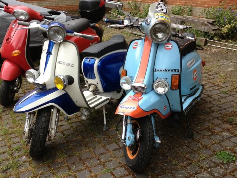

Postby Fireman Ash » Sat Aug 16, 2014 10:13 pm
This is mine

Postby Fireman Ash » Sat Aug 16, 2014 10:31 pm
Alternatively :D

Postby coaster » Sun Aug 17, 2014 9:36 am
If we're showing original fittments, here's mine, I actually think they look ok and with the led mod I mentioned above are very bright.
