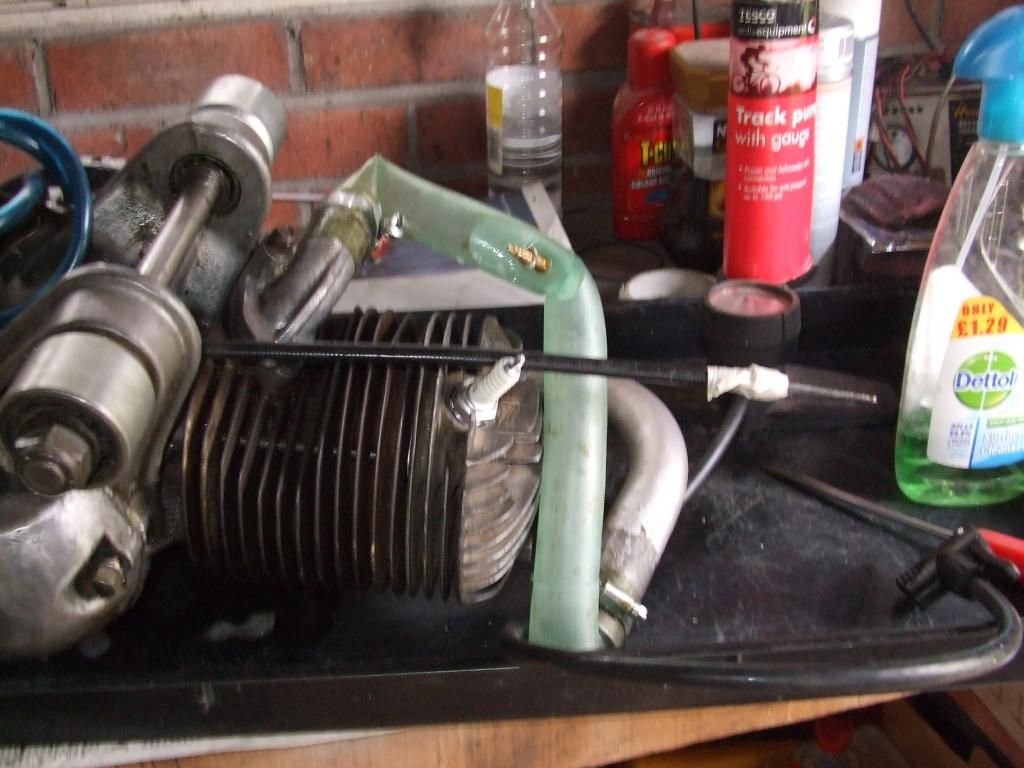

I also have an unsolved problem (gp150 misfiring) where I have changed everything.How are you checking for air leaks to test integrity of crankase seals? a cheap way is to use a cycle innertube and just pump it up to only about 5psi then spray all joints with soapy water. Left it overnight and took pic .Is your compression around 100psi.Just bought compression tester with flexible rubber pipe from screw fix for under £20 100 psi kicking it over and 110 pushing scoot in second gear
Good luck and let us all know how you fix it .Don't give up.
