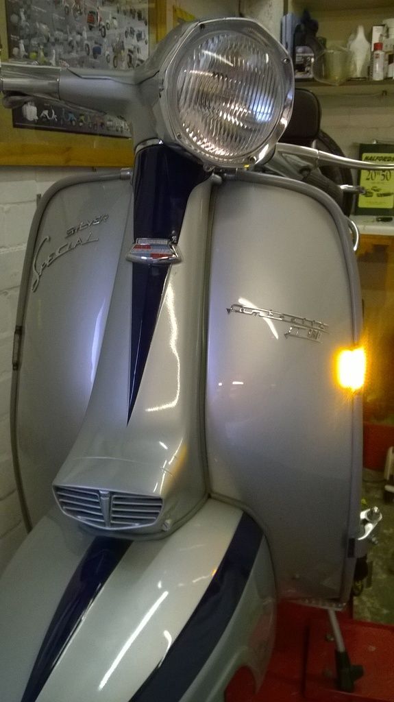

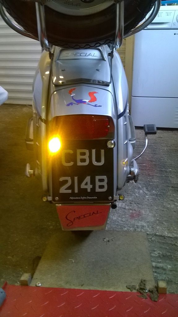

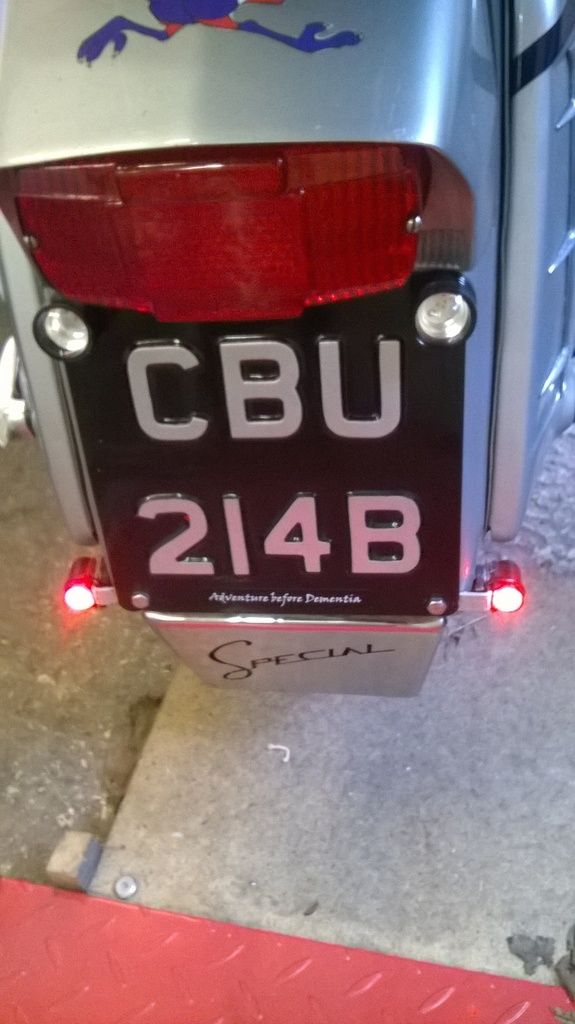

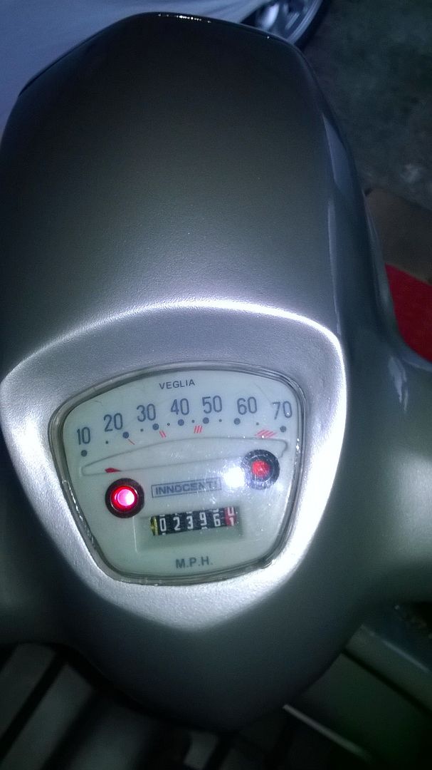

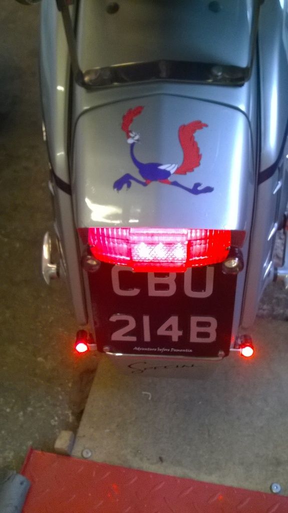

My indicators and more.
Front led indicators from BGM, very bright.
Led warning lights from Maplin
Rear led projector indicators from ebay
Very, very bright
Additional rear led lights
Get brighter when rear brake is applied
Switch from Maplins. Home made holder in stainless steel
