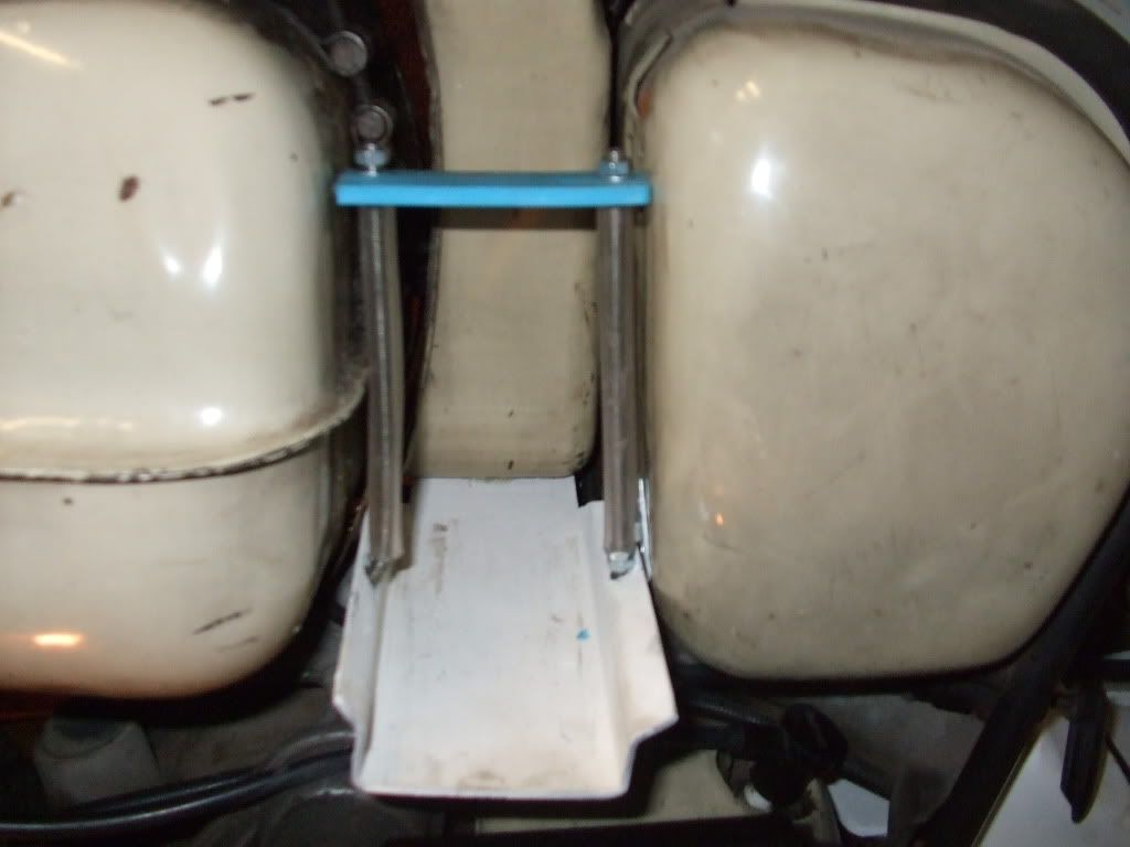

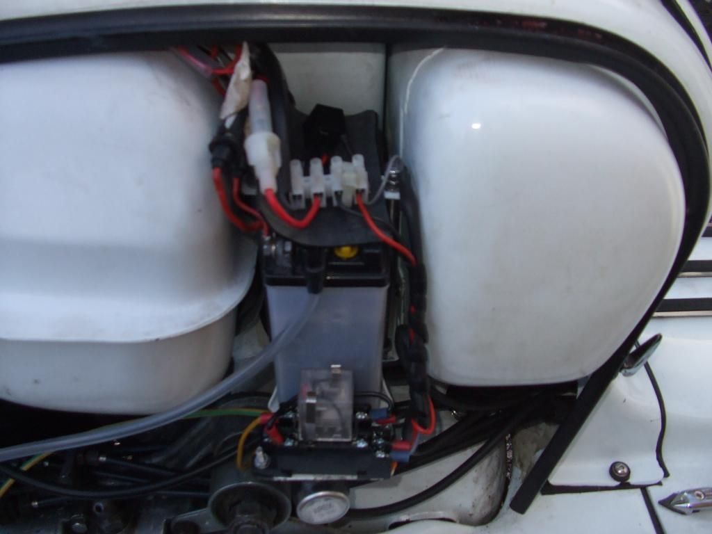

I used a 5 amp/ hr battery .If you don't have a battery tray you can bolt one to the underside of the air box.The wassell D.C mod is well worth fitting.I have separate inline fuses for lights, indicators and alarm.
Note right hand battery clamp thread lines up with hole in tool box enabling bracket to support weight of battery
Note inline fuses. The relays are for simple alarm. SIL GP 12volt DC still with points.
