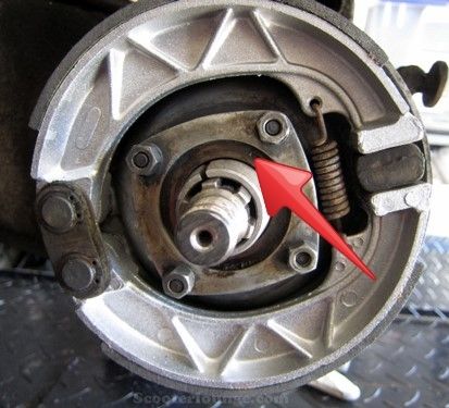

Very odd this one. I thought I noticed something a couple of weeks ago on the rear hub, ie a little play so double checked the torque setting on the rear hub nut and it was ok, still better safe than sorry.
However on the way back from the Luton Lambretta Clubs 60th anniversary yesterday thought there was something odd again, ie my rear brakes felt like they were occasionally sticking on. Here we go I thought, it's been a while since Ive done the rear brakes (I do favour the disc at the front a lot to be fair) so have just put her on the bench and found the rear locking ring has dissappeared and quite a wobble on the rear hub! Not massive but certainly not the normal amount! :o So hub off to find the following.
So, basically the rear hub seals obviously gone, bit of a pain but at least when I checked the layshaft it's all well, so that's a bonus, however I just need to sort out getting the hub cone out of the hub as it's stuck fast at the moment :-( So I think what's been happening is that a small amount of oils been mixing with the show dust and has welded it into the hub therefore not really doing it's job

aren't you missing the oil seal retaining plate?? behind the brg retaining plate?? :o

Nope, it's there, not the best picture but you made me doubt myself and ive just checked in the shed, it's definitely there.

hullygully wrote:aren't you missing the oil seal retaining plate??
Id agree Mick ............. First picture appears to be missing the retaining plate which is shown in situ in pic below.

Can i just reassure everyone, the plate was there, here's the bits removed

It's in that pile but it doesn't look like it's in your first picture?

Digger wrote:It's in that pile but it doesn't look like it's in your first picture?
Maybe so, but it was on there, not sure how many times I can assure that it was to be honest.
