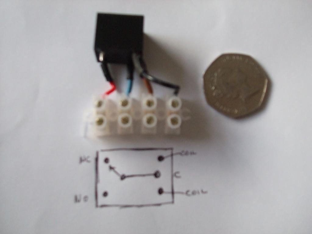

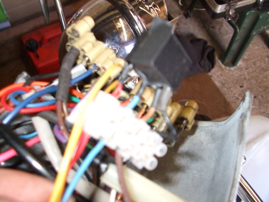

Wassel is up and running thanks everyone for your help , I just want to run 1 spotlight now do I connect up through the blue wire in the headset?

Postby Captain Pugwash » Tue May 26, 2015 7:52 pm
Your best using the blue wire to trigger a relay that feeds the spotlight.
It'll put less current through the handle bar switch and the low amperage wire that it normally uses.
Very easy to do plenty on here to offer good advice.

Postby grandpa » Tue May 26, 2015 8:26 pm
Hi Patricks,
I used a small maplins solid state relay JM67X 12v 10 amp However it is a surface mount relay so you need to solder some legs on it and use a connector block to wire it in.The blue wire would then go to one side of the coil the other side of coil to ground.12v from the feed (brown)to common and the spotlamp lead goes to normally open Turning main beam then picks the relay
The leds are run off festoon bulb as they use little current
The centre spots off the maplins relay
Grandpa
