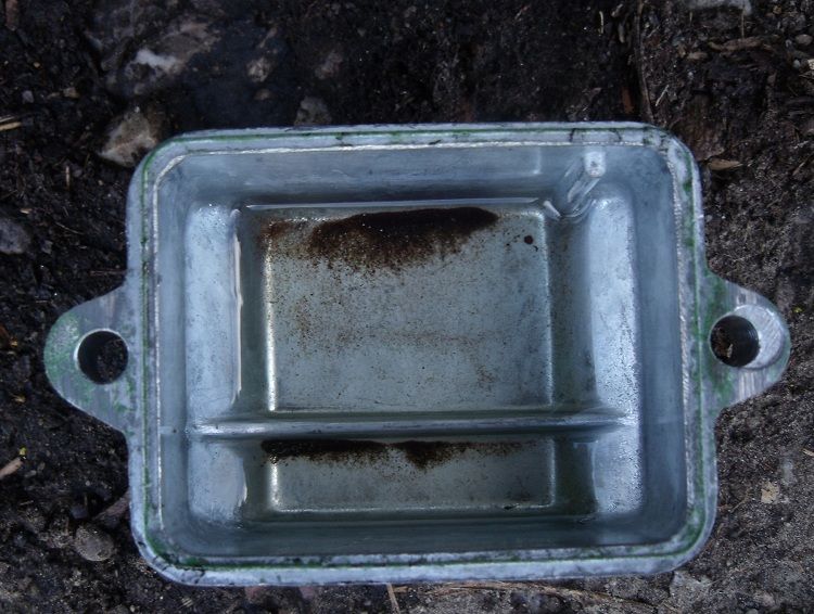

Its worth fitting a proper fuel filter between the carb and fuel tap. You'll be surprised at the amount of fine silt that gets through the fuel tap filter.Most of this silt is fine rust particles that the fuel washes off the inside of your fuel tank when its not been used for a while. Check the carb filter and the bottom of your fuel bowl for sediment

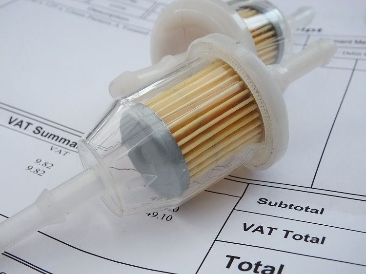

Postby johnnyXS » Fri Jul 17, 2015 7:33 pm
the only filters that clog up quickly are the ridiculously small filters that people seem determined to fit to their scooters and bikes because they look discrete. :roll:
A sensible sized inline filter would never clog up in years and gives complete protection and peace of mind against the tineiest of particulate matter.
The alternative (no filter) doesn't seem any kind of sensible option to me when you consider the amount of wasted time and inconvenience blocked carbs and jets cause out on a run when your scoot won't start and run ;)
Pretty it ain't but it does the job
[url][URL=http://s130.photobucket.com/user/peanutNboo/media/filter_zps2ipnshvw.jpg.html]Image[/url][/url]
johnnyXS

Re: Won't start....sick
Postby johnnyXS » Fri Jul 17, 2015 10:27 pm
its a good point Eden. For those runing high performance big bore motors with a tiny fuel filter it could conceivably have an effect on fuel flow .
However I would have thought that if a large filter had a significant effect on the fuel flow rate then either the fuel tap is too small or blocked or the motor is using way too much fuel.
The filter that I use on my scooter (pictured) I also use on my 650cc 55bhp motorbike which has 2x 38mm carburettors and it doesn't limit flow to them !
When I did a flow test on my filter it was flowing well over a litre a minute ! at that rate the tank would be empty in less than 5 minutes :D
