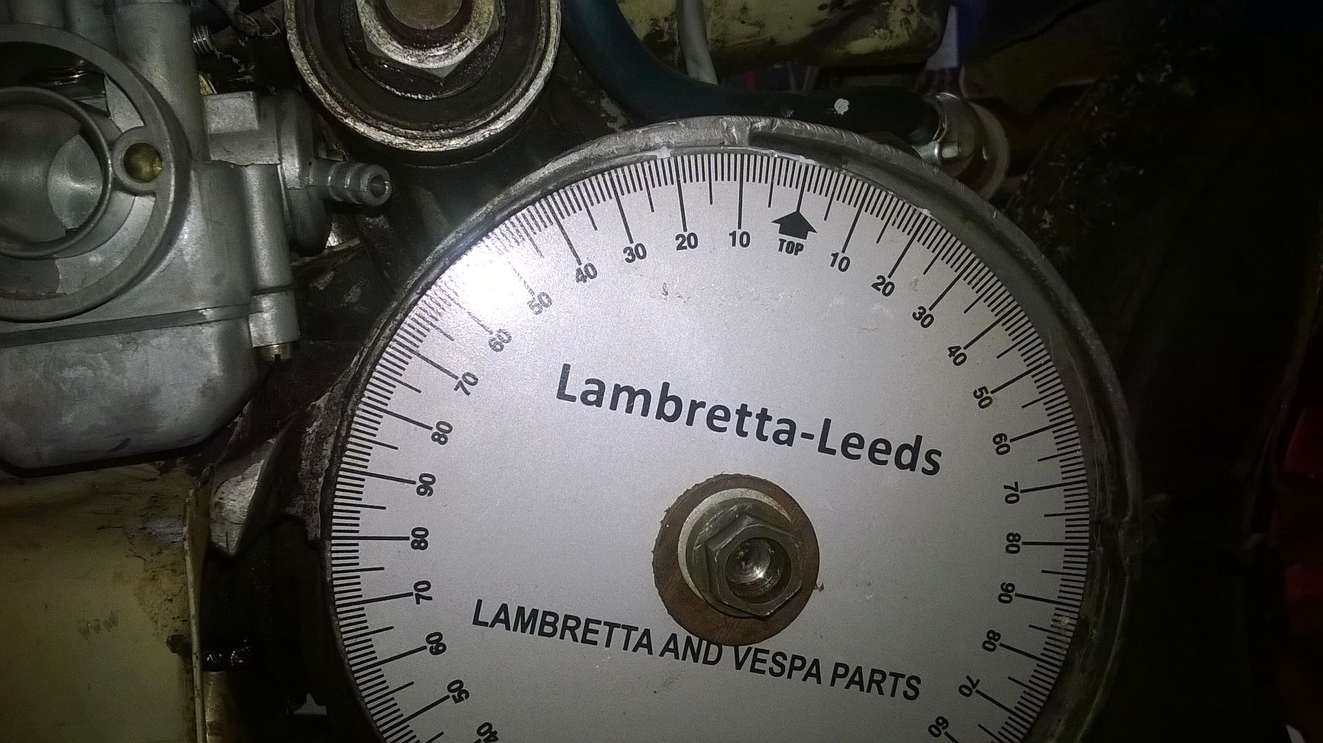

Hi All
I have just fitted electronic ignition to my GP. I made a TDC tool the same as in sticky's book drilling the centre out an old spark plug. Screwed the tool in the plug hole, turned the flywheel clockwise until the piston touched the tool. Marked that point with tippex. Turned the engine anti clockwise, again until the piston touched the tool, and marked that point with tippex. Found the centre between the 2 marks. Put on my timing disc on to find 19 before tdc. Here is a picture. Your comments please.
Stag
[imgImage][/img]

Well done :)

Hi All,
What I am trying to say, does this all look ok to fire her up to put the strobe on her to double check the timing.
Stag
kennystag
Posts: 536
Re: ignition timing
Postby Dimitrios_231 » Sun Dec 06, 2015 7:35 pm
Yes,go for it ;)

Postby HxPaul » Sun Dec 06, 2015 8:27 pm
I dont know if its my eyesight,but I dont see the timing marks.

Postby Meds » Mon Dec 07, 2015 9:40 am
Looks pretty good to me
But don't be surprised if there is a difference between static timing and the actual timing when it's strobed.
Sometimes the timing marks on the stator/flywheel can be a bit out.
Good luck

Hi hx paul,
The tippex mark to the left is 19 btdc, and the other in the middle is TDC, the other to the right is 20
Stag
