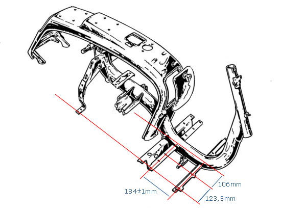

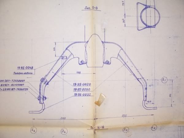

I am looking for plan of serie 3 frame in order to have quotes to weld a new middle (stand) strut and the left rear strut (side panel) at the right place.
I have found some info (picture) on google however the resolution is not good enough for me to figure out the numbers.
Can someone help?
Kind regards
Rhinomerc

Postby Andyf » Thu Dec 10, 2015 9:38 pm
what a lump I am, I've kept some drawings for years thinking one day someone would need a copy. first time they do and I find mine's exactly the same as yours - absolutely useless when zoomed in. obviously the same file :(
doh.
https://www.flickr.com/photos/31105097@ ... ed-public/

Postby Rhinomerc » Sat Dec 12, 2015 4:27 pm
Hi
Good advises. Finding a JIG and an experienced lambretta dealer would be the best.
Unfortunately, there a no lambretta dealers here in Paris (yep i am in france).
So I could to build up my own simplified Jig... And find out those measures.
@knowledge: this is the picture I have, pretty but useless :(

Postby Rhinomerc » Sun Dec 13, 2015 4:02 pm
Hi All
First, thanks a lot for the pics. I saw these ones but not in this resolution. Great!
And good advise for the prefitting and welding, thanks.
As i will do both the middle strut and the left rear one. I will have to find a way to keep this later from moving. I am thinking of some way to attach it to the rh side one. Any advise?
And for removing existing one, what would you recommend.

Postby Rhinomerc » Sun Dec 13, 2015 6:27 pm
Yep you can see here the 5mm between bottom of the top of chassis and the top of the central strut.
