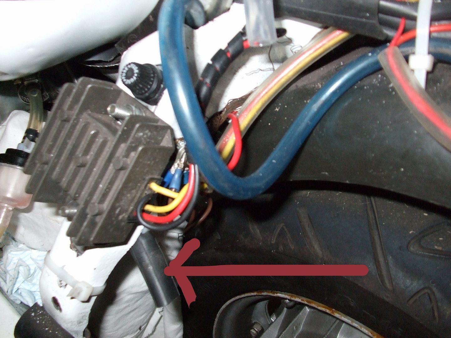

As Ross states it is easy to fit an isolator switch.Instead of bolting your battery earth lead to frame you connect to earth via a switch (15amp toggle switch).Mount it on the rear near side dog leg, slide it inside a piece of cycle inner tube to give it some protection from elements.
Grandpa
pic added 16:54
Note flywheel cover has cloth over it as I keep dropping screws through the grill.also note earth point just above switch for wassell,braided earth from ht coil,engine and battery earth via switch
