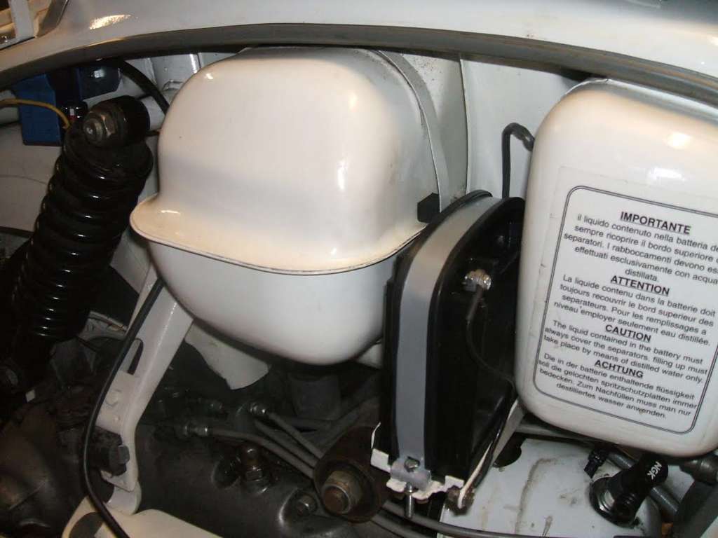

Postby Geocamper » Fri Aug 12, 2016 10:10 pm
Yuasa in my series 2 TV.
