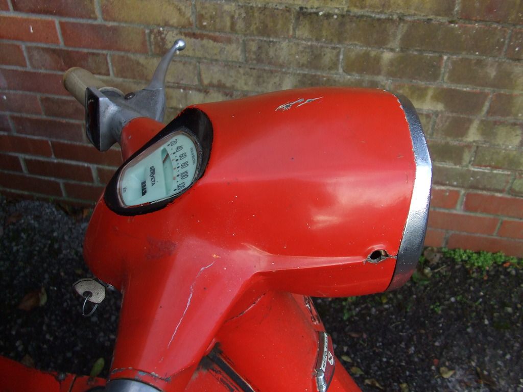

I have recently bought a Jet 200.Rather than drill holes in the headset top to fit mirrors ( Like my Indian GP with MKII headset top) I would prefer to buy another headset top to drill holes and keep the original unmolested for if and when I sell her on.Will a Li headset top fit, is there a difference between a Li and a Li special?
This is the current headset top ,scoot has also been fitted with Li type light switch /throttle assembly.It has a 'thrupenny' bit headlamp rim
Would this fit? Looks a bit rounded rather than pointed at the top

You'll need a special type headset top to fit a jet.

Standard Li's are round,specials are SX shaped.The one on ebay is for a standard Li and wont fit on yours.Why not get a front brake lever adapter to fit a mirror on.http://www.ebay.co.uk/itm/Lambretta-Ves ... xyBvZTUjDU

Have I missed the bit where somebody points out that the Serveta headset was re-engineered from the Innocenti Li-S type to incorporate light adjusting screws moulded into the sides of both top & bottom? That's what I see in the photo...
IMHO what you have now doesn't look too bad. I think it will look fairly gash if you only change the top & not the bottom, but beauty & all that.... It might have crossed your mind to try & restore the headset back to it's original format, but I'm sure a Eibar aficionado will come along shortly....
BTW later tops had holes for 'idiot' lights above the speedo & even later ones were clothed in fibreglass shells, thus proving that you can make a pig's ear out of a silk purse :)

Warkton Tornado No.1 wrote:Have I missed the bit where somebody points out that the Serveta headset was re-engineered from the Innocenti Li-S type to incorporate light adjusting screws moulded into the sides of both top & bottom? That's what I see in the photo...
Apologies, there is holes for headlight adjustment in the side of a Jet headset. Been so long since I had to adjust mine.
