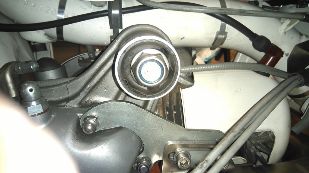

Is this knackered?
I'm taking the motor out anyway, so it's easy to change while I'm at it. But is it dead or am I being a fanny?
Re: Knackered silent block?
Postby HxPaul » Wed Jan 04, 2017 11:23 am
The rubber has become unbonded from metal of the mount,I would change it.I have one of these on the kickstart side http://www.afrayspeed.co.uk/index.php?p ... tributeID=

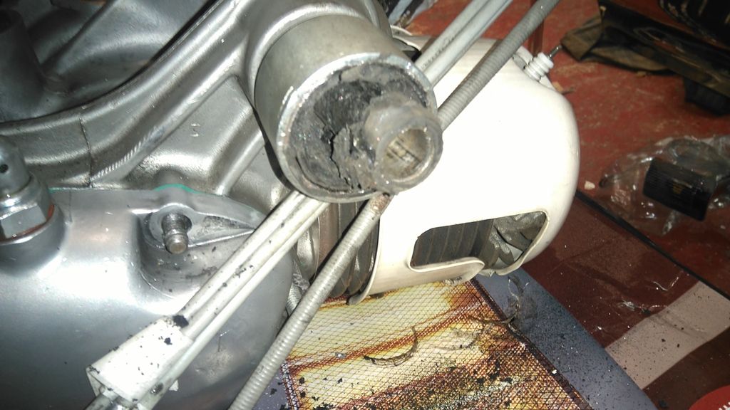

Postby ToBoldlyGo » Wed Jan 04, 2017 12:32 pm
It's worse than that. It's dead Jim.

ToBoldlyGo wrote:It's worse than that. It's dead Jim.
Well it is now!
In case it's not obvious the engine bolt was a little reluctant so I "got medieval on his ass" to quote a classic film.

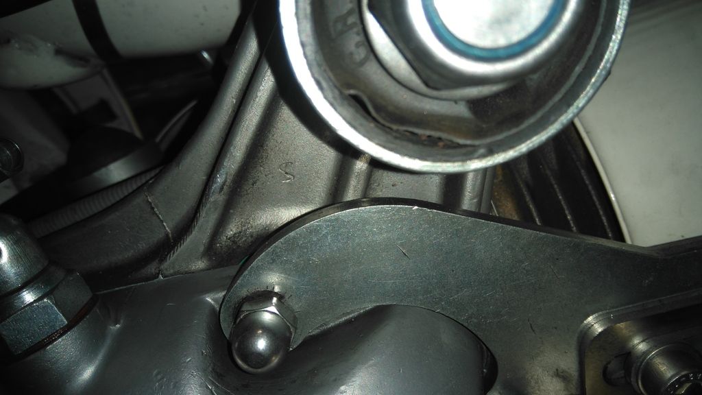

Postby gaz_powell » Wed Jan 04, 2017 2:08 pm
out of interest what make are they ??
looks like CRP then a SIL `S` logo ??

gaz_powell wrote:out of interest what make are they ??
Gaz, I thought I'd bought bgm but noticed the SIL logo too so I guess they must be SIL?
If it matters I can look back through my records tonight and be sure.
Postby gaz_powell » Wed Jan 04, 2017 3:37 pm
I was just interested to consider the brand when buying new.
It wasn't the SIL part that got me wondering but the CRP initials ?
Ive seen the 3x hole with SRP (Scooter Restorations) and S logo...........and used them successfully. Ive never had an issue with SRP ones (still have them in one bike) and am using AF/Uni ones in the S2 and SX, to date they have proved fine.

Postby gaz_powell » Wed Jan 04, 2017 5:30 pm
Cheers Dickie
Interesting......as is the price !
I've have considerable more mileage than you quote out of SRP and the Uni ones in TS1 motors.
