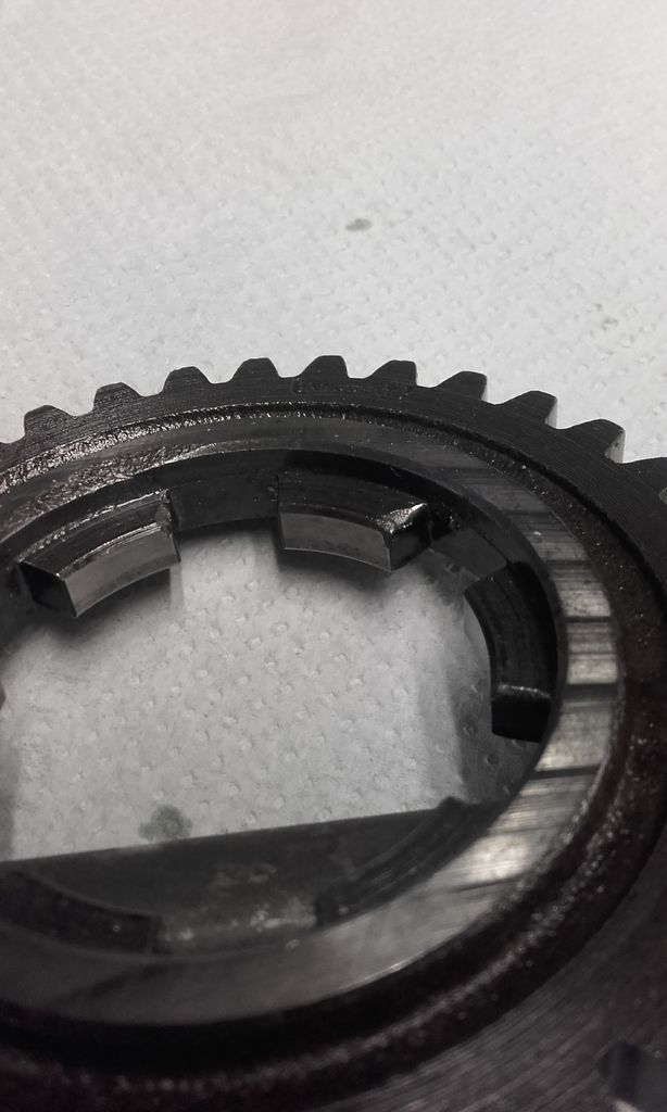

Talking of loosed gears, ;) This is the 4th gear of an Li150 gearbox.Has done several seasons of sprinting with no probs until recently.Will I get away with this damage or is a new one needed.? If so does anyone have one spare? Thanks

Postby Wack » Sun Apr 30, 2017 6:51 pm
The 3rd gear in my sprinter did the same and always jumped out under power, replacement is the only cure.
