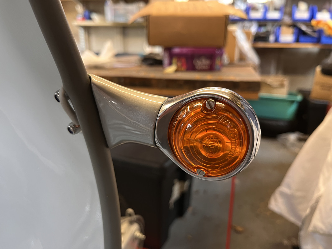

Now moved on to sorting out the wiring and cabling before fitting the ignition and finally putting the engine in the frame. This picture is just to show my attempts at hiding the indicator wiring under the leg shield beading.

That looks tidy Paul, you shouls see the birds nest of wires under my horncasting :? :( :roll:

I have seen it, mate. Bird’s nest in the headset and spider’s web under the panels if I remember right.
Hopefully, I should be able to get rid of a fair few of those wires. It’s an MB loom that has wires for front brake light and fuel sensor. Neither of them are needed.

Look like they're supposed to be there. I was worried you'd have them sticking out the horncast on stalks, but that looks way better.

They're VERY nice!! 8-)

Thanks. Resin copies of original housings. As they are resin and not metal the indicators need to be earthed to the leg shields. I can only guess that the original wiring was hidden under the beading like I have done. The T5 “buzzer” is only dead small so is hidden in the headset.

Very neat, I do like what you've done , Paul 8-)
