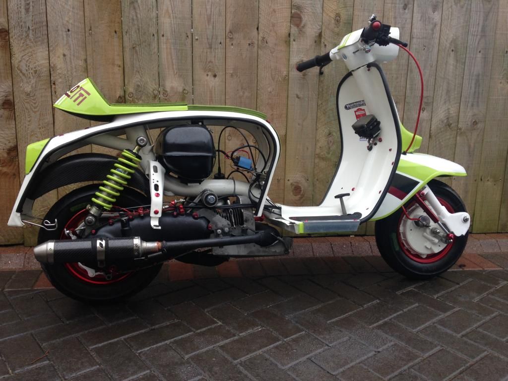

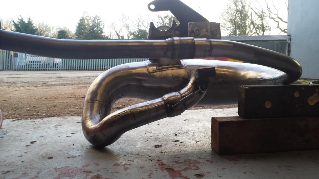

Here's a couple more pics out in the light , you can see how different the routing of the pipe is compared to say a standard road pipe.

Very nice Daz, good colour combination 8-)

Looking great mate ............... Anything I can do just let me know.

Agree, looks spot on. All the best for the season.

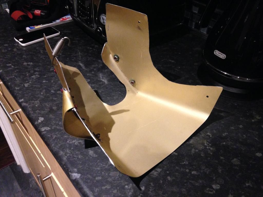

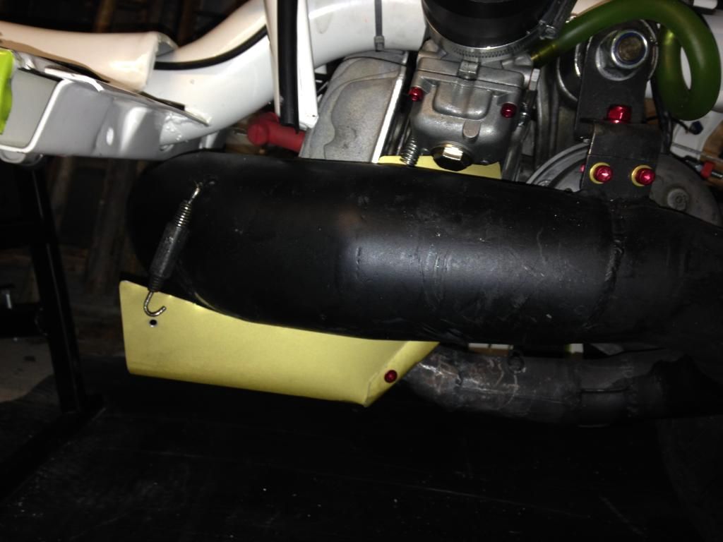

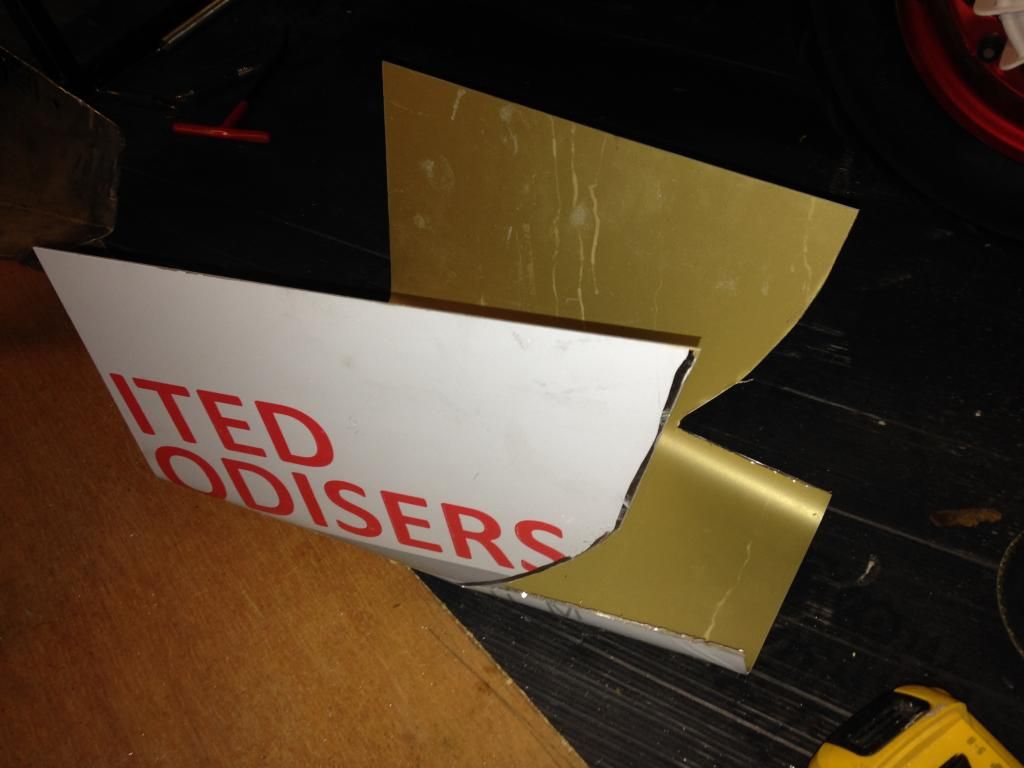

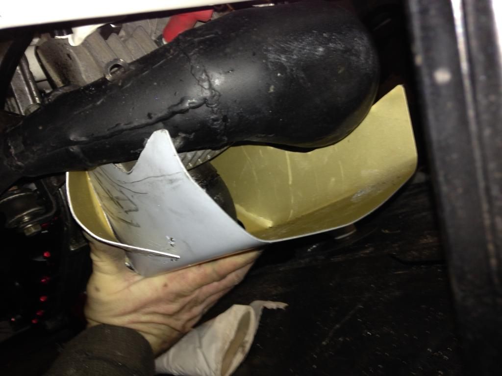

Thought I 'd have a crack at making a new airscoop as the one that came with the motor was a bit battered. Still doing it's job but I thought I'd try to improve.
I loant a fiberglass one to copy off or get an idea from. Thought I'd have a go in ally.

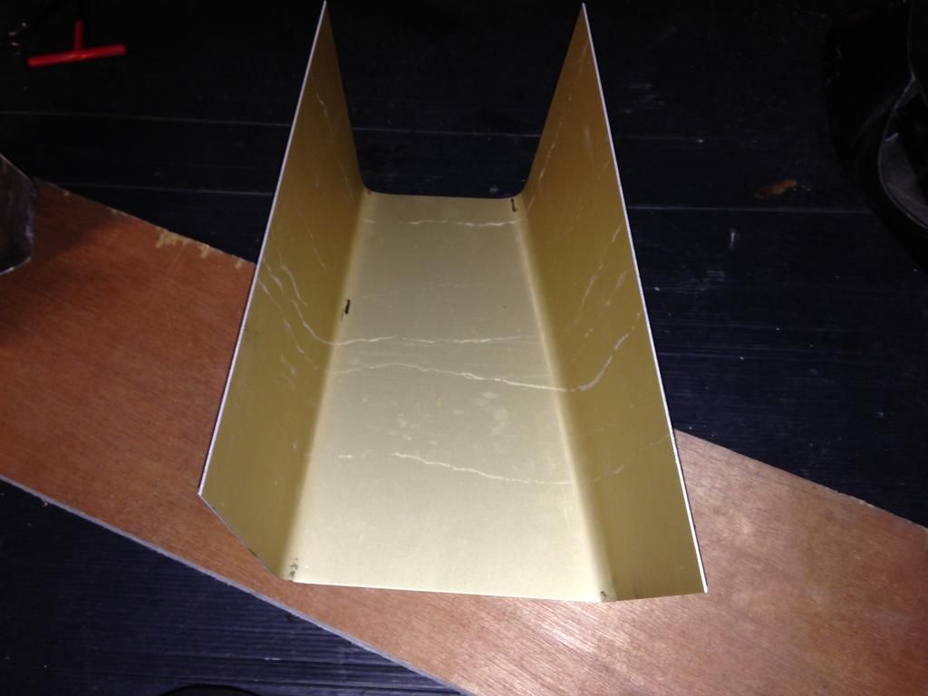

I 1st folded up the sides.

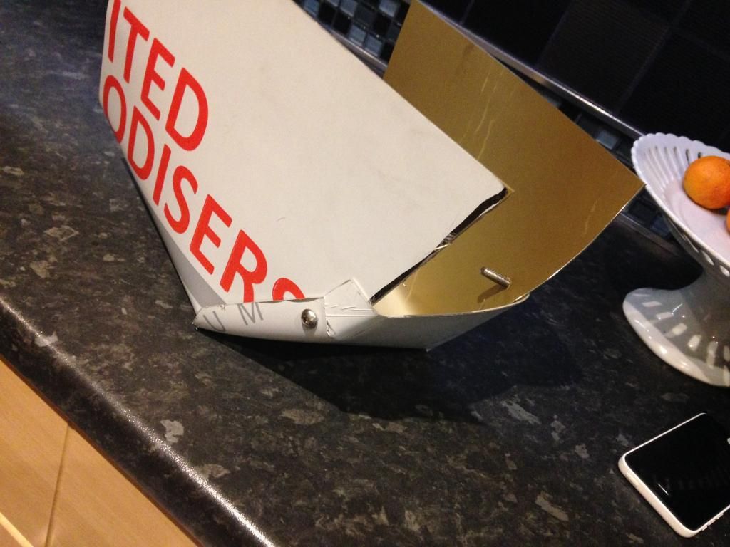

Then cut and folded the back up. Putting a couple of bolts in to hold in place.

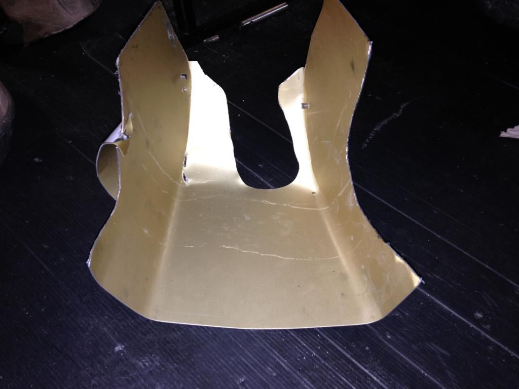

A bit more cutting and shutting but it's taking shape.
And fitted into place. It's getting there.

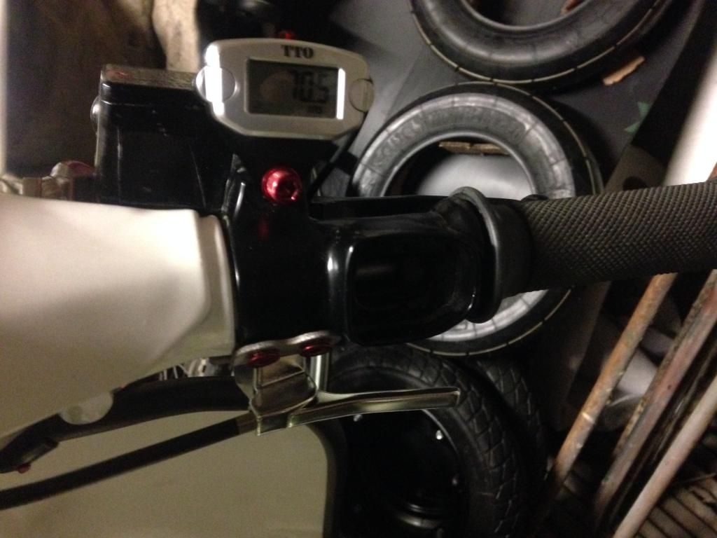

Just fitted a TTO tacho and runtime gauge. Also a choke lever close to hand. Just in case things end up in the danger zone.

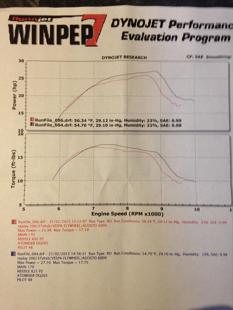

Here's the dyno graph. The blue line is where I had it. The red is where it ended up. I wasn't that far out considering I couldn't really get out on the road that much with it being a race bike. The red is jetted on the safe side so hopefully not to nip it up.
Bearing in mind this is a 205 cc it's quite good.

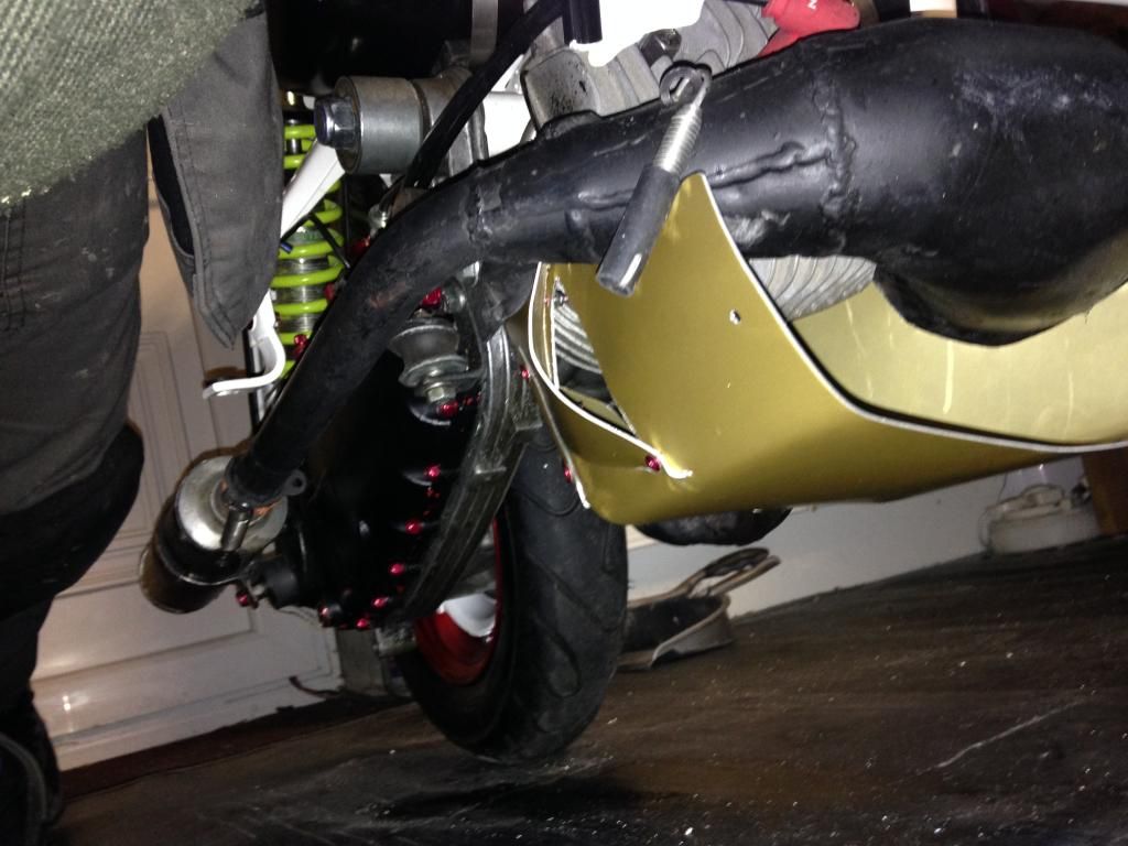

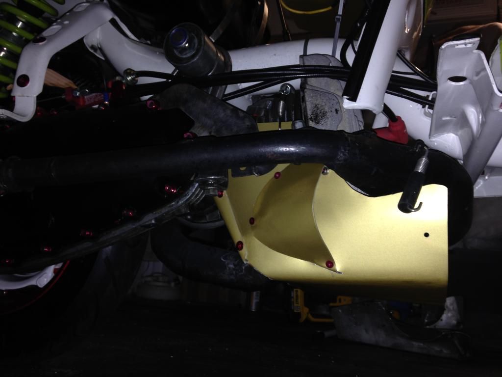

Decided to bolt this together as the ally is anodised. It's well loctited and nylocked. Hopefully it will hold together !
And fitted.

I've decided I'm going to fit another level into the scoop. It will be like a shelf which I going to angle up towards the exhaust port. Rather than just a big volume of air going into the scoop , it will be directed.

Im no expert here Daz but would it not be better to have a 'top' to that scoop so youre not dragging hot air from the pipe onto the head? Is a good suggestion?..... or..... should i just STFU :mrgreen: ... ;)
Andy.
xenia1
Posts: 1390
Re: My group 4

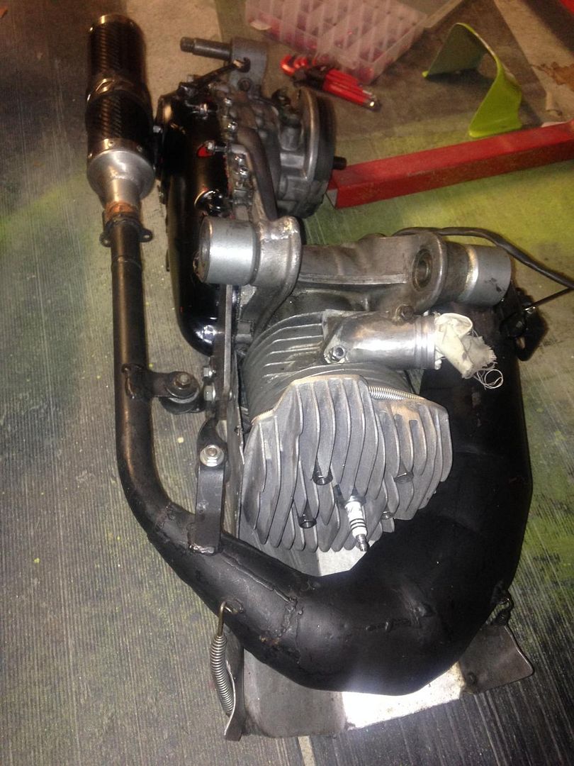

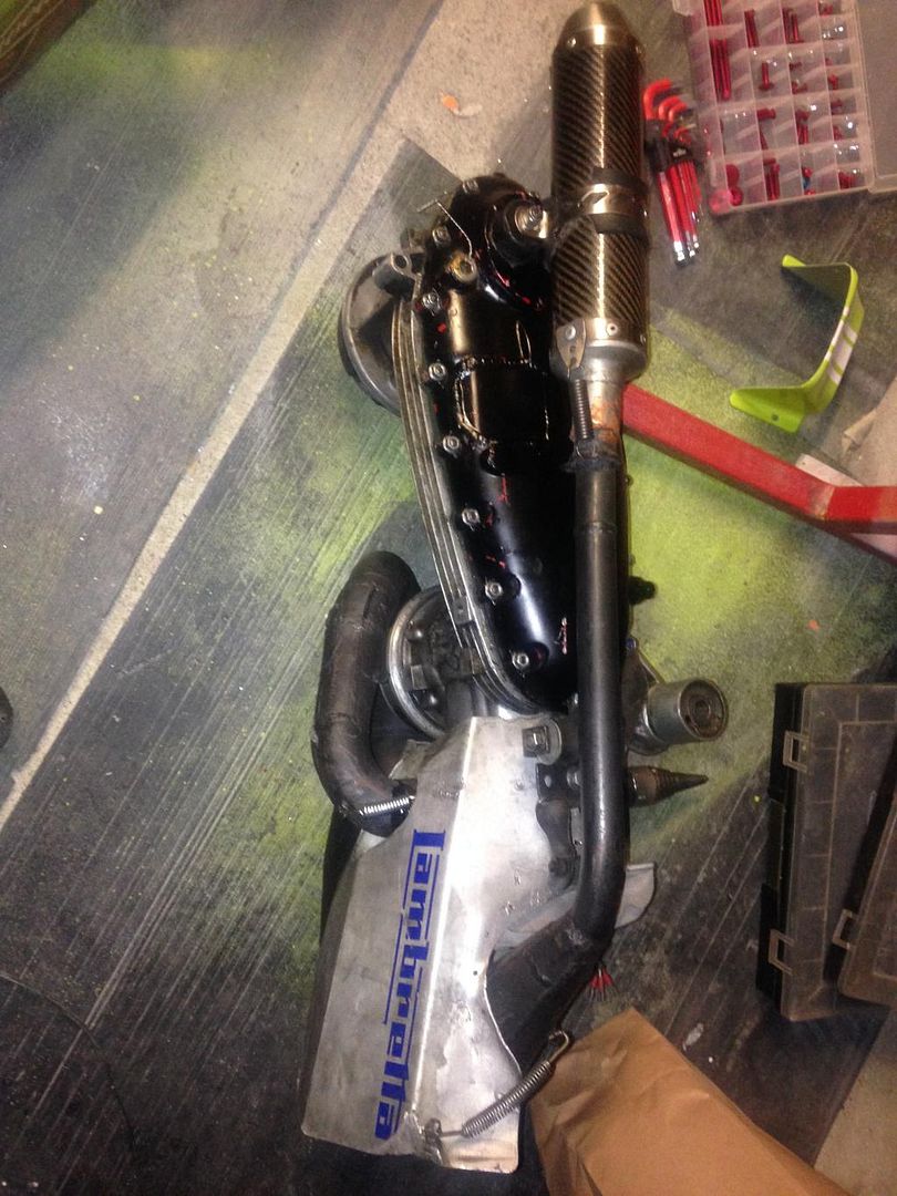

Postby Dazts1 » Mon Mar 02, 2015 6:59 am
Hi Andy.

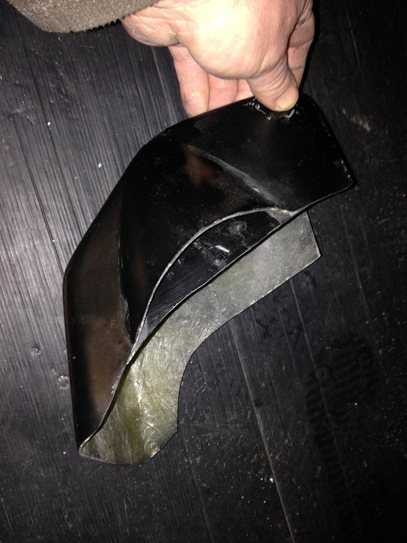

Yes I know what your saying and in theory I would think your correct. But the motor I purchased has been ran in group 4 successfully over 2 seasons with the scoop as is in pic. I've put up another pic to show the scoop that came with the motor. I think that the pipe must be getting cooled as it's up front( before the head) so it's heat disperse must be little ? I 'm only guessing of course. The head must gather cool air with its size. I think the scoops main job is the underside of the cylinder , exhaust port.
Re: My group 4
Postby Dazts1 » Mon Mar 02, 2015 10:26 am
The other option I had thought of was to put exhaust heat wrap around the pipe to push the heat through. A lot of car tuners do this mod to get heat from the engine bay.

Yep , all seems to be the fashion in group 4 these days long stingers :)
Re: My group 4
Postby Dazts1 » Mon Mar 02, 2015 10:10 pm
It is a longun but possibly not as long as this
This is my new pipe by the way.
Re: My group 4
Postby dscscotty » Mon Mar 02, 2015 11:20 pm
Andy.
It'll be fine, we used to run ram air cooling on our group 3's with standard lambretta heads and cast Iron barrels without over heating issues. 60mm bore x 54mm stroke@ 10'000 rpm- No alloy barrels in our day Daz!
Looking good mate, you getting excited now?

Dazts1 wrote:It is a longun but possibly not as long as this
Is that "John JAHSPEED Howe`s" handy work Daz....????
Its all looking good, is the ali airscoop designed to be more durable than a fibreglass one, when traveling across rumblestrips onto the grass/gravel.... :lol: :lol: :lol:

Ha ha col. Yeah it should be more durable than the fiberglass version. But yeah it probably will see a few rumble strips. I seen some pics of mikey (on the jb bike ) dragging his fiberglass scoop around the track. Just didn't want this to happen.
The pipe is john Howe 's I haven't recieved it yet. I'm sure you'll agree it looks a work of art. I'd already set john away making this pipe before the motor I now have became available.
