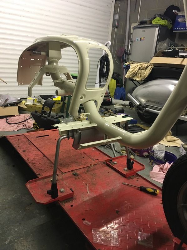

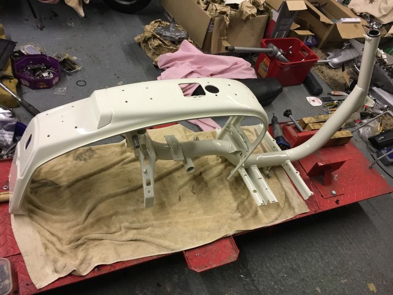

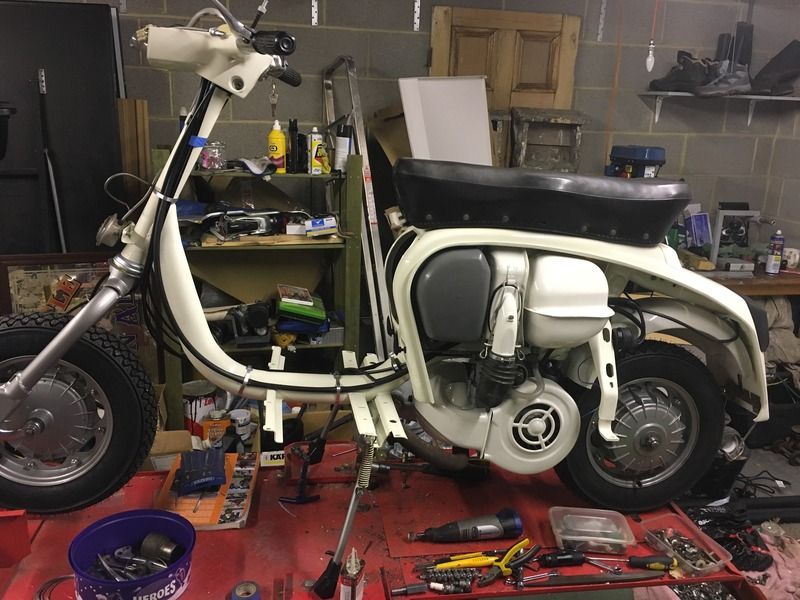

When I'd finished laughing at WT1 comments I dropped the panels off at the painters and set about the engine build.
The build was just a general clean up and new seals bearings clutch and piston rings. The piston and bore looked fine so keeping it 125 on 6volts and points.
3 months of the painter messing me around and I went to pick the bits up and find someone else. Massive thanks to
Jason Frost and Tony at Absolutely scooters in Sheffield who fit me in and did a superb job. So ready to start the build around end of September
Frame had new bearing races top and bottomm
Forks rebuilt with new springs and buffers
New wiring loom and cables
Cleaned up the original exhaust

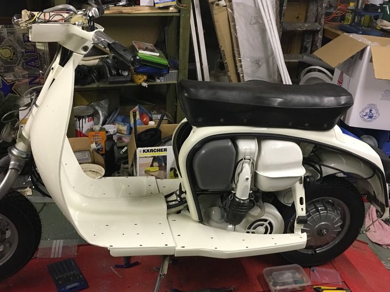

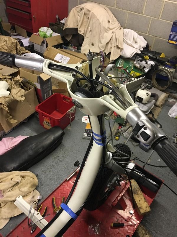

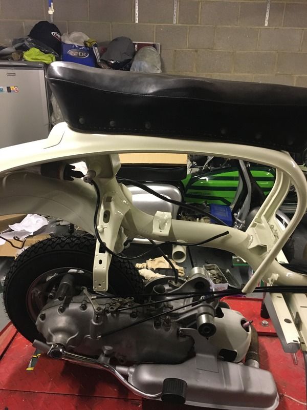

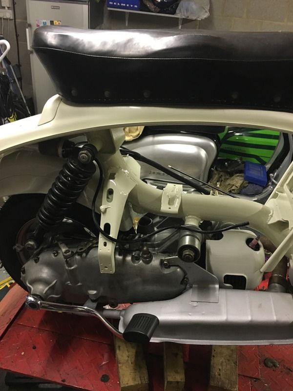

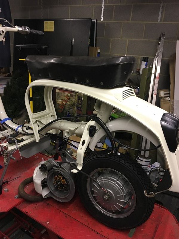

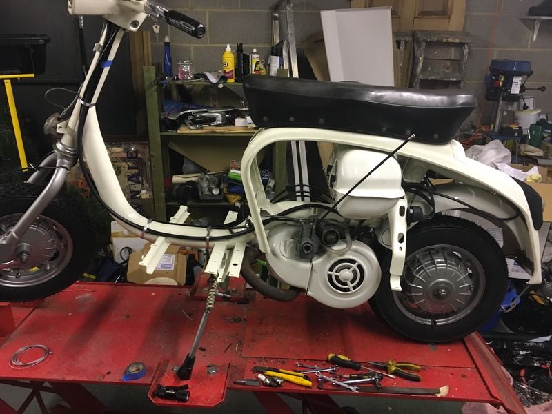

Engine back in
Started ok
Getting there now , ready for leggings
Imagej
Just got to get the gaps rights
Beware lambrettas !!! They can bite

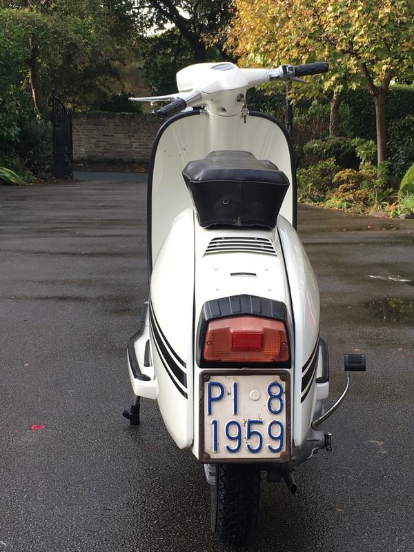

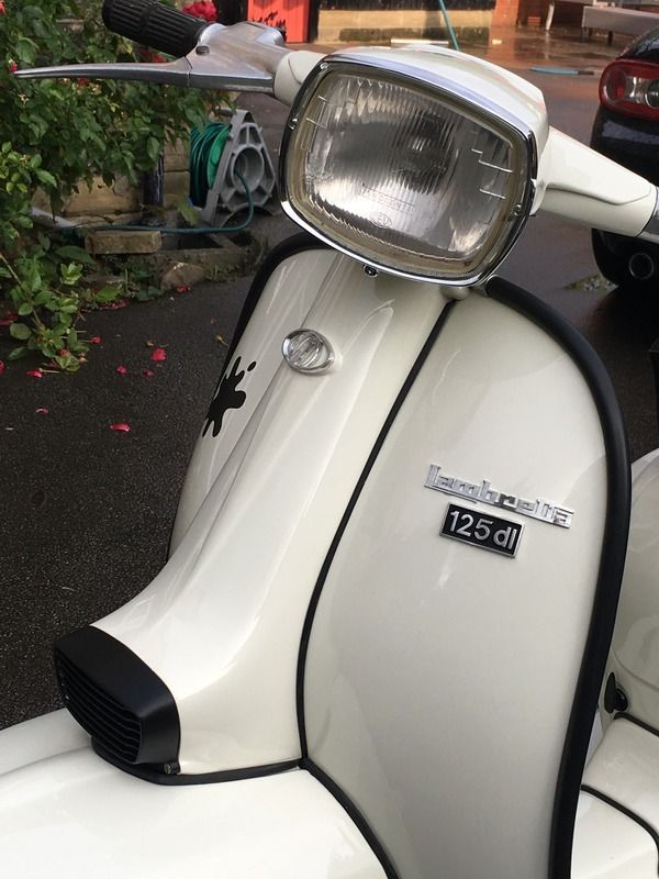

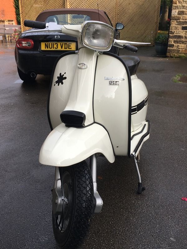

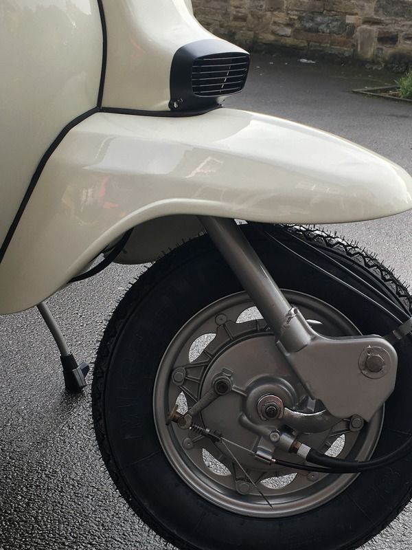

Finished scooter, mot today, just to register now

Postby Covboy » Thu Nov 17, 2016 6:58 pm
Lovely job.... I want another GP I regret selling mine now
Like the old Italian plate too....Pisa???

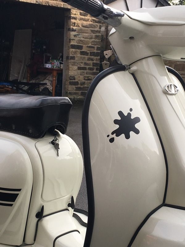

That is lovely! ;)
Scrolling through the rebuild photos in order, I initially had reservations about the colour (says me with a Peach/Grey SX....!) but @ the end, it all makes sense.
Pity you'll lose that trade plate & I would agonise whether to go reflective plates or not....
One trick you missed though! The Ink Splat should've been red to match your head wound :lol:

Postby Stevepshipley » Thu Nov 17, 2016 7:04 pm
Yes it's a Pisa plate,

Re: My GP 125
Postby Stevepshipley » Fri Nov 18, 2016 6:47 pm
Hi, it is carter aluminium lechler 8081. I got that from lambretta paints and gave it to Jason so I assume he used that. I also got half a litre thorn white lechler 8082 from them too, which I gave to Jason as a sample of the colour from tessera's restoration guide. I doubt that was enough so I don't know where he sourced the white from.
Stevepshipley
Posts: 247
Re: My GP 125
Postby eddie15b » Fri Nov 18, 2016 7:14 pm
thanks for that much appreciated ill use that spec in my next restoration
