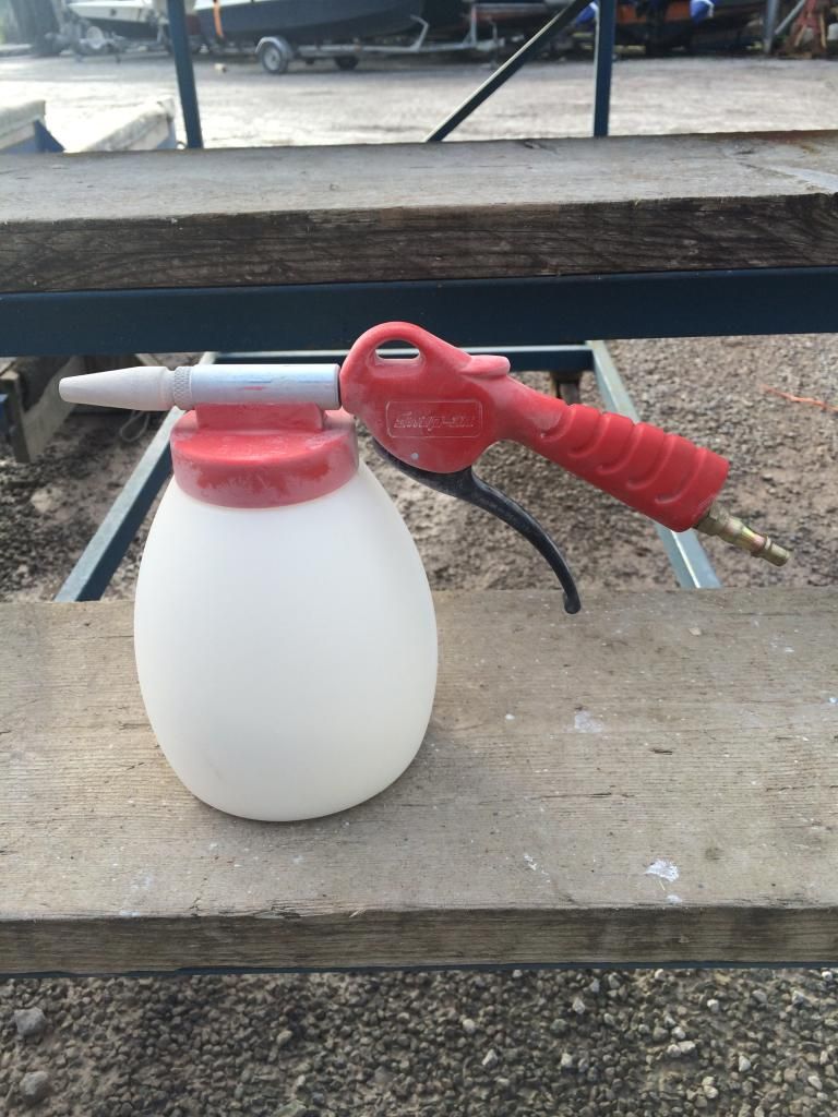

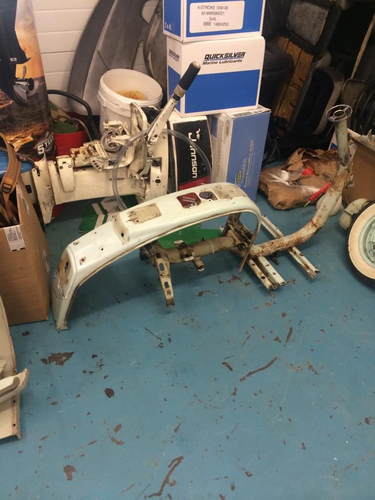

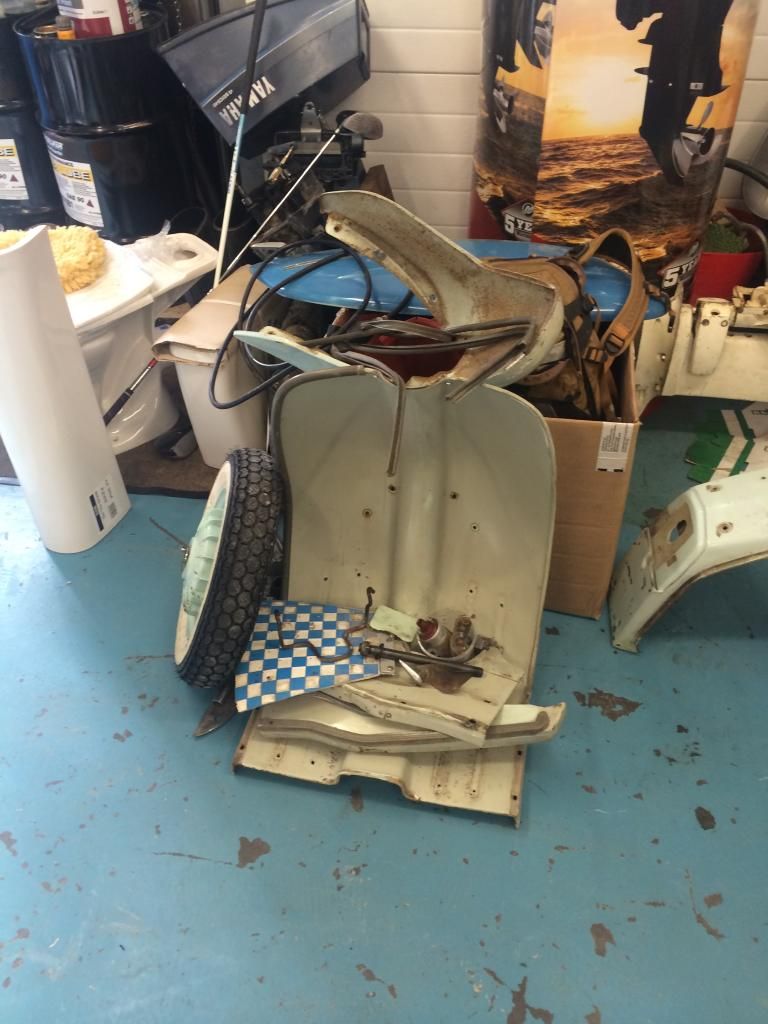

Well,I made a start this week.Hope it doesn't take too long.
Bought this in the summer off Snap on,does a really good lob.
Engine strip down next week,cant wait.

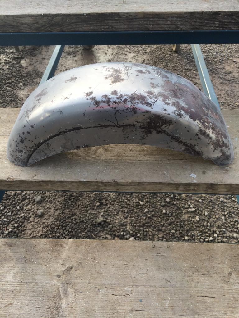

Whoops,this one went missing.

Stripping paint, possibly the most tedious stage. What equipment are you using?
Posts: 2719
Re: Daves Li resto
Postby dave411 » Sun Nov 30, 2014 6:35 pm
The soda blasting pot I posted.

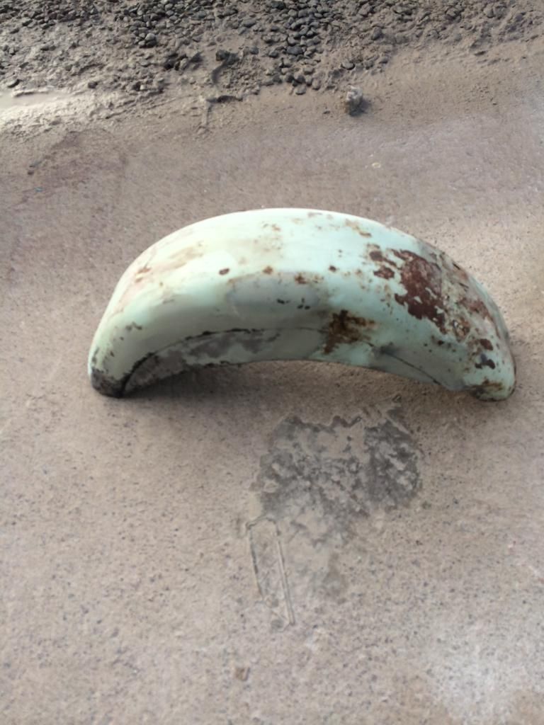

Postby dave411 » Mon Dec 08, 2014 1:55 pm
Got this back today,well happy. :P

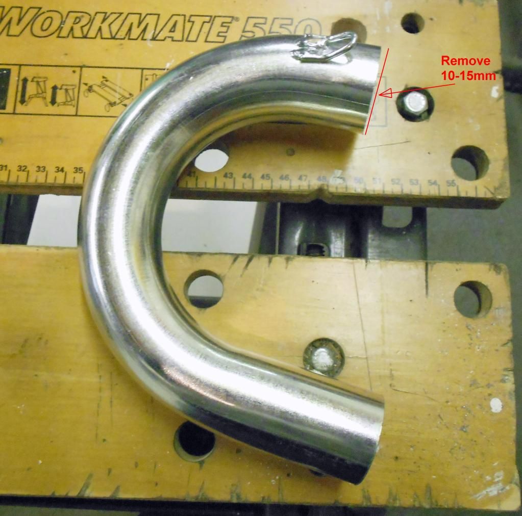

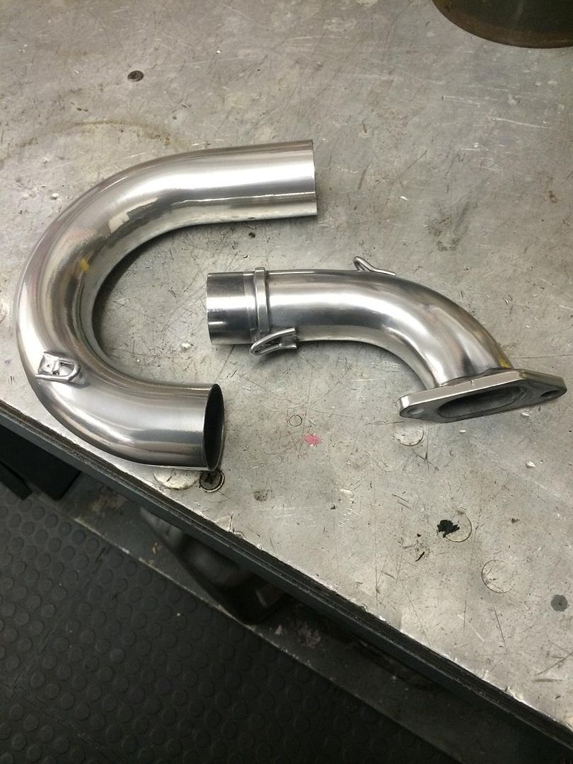

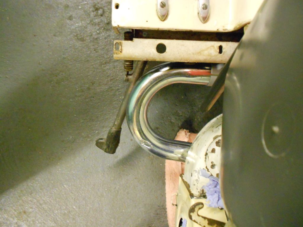

If your Ancillotti exhaust is anything like the one I bought, then it lined up and fitted easily with no adjustment needed.
That is until I went to take to retract the stand...
It required this mod to one of the two U bend sections:

That's what I am hoping for Chadley.

Just re read your post Chadley,i hope mine doesnt do that.

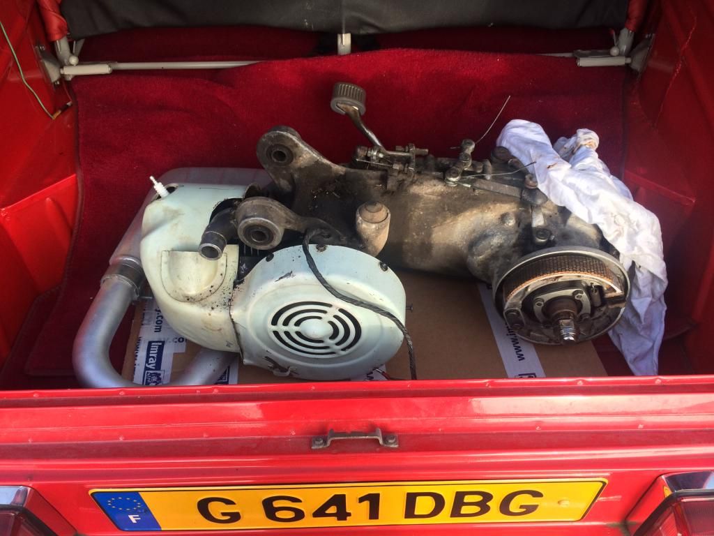

Started to strip the engine today.Everything came apart easily.Couldnt get the gearbox out cause I didnt have the right socket for the nut holding the clutch basket.The rest just flew apart,and it looks like it hadnt been apart for a long time.
Mind you,I have to get the engine mounts out,so no doubt that will be a struggle.Any tips?
