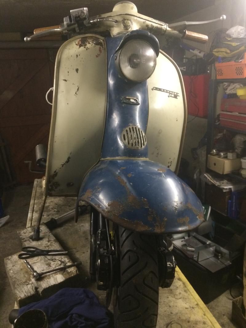

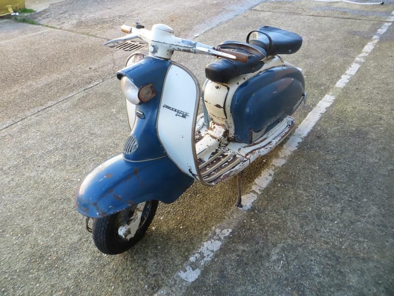

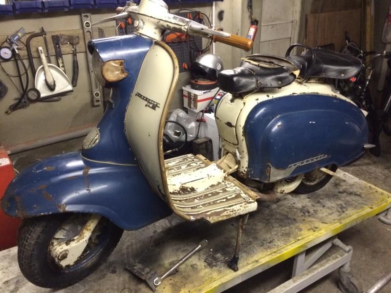

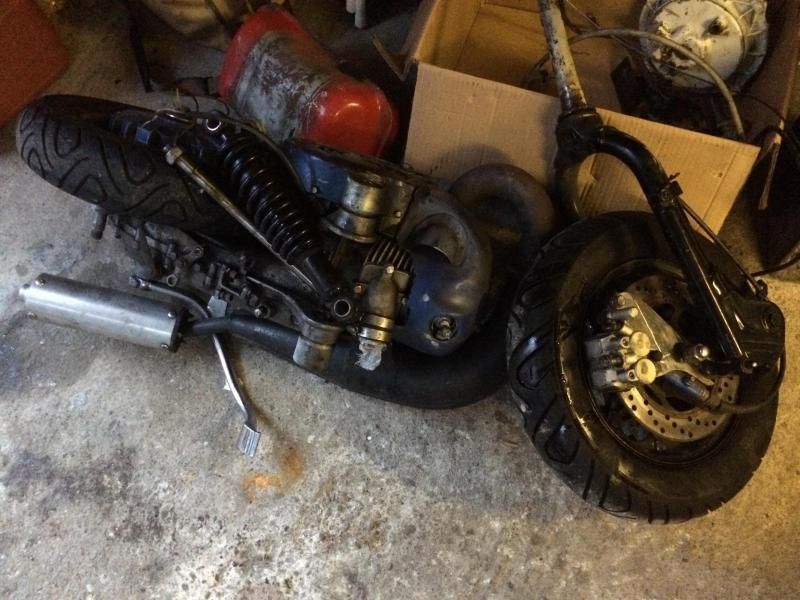

Time for a catch-up on the scoot front. Continuing on from my previous thread about the belgian Series 2.
Well I pilferred the bits and sold it on with the old series 1 engine and forks fitted.

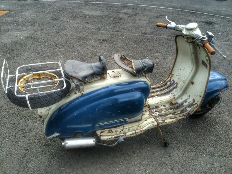

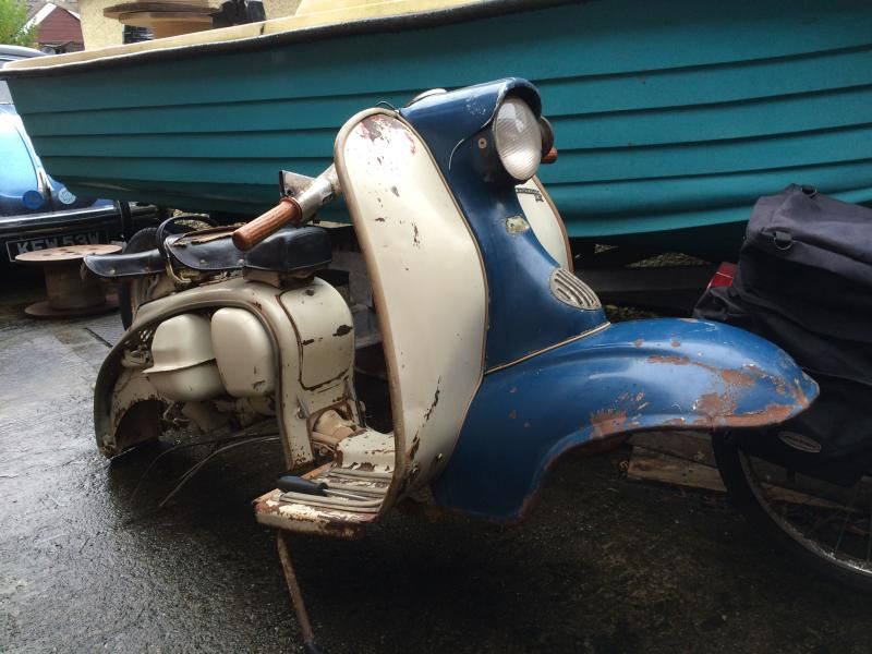

Here`s the Series 1 who will be called Culo Grasso :)
So last week my mate Studs was in England and brought back a few scoots, one of which was mine...happy chappy indeed  ;D
Got stuck in...

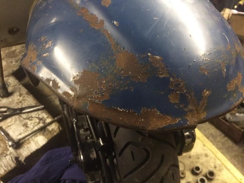

Loom ordered, teflon cables, LED rear light, rear rack, ACF-50 to seal in the rusty paint.
Also got a seat but now inclined to keep the old saddles.

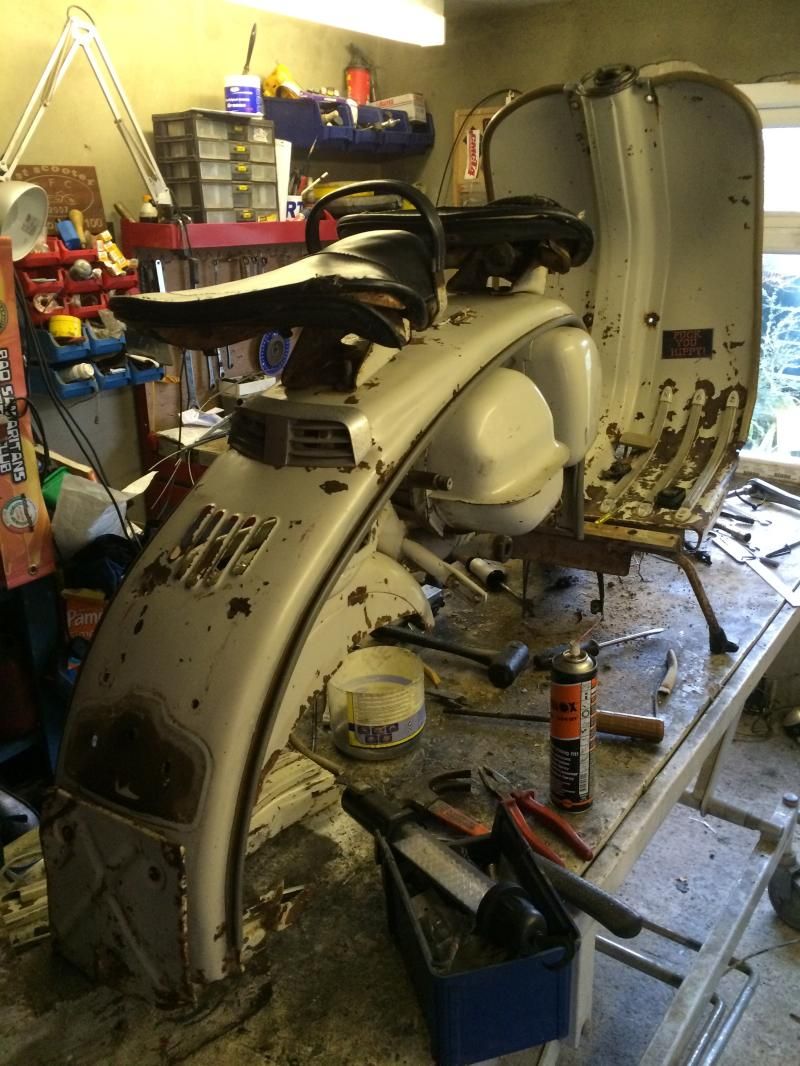

So got the engine and front end in at the weekend. Just need to fit the cables and loom, fit CDI and regulator and hook it all up.
Put it back together and cross my fingers.
Then register it and hit the road, more updates this weekend when hopefully it`ll be up and running :)

I really like this. I can testify that ACF50 will work really well on that, particularly on the sparsely paint covered leggies. How it works, I have no idea but it does.

Yep the ACF stuff seems to be the best thing for the job, head fekked today after our work do last night so early start in the morning and hopefully a bit of progress to report.

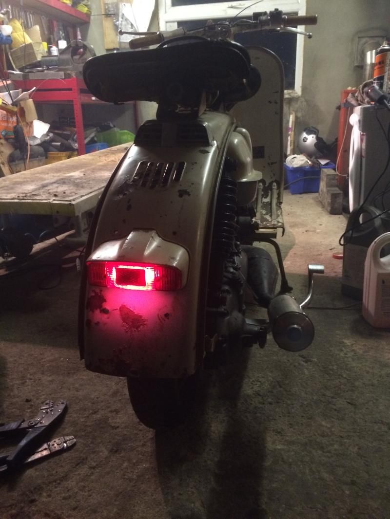

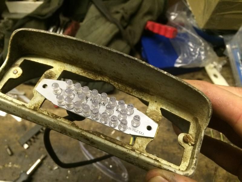

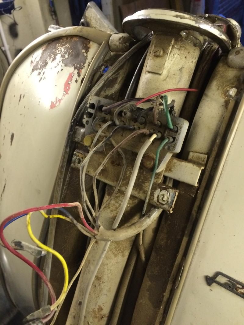

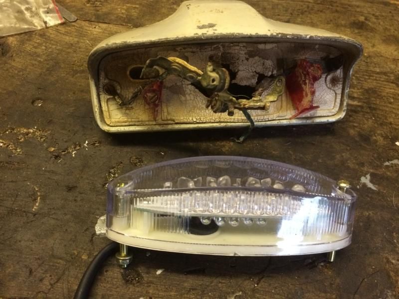

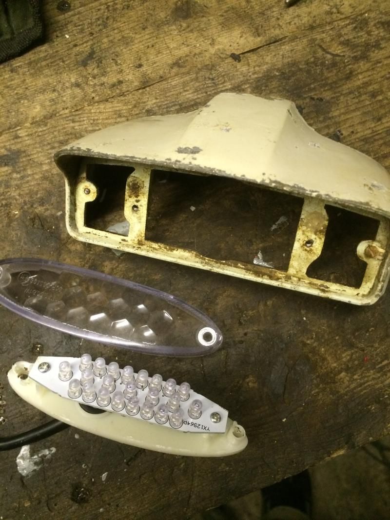

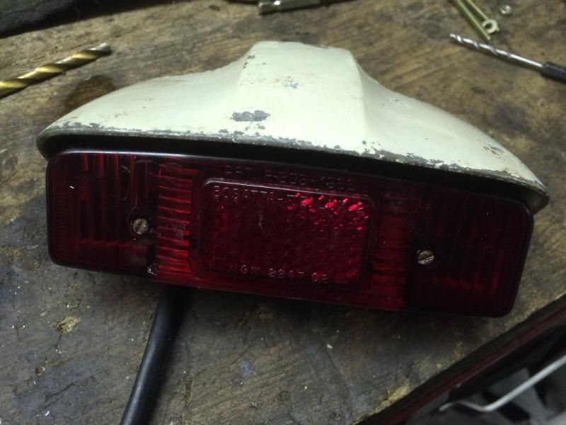

Fancied an LED tail-light so decided to make my own from a £5 universal bike one off ebay. These seem to have a lot more elements than the ones sold for the purpose.
The original light being past it`s sell-by date :?
Took it apart and as luck would have it the two holes lined up with the lense screw holes nearly perfectly :D
It remains to be seen whether it works or not.

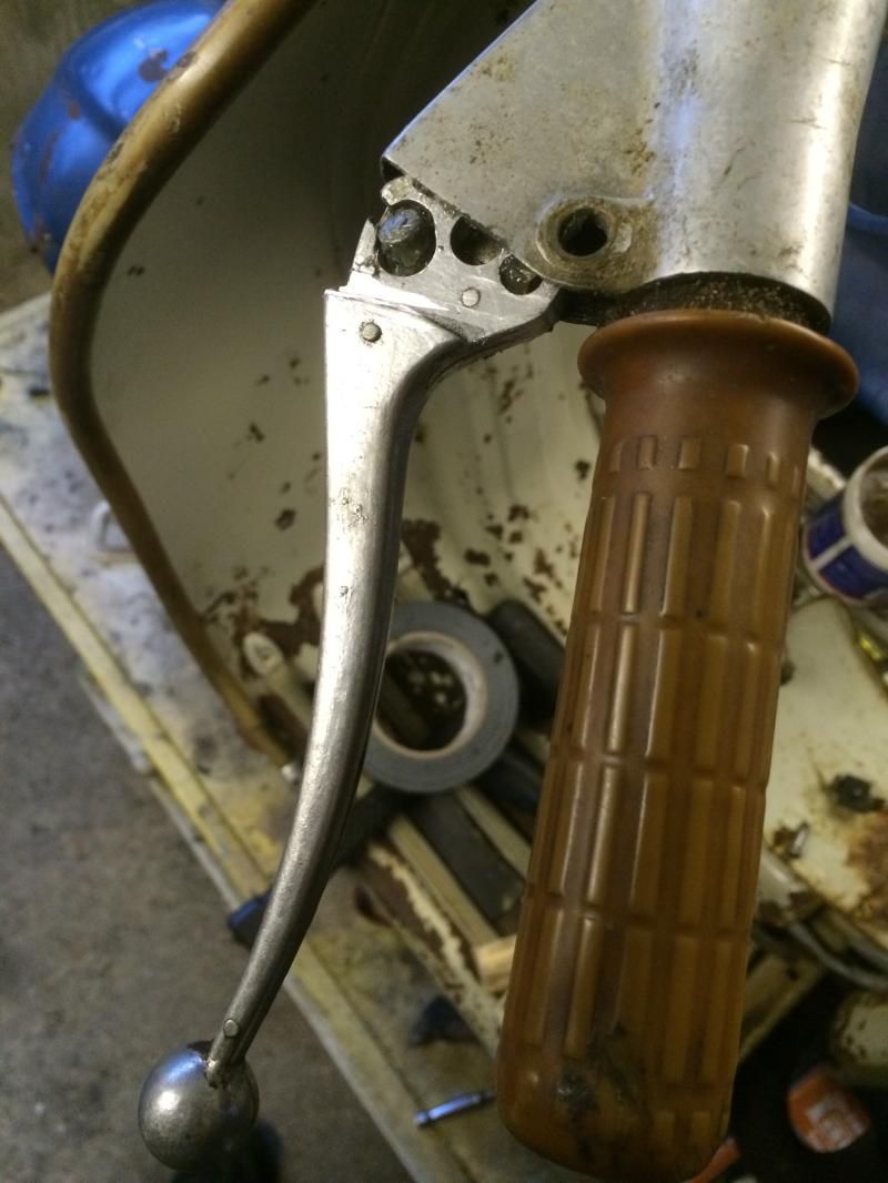

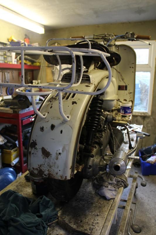

Also discovered that I`d given away too many levers with the Series 2 so had to McGuyver a new lever out of a Series 3 one. It has a ball end so should match the hydraulic one nicely.
Got the engine cabled up and the long throttle cable fitted for the 30mm so a few more steps down the road. Waiting on a new brake switch and lightswitch to get the wiring done now.
My new rack arrived in the post over the holidays too so will fit that when I`ve finished the tail-light..

Good idea with the light, interesting to see how it works ;)

Postby Bofs » Sat Jan 03, 2015 8:56 pm
Got the electrics and lights sorted today, except for the horn, dead as a doughnut :?
LED tail-light works sweet after faffing around with the odd coloured wiring.

Wow. i am well impressed with the light, had my doubts but hats of to you.

Postby Marty ULC » Mon Jan 12, 2015 2:29 pm
Thanks for the inspiration Bofs. Fitted one of those led units into my SIL plastic GP unit with self-tappers and it seems to work a treat. 8-)

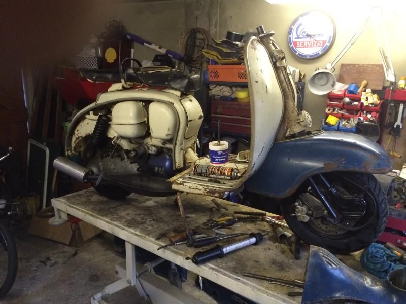

Got back in the shed again to day for a few hours and fitted the new kill-switch and a new 12v horn, all working after a bit of faffing about.

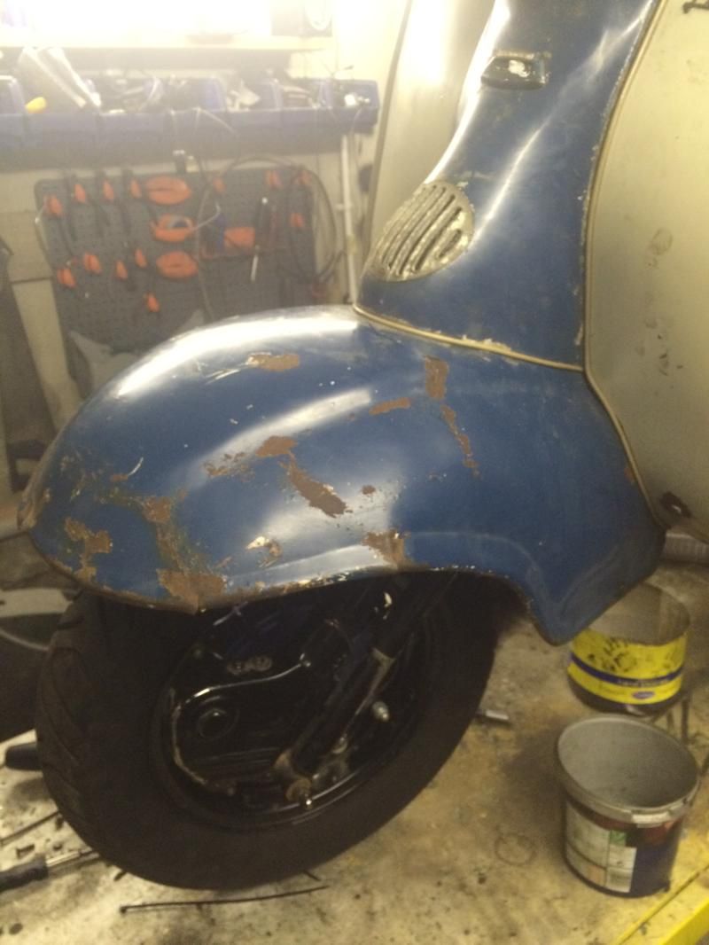

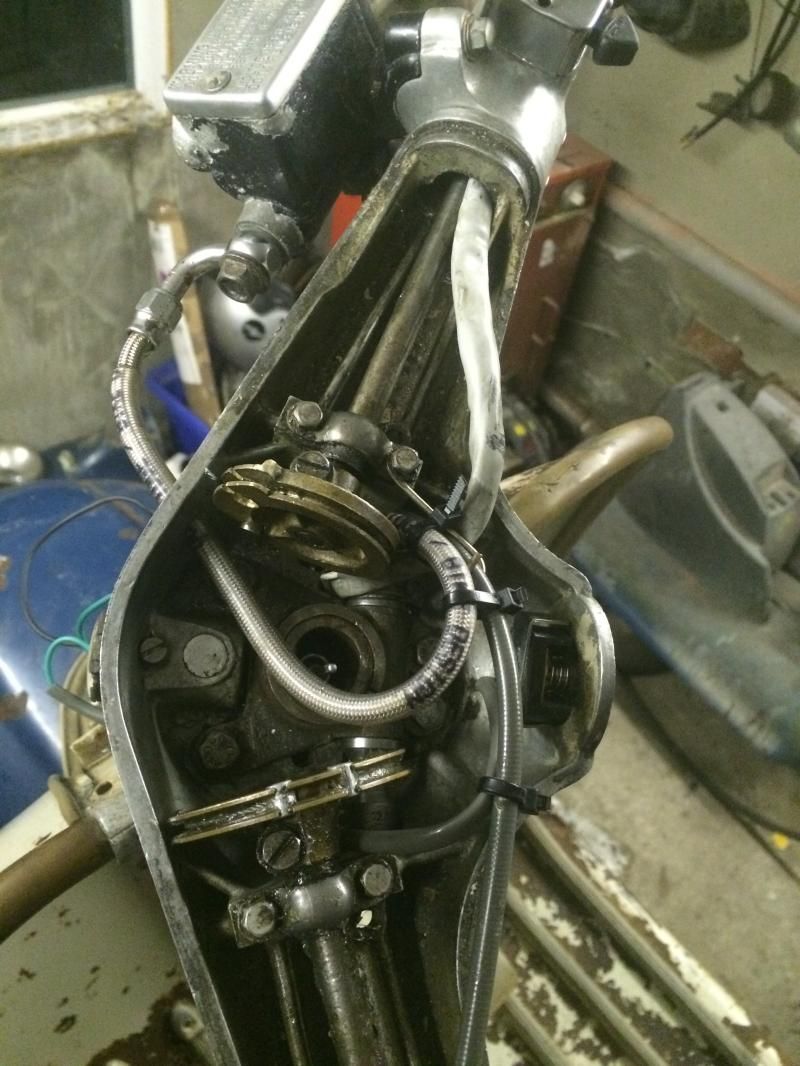

Here`s a pic of the hydraulic hose routing which was a PITA to route and sort, not 100% happy with it but will suck it and see.
Also picked up new keys for my original locks through Jem Booth, well chuffed to say the least :D
Got the front end all refitted and headset top so getting nearer the finish line. The speedo cable in the forks is a bloody Indian fitting one so another on order now to fit the Italian speedo :(
A few odds n ends to do now.Bleed the front brake, fit rear runners and bridge piece. There a a lot of splits in the front mudguard which I will weld up and then bend it back into shape.

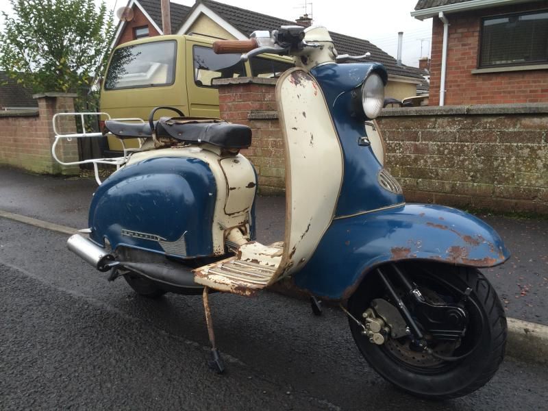

Postby Bofs » Sun Jan 25, 2015 4:17 pm

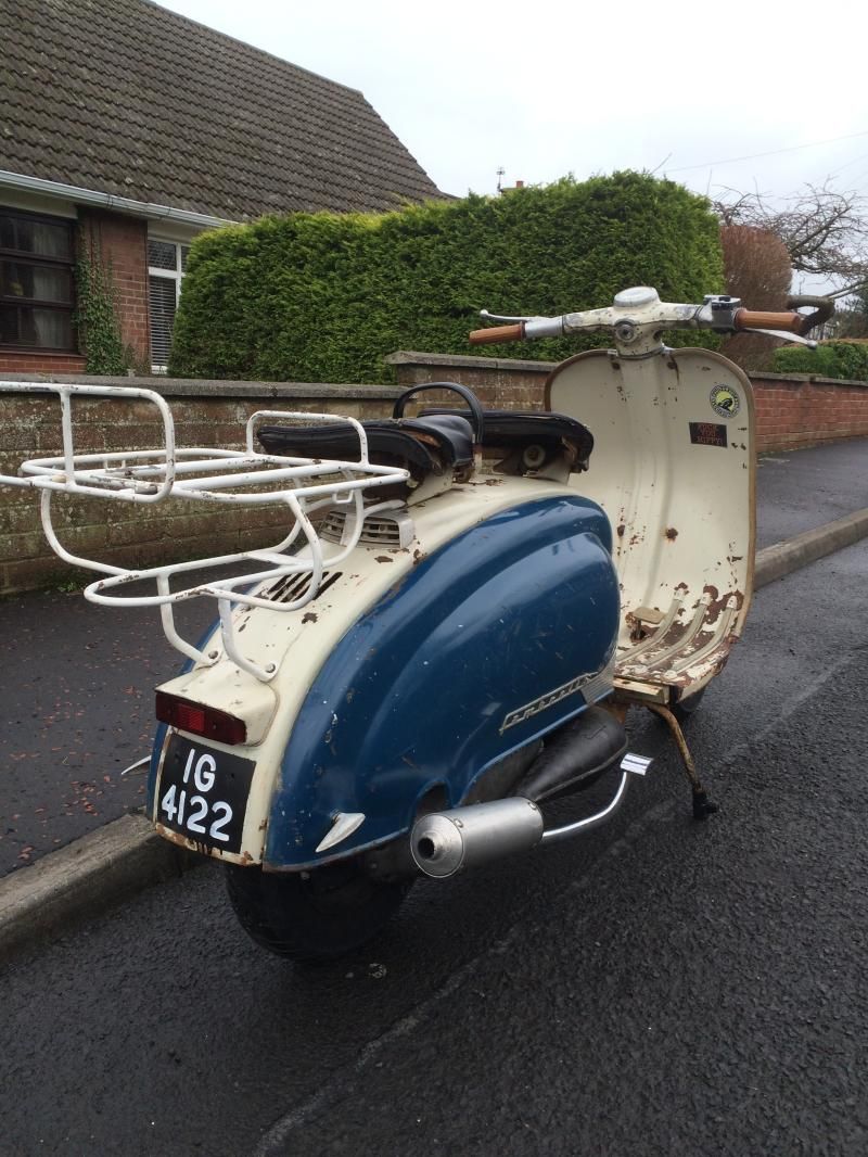

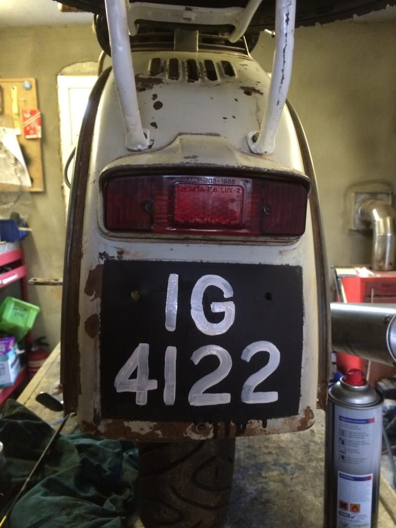

Couldn`t wait any longer, got enough done to make it roadworthy. Painted on the number plate, brakes done, final check on the nuts and bolts and away we go.

Like that 8-) Love the hand painted number plate :D Quality G.

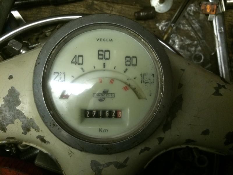

Hi Bofs, have you got a pic of the Italian speedo? Was it/will it working? Mine on 1960 series 2 is f'ed, took it out and the bits inside are f'ed. I might contact Jem Booth about options

Nice job Bofs 8-) like it a lot.

MJD wrote:Hi Bofs, have you got a pic of the Italian speedo? Was it/will it working? Mine on 1960 series 2 is f'ed, took it out and the bits inside are f'ed. I might contact Jem Booth about options
It should work ok, just waiting on the right size italian cable after an ebay plonk sent me an Indian one :cry: Jem`s your man for the speedo.

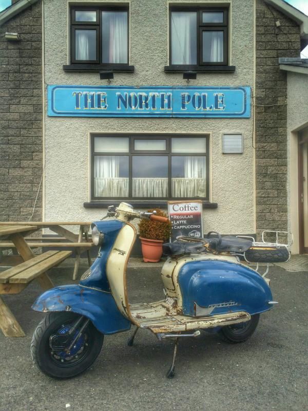

Postby Bofs » Sun Feb 15, 2015 1:02 pm

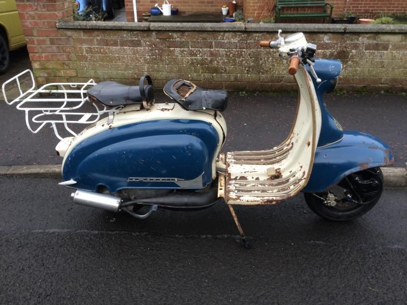

A wee spin northwards yesterday for another shakedown, all the way to the North Pole.
Put on the Pirelli Superbiker Diablo app on the phone on the way back and hit a genuine top speed of 70mph GPS on one stretch.
Sadly the saddle seats have to go, ok for nipping around town but crap for distance.
Bofs
