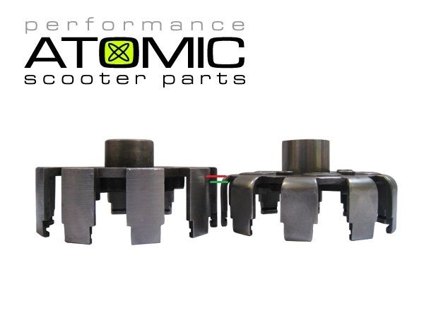

Knowledge wrote:I just found this picture of the spider, taken from the ScootRS website. http://scootrs.com/category.cfm?category=7
It looks like the total height of the new spider is the same as the original Innocenti item, so this should not be an issue. Shortly, I will have one of my own, so I can take some measurements to confirm this.
Martin
the hight isnt the same Martin mate?
the Atomic is again 3mm? deeper fella, see below

Norrie Bodge wrote:the hight isnt the same Martin mate?
That wasn't the dimension I was thinking of, Norrie. Frankly, I'd be disappointed if they were the same dimension in the area you have illustrated.
No, I'm thinking that total height looks the same. The area you highlight is compensated by a recess which is visible in other photos on the Scoot RS website.

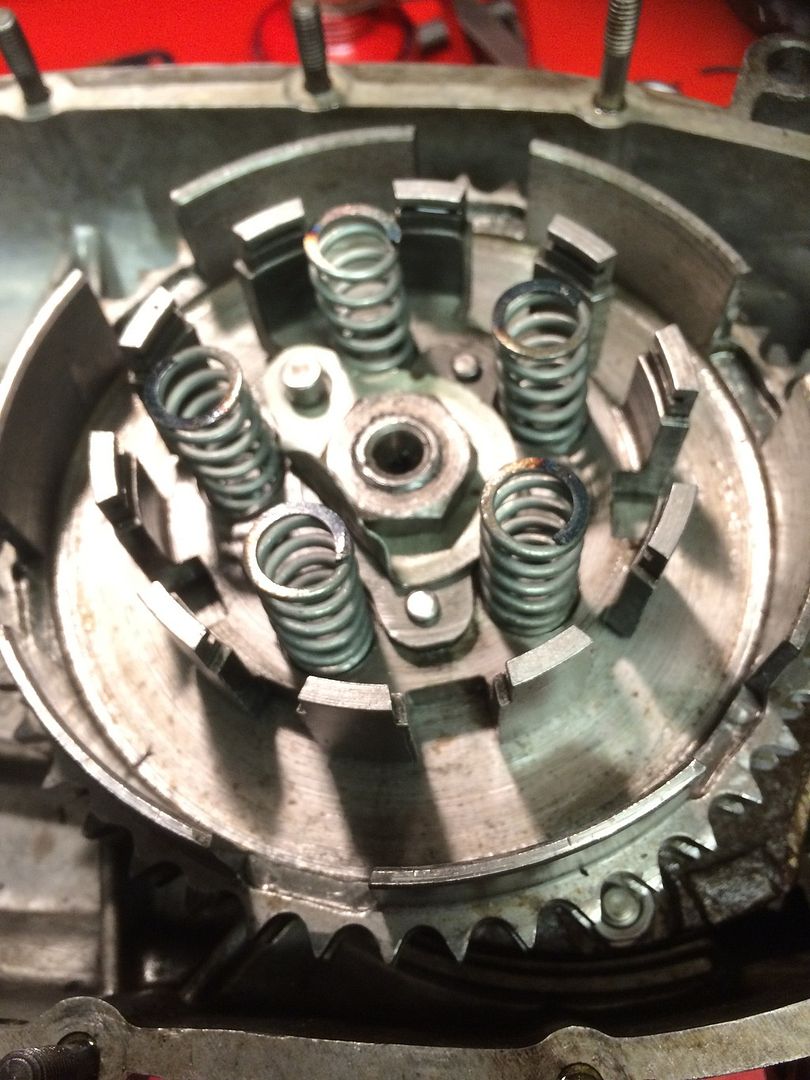

I believe my issues are with the depth of the pressure plate?
As last year when I 1st posted this issue on my GP?
I ended up fitting a std pressure plate using the deep Atomic spider & a 5plate reedspeed clutch kit
& it works great !!
I'm back now trying to fit the same but with the deeper Atomic pressure plate as in post #
& this time With a crown wheel Notched for the 1st cork plate.
Just emailed scoot-RS to see what advise they give to use them together?
Norrie Bodge
Posts: 566
Re: Clutch - deep rear sprockets
Postby Norrie Bodge » Sat Feb 20, 2016 8:43 am
Norrie Bodge wrote:its a Readspeed 5plate clutch kit & all plates thickness including top plate = 19mm
heres the Atomic on the left compared to std pressure plate
& it works great !!
I'm back now trying to fit the same but with the deeper Atomic pressure plate as in this quoted post .
& this time With a crown wheel Notched for the 1st cork plate. But it protrudes as before (see piccy)
I've then fitted 5 std plates & steels & It fits (see piccy) but I thinks my springs are then too compressed for the clutch to operate?

Postby Wack » Sat Feb 20, 2016 10:01 am
Just out of interest, if you fitted an extra steel onto the pressure plate before fitting the rest of the plates, does it lower the pressure plate and still allow clearance when compressed?

Wack wrote:Just out of interest, if you fitted an extra steel onto the pressure plate before fitting the rest of the plates, does it lower the pressure plate and still allow clearance when compressed?
Cheers for replying but I haven't m8
steel on steel is a no-no in the clutch I thinks tho ?
Ru thinking to fill it out?
The Taffspeed springs I have compress to 16mm
