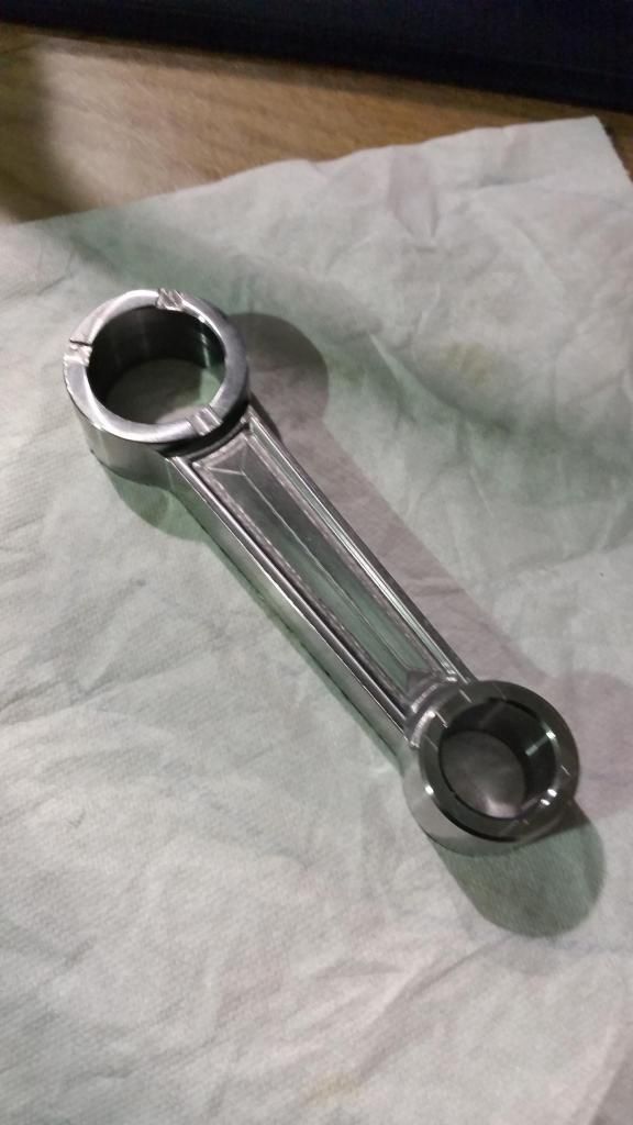

It came in a con rod kit I was going to put in my S2 crank which was siezed but being cheap the quality is @@@@, get what ya pay for so just bought a decent GP crank and con rod.
Gonna make me own con rod just to see what it turns out like and pick up another GP crank with big end gone to build up for my Special
made a start Image

That conrod looks a bit thick,make sure it fits between the webs of a GP crank.

Yes it is thick because this is only half of the profile cut off on the saw. I have made a jig to sit this in to finish the other side down to thickness.
I used the conrod I got in the kit as a sample but not sure if this was a good example so might borrow a better quality one to copy. I know it seems a waste of time and I'm only doing it because I can not because I need to.
