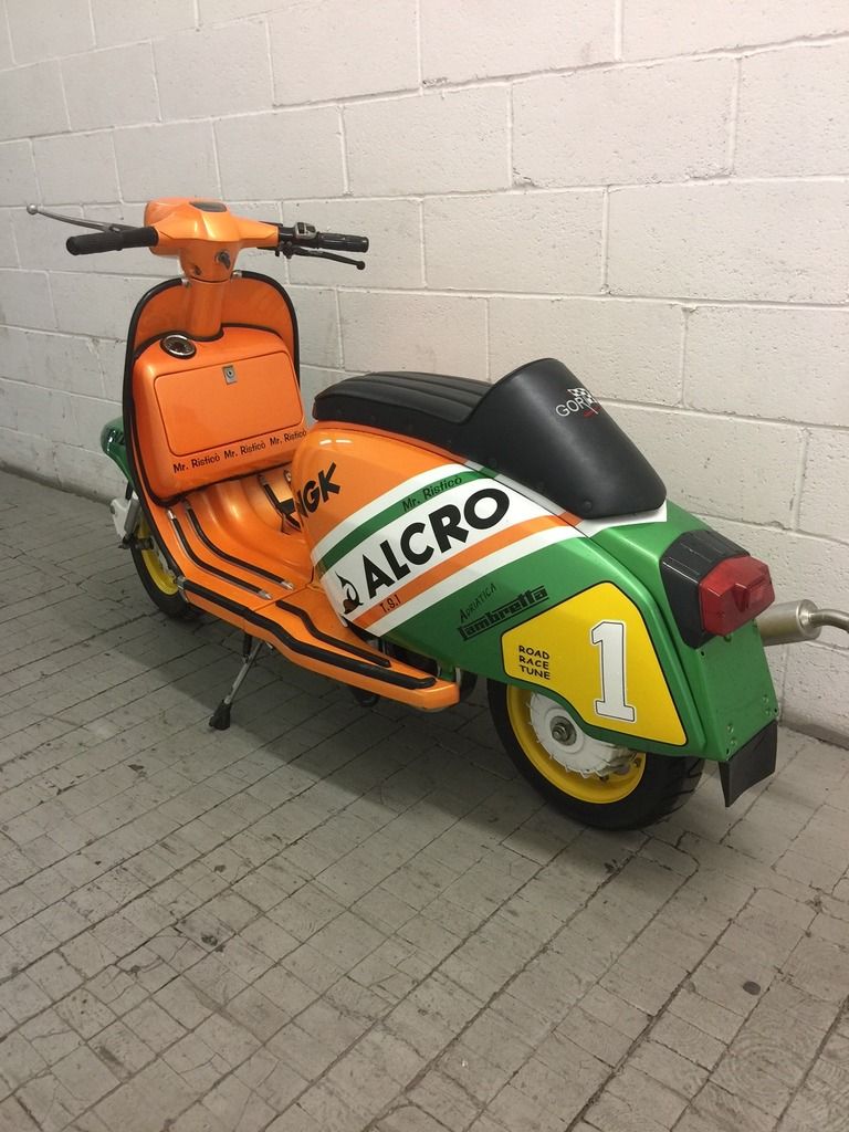

Postby Mr G in NYC » Thu Feb 09, 2017 8:13 pm
Jolly Moto 8-)
Stuck it on this TS1 and it totally changed the way this scooter rides :D
