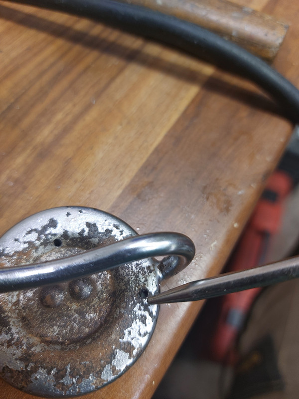

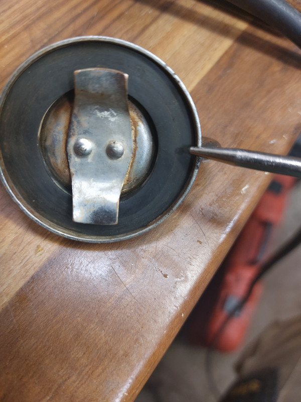

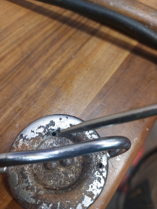

Rich Oswald wrote:No teaching you to suck eggs Dickie, but did you look under the fuel cap handle, in the centre, for the breather hole? Sorry if that is obvious.
I take no advice as insulting; nobody knows everything even if they think they do. But yes, I did check and was surprised to see it didn't have one. As I type this, I'm wondering what even made me look in the first place!
What prompted me to ask this was, I restored S1 quite a few years ago now and it would only run for a few minutes before cutting out. Found out that it was the original fuel cap with no breather hole. A new cap cured it.
I started this last week as I'm determined to take it to Ripon. Satrted after 4 or 5 kicks, so I was dead happy in the way you always are when a new build starts. I strobed the timing and each time I did, it was harder to start until it wouldn't start at all. A lot of head scratching, swearing etc followed by a few pints and bed. Always best to walk away when you're getting nowhere.
Then I remembered this fuel cap discussion. Went into the garage in the morning, undid the fuel cap and heard a whoosh as it sucked air into the tank. The rubber is being squashed onto the breather hole that I drilled; try agian.

Postby coaster » Mon Jul 14, 2025 1:31 pm
I had a severely corroded Diablo tank (bought 2nd hand off here I think) which I filled with caustic soda and left over night to get rid of 2 stroke oil residue. Then I flushed it and filled with brick cleaner and left overnight. When completely dry I treated it to an application of POR15 and its been fine ever since 8-)
Re: Series 2 survivor
Postby dickie » Wed Jul 16, 2025 10:54 am
Running lovely now and starting first kick!
The original breather hole that i drilled
You can see it's perfectly in line with where the seal contacts the fuel tank neck.
So I drilled one further in which works fine.
Maybe I should have just bought a new one, but I want as much original as I can.
