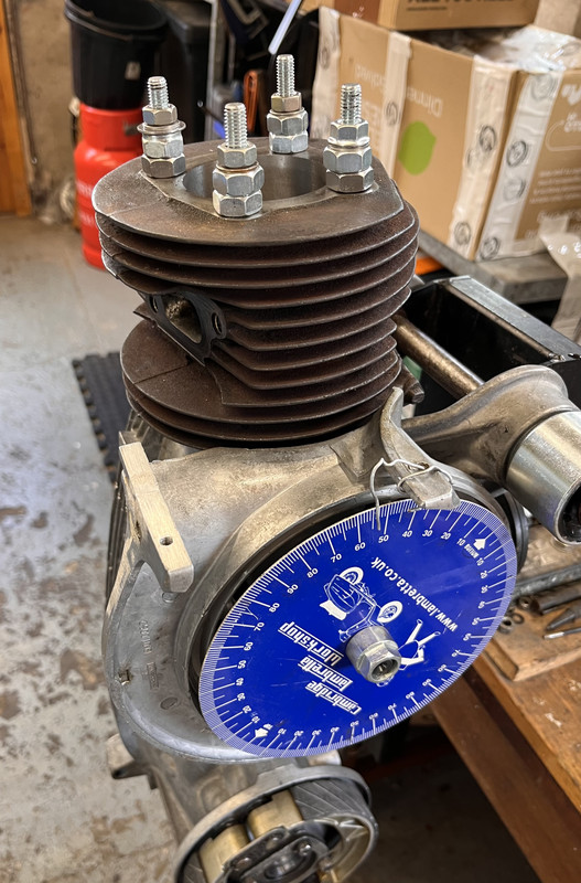

These were done in a bit of a rush so will need rechecking.
With 2mm packer:
Exhaust 153
Transfers 118
Inlet 144
With 3mm (2mm packer and a couple of 0.5mm paper gaskets):
Exhaust 159
Transfers 124
Inlet 140
To my limited knowledge eye, the 3mm packer option seems to offer a very rideable engine but lacking power because of the relatively low exhaust timing. I knew that would be the case when I made the conscious decision to not have the barrel tuned.
Thoughts please?

Thanks again for the reply. I think I am just going through a phase where I crave reliability and the chance of being able to easily strip a top end on the road, if needed. Cast iron barrels, Piston port, Japanese piston with a gudgeon pin that slides in easily, not tuned to the max, that sort of thing.
I checked the timings and, other than getting an inlet timing of 141, as opposed to 140, they were the same. On that basis, I have ordered a 3mm packer.
