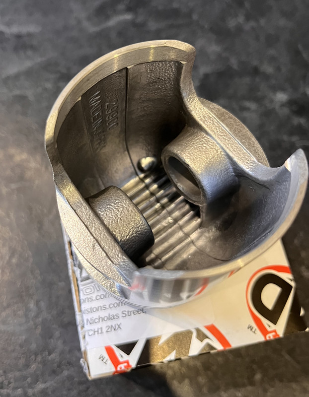

Postby Storkfoot » Tue Jan 07, 2025 6:54 pm
The piston has turned up. Made in Japan by this company:
https://www.tkrj.co.jp/

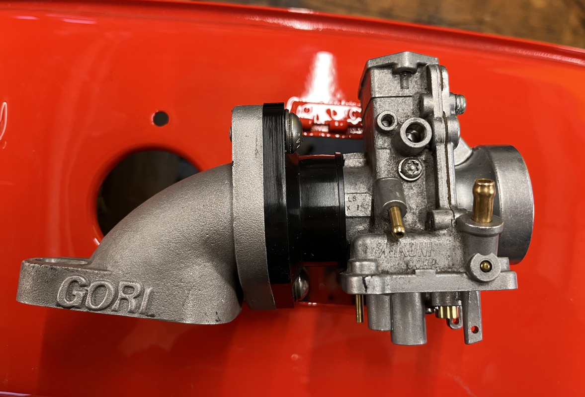

Postby Storkfoot » Tue Mar 25, 2025 10:38 pm
Thinking of trying a Mikuni TM24 on this engine. You can see that I have taken a dremel to the carb to ensure that the usual MB inlet rubbers fit snuggly. Whilst I’d like to use a flange type inlet manifold, I am unsure whether the Gori one here will fit without significant work.
I’ll be able to check when I get the cylinder and head back which should be quite soon.
Re: What to do with this TV175 engine?
Postby Storkfoot » Wed Apr 02, 2025 3:49 pm
Top end is back and I am glad to find that the Gori inlet manifold will fit with a small amount of dressing to keep it away from the 6th fin from the base.
