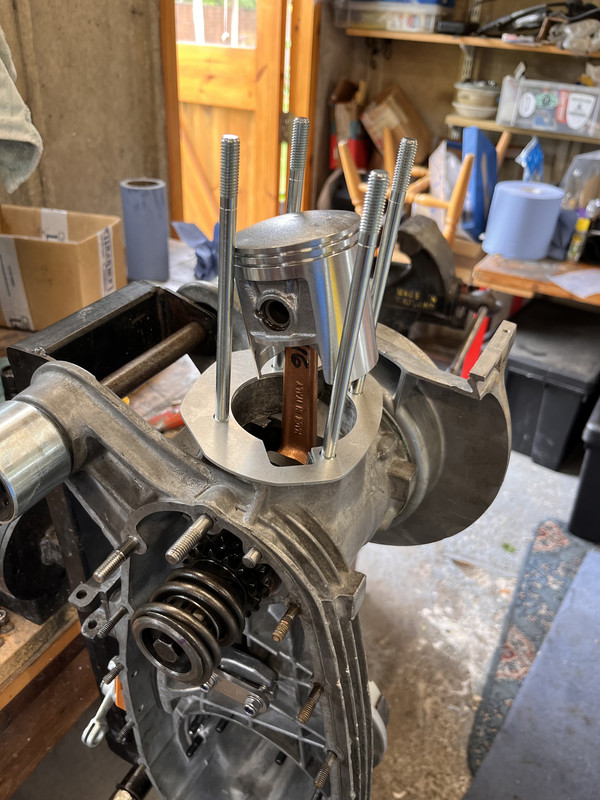

Postby Storkfoot » Thu May 29, 2025 5:48 pm
Building the bottom end has stalled as the layshaft has a small amount of pitting where it engages with the endplate.
This made me have a quick mock up of the top end. This was done quickly and with what I had. A 2mm base packer needed a 0.90 head gasket to get a squish of around 1.2mm.
If anyone has any thoughts on whether, say, a 3mm packer and no head gasket would be better for a steady tourer, feel free to comment :)
Mikuni TM24, MB enlarged air box and filter, 5.0 final drive ratio and either a standard GP200 mushroomless exhaust or, perhaps, AF42 Clubman or MB/bgm Clubman.
Posts: 2522
