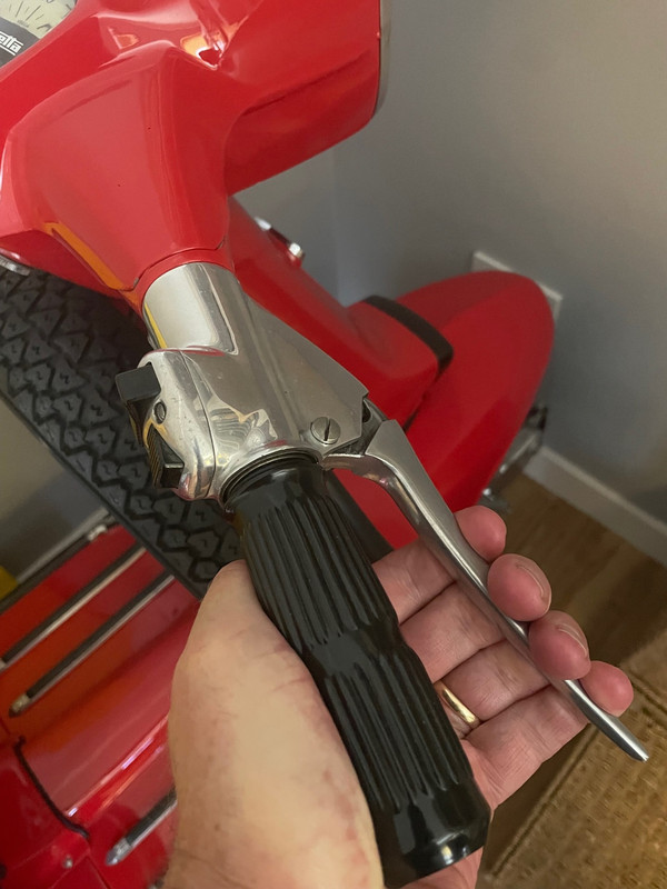

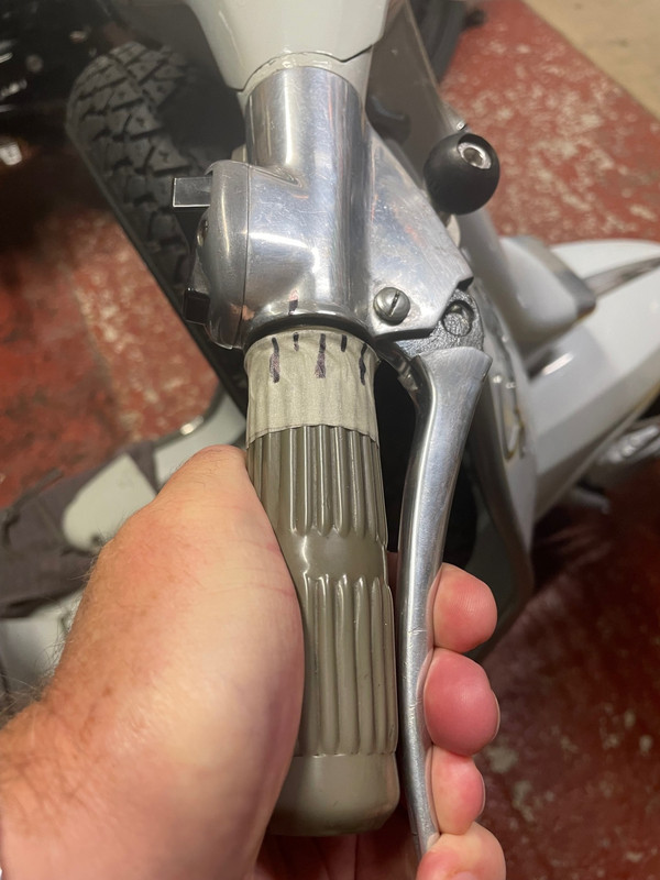

A few years back I bought my GP, which has a standard all original front brake with standard factory cabling routing
The front brake operation is almost as good as hydraulic. Per the image below. That's me pulling the front brake lever as hard as I can
Further below is the same setup (original and genuine brake and actuator) on my SX and I can easily pull the lever to the bars !
The difference that I can easily see is that the SX has a 1.7mm brake cable dia. and the GP has a 2mm dia. brake cable
So rather than reverse pulling my SX (as I would have done), I'm going to fix why it's not as efficient as my SX - starting with a new 2mm dia brake cable
Anyone share the same or differing opinions?
GP with excellent cable front brake - lever pulled back hard (2mm dia cable)
SX with inefficient cable front brake - lever easily pulled to the bars (1.7mm dia cable)

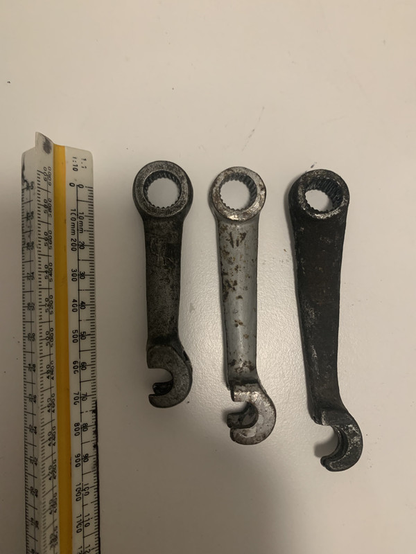

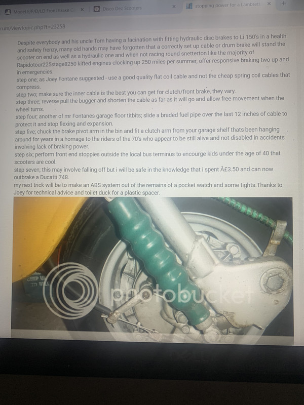

Postby alex_hughes » Sat Sep 14, 2024 4:23 pm
Apologies for a) posting something stolen from another forum many moons ago and b) the quality of the said item, I hope it is readable.
Using clutch lever is an interesting option.
One of the slight drawbacks of following Paul’s link to an earlier thread is a reminder how much time has gone by. And that we are still waiting on the WT1 solution to SIL cases substandard rear brakes
alex_hughes

Postby dickie » Sun Sep 15, 2024 5:36 pm
alex_hughes wrote:Apologies for a) posting something stolen from another forum many moons ago and b) the quality of the said item, I hope it is readable.
I'd forgotten about the clutch lever option. I did try this once and found you have to bend it a little to stop it from hitting the rim. With the longer lever, you can obviously apply more force but this is at the expense of lever travel.
My current front brake uses a Spanish lever which is longer than italian, but shorter than a clutch lever. Good luck finding one though!

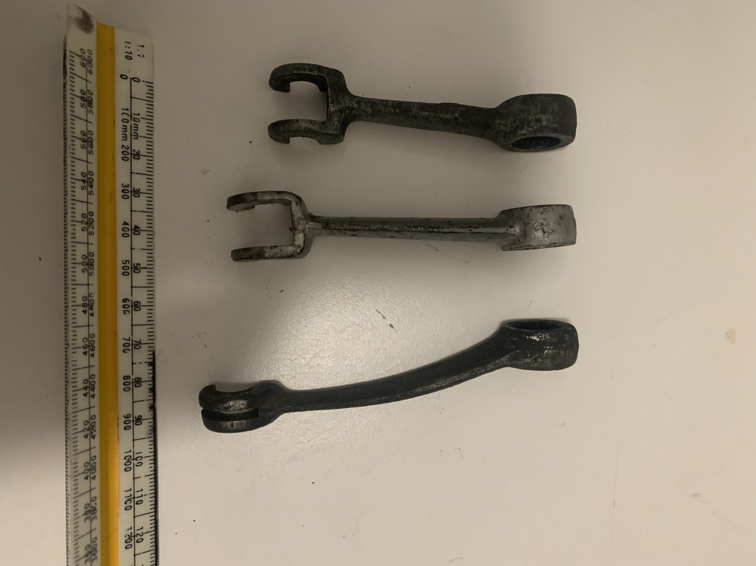

Re: Reverse Pull a Brake or Not!
Postby alex_hughes » Sun Sep 15, 2024 7:41 pm
I hope this isn’t going off topic, Nsaints was referring to a standard disc brake and obviously substituting brake lever for clutch lever is referring to standard drum brakes, which of course can also be reverse pulled.
For reference, a standard Italian lever, a Spanish lever, and a standard clutch lever.
That the clutch lever bends the wrong way is worrying me! And I’m not sure how you’d cable it up, because it’s narrower at the end. I guess there’s a way
Mr B sells shorter clutch levers, same length as Spanish, but also bending the wrong way.
The Spanish lever is going to get a trial on my S1 tomorrow. Didn’t even know I had it!
